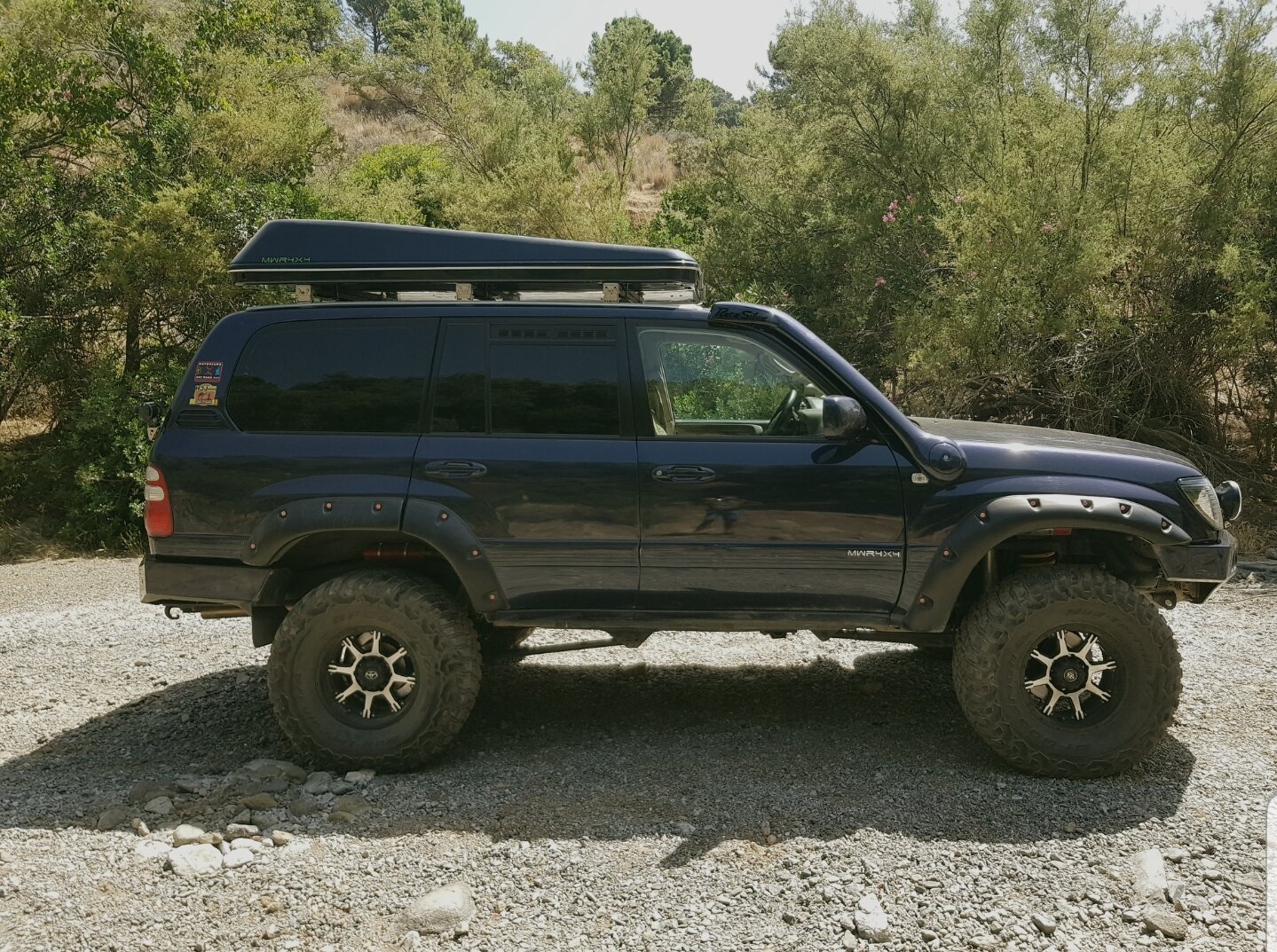

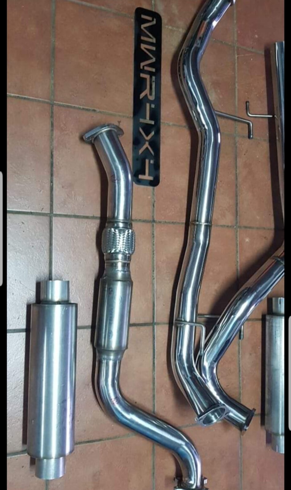

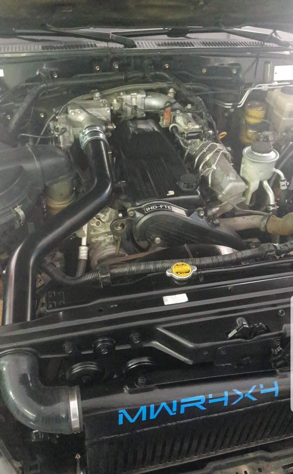

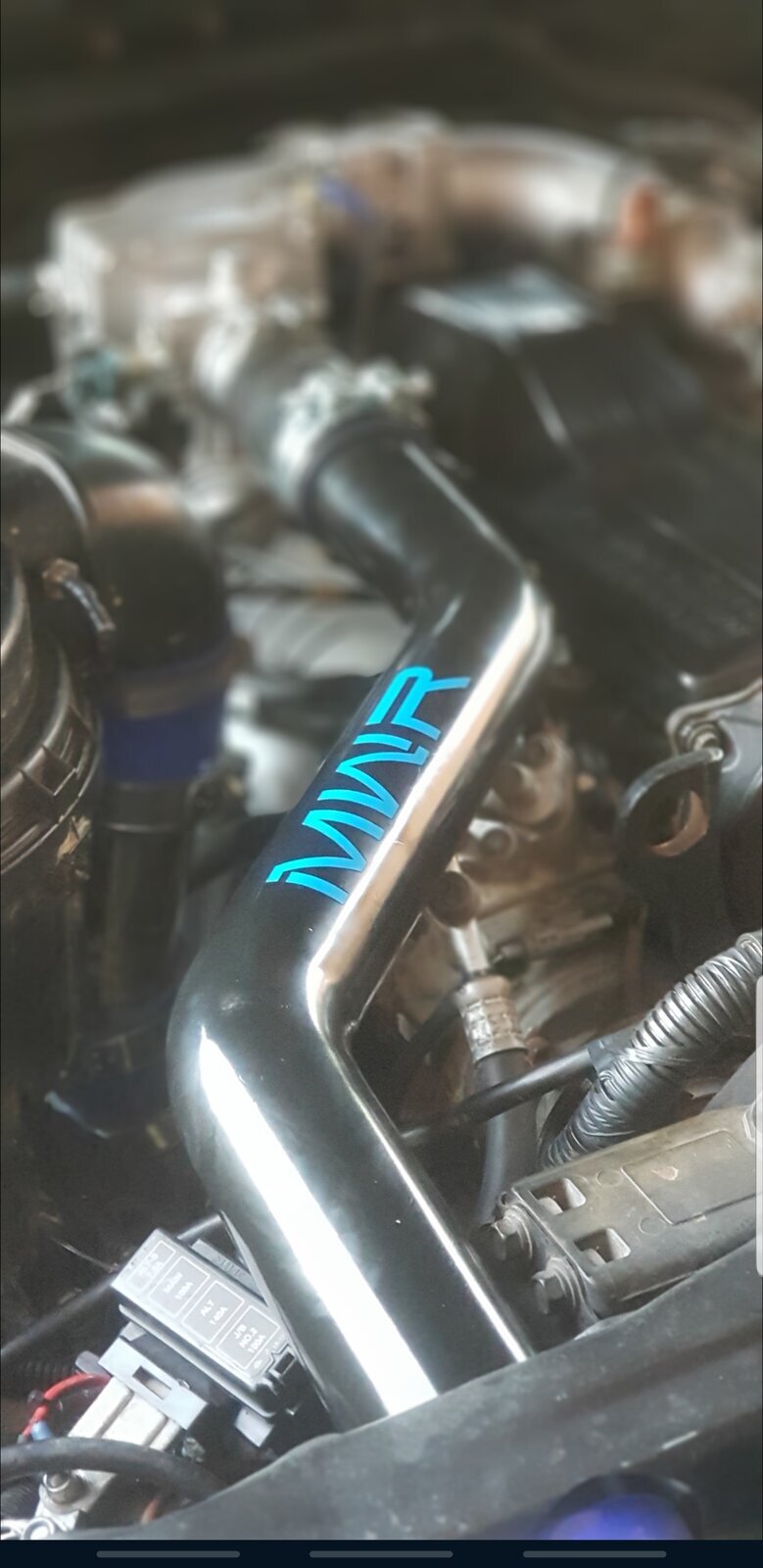

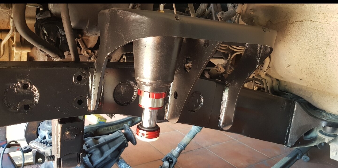

Hi...my name is Manuel..I'm from Spain and here I'm to learn and help you about these incredible cars...mine is a 2001 automatic with a lot of modifications...I powered engine with a ntddmrw chip with fcd and hybrid vnt from 2005 lc100...working with no electronics and with ome vacuum actuator.
Also a xxl intercooler with direct 64 mm aluminium pipes to manifold.
650 newton meter and 283 hp.

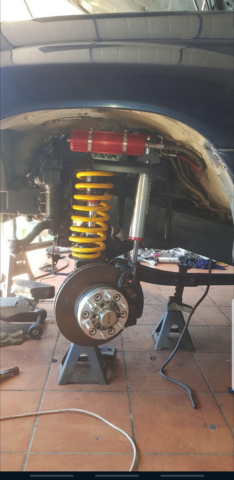

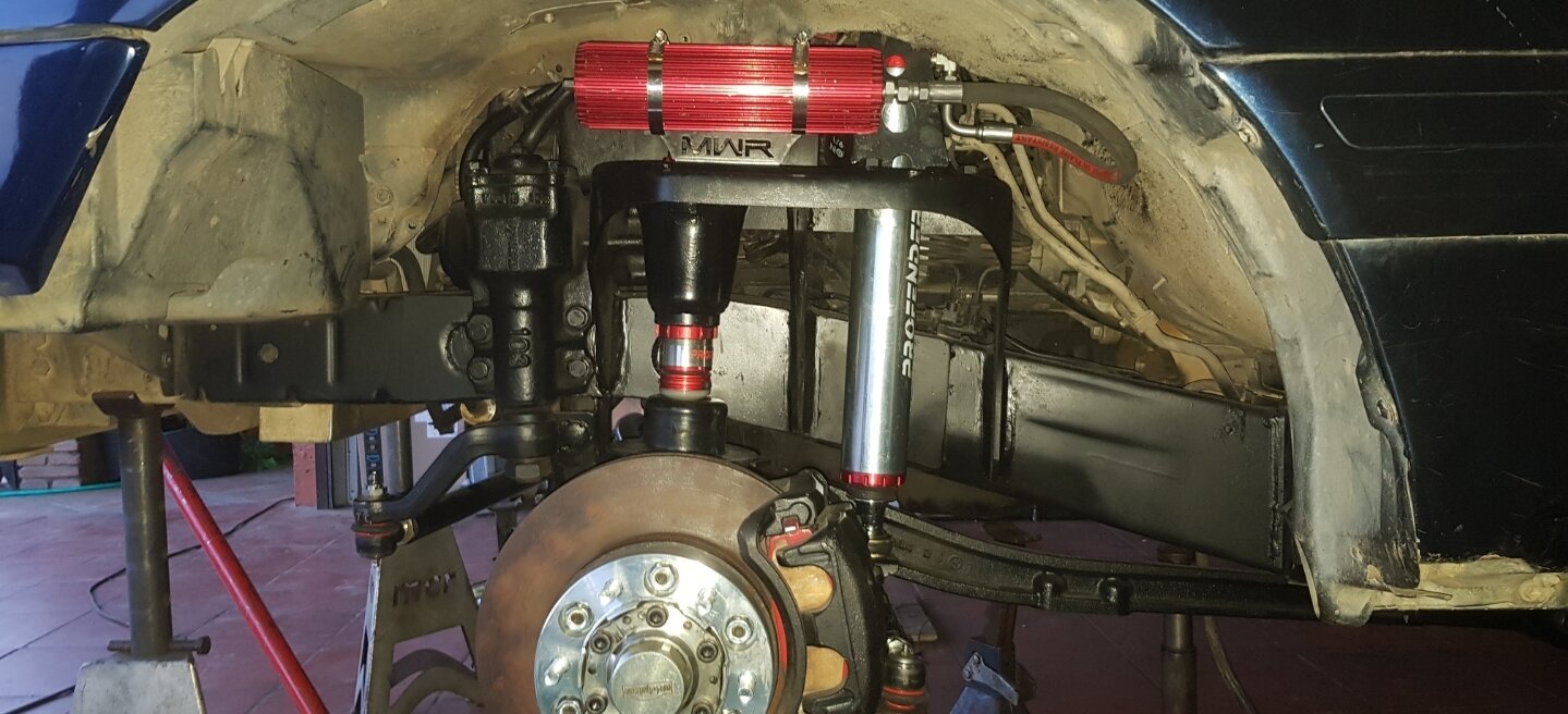

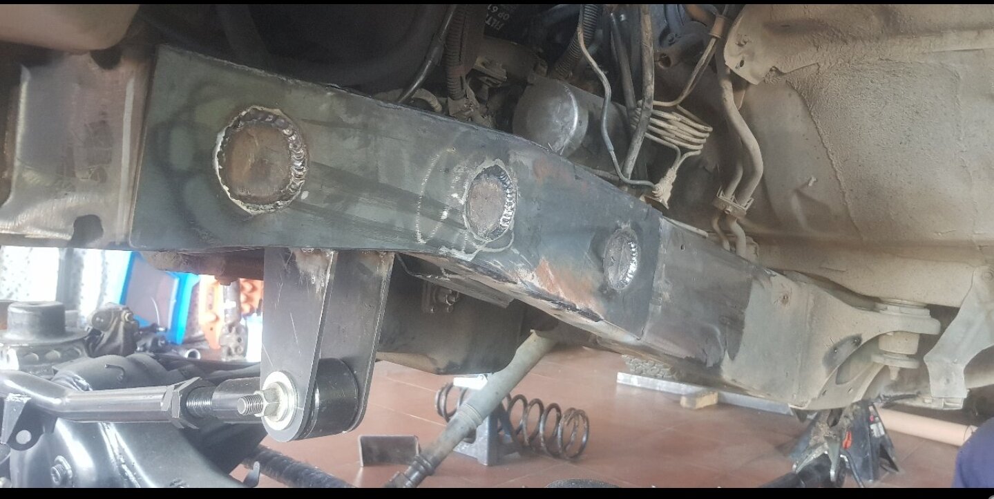

In front axle now I have swapped a nissan patrol gu y61 rigid axle with 35" tires nissan steering box...
Some pics

Nice work. Where did those louvre air vents for the second row windows come from?
what a great build & well documented .Are you a professional welder & mechanic ? How was it at the ITV ?
Very nice 100. Makes me want to fight the rust on mine :)
