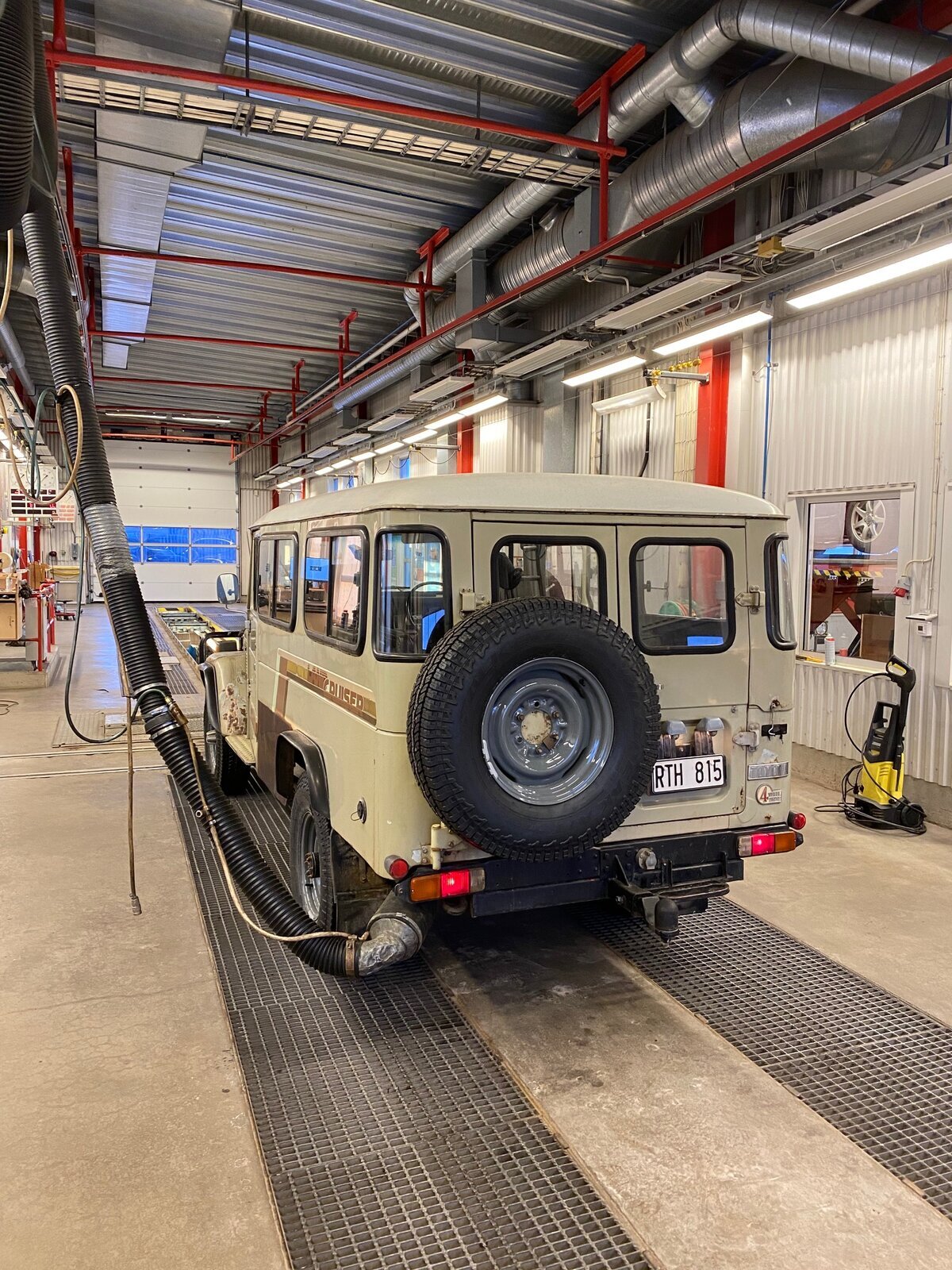

Anyway, here's my troopy (successfully) going though the roadworthy test:

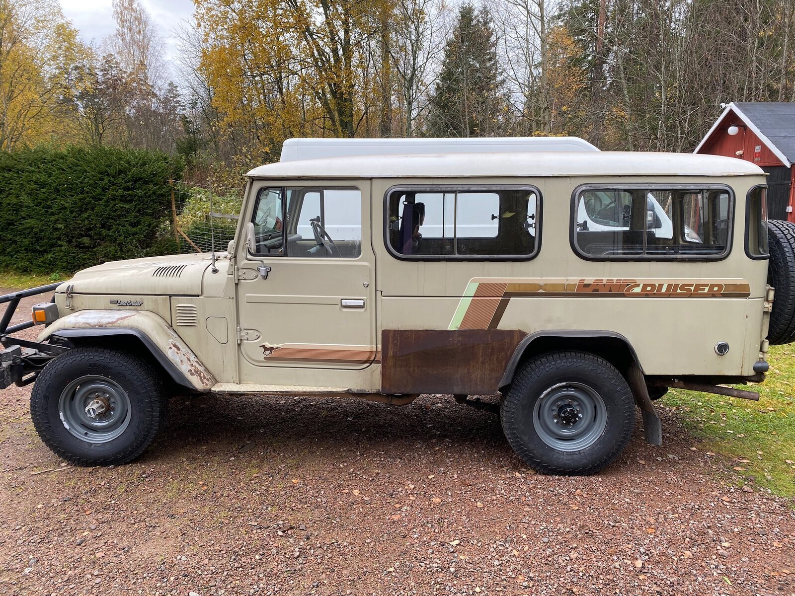

and a side view where you can almost see the restored rear hub...
