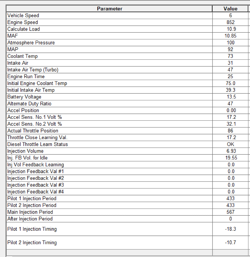

Hi all. I started up my 2007 120 for the first time in about 13 months and found a couple of quirks with the ECU and injector feedback values.
Firstly the VIN number was no longer in the ECU which was simple enough to re-enter with techstream.
Secondly the Injector compensation codes didnt match the injectors which were installed so fixed that
Thirdly feedback and injector volume feedback learning values are all at zero even with a running motor.
Has anyone come across a simelar issue before with an ECU which has had no power for a long time? Any feedback or ideas is welcome
