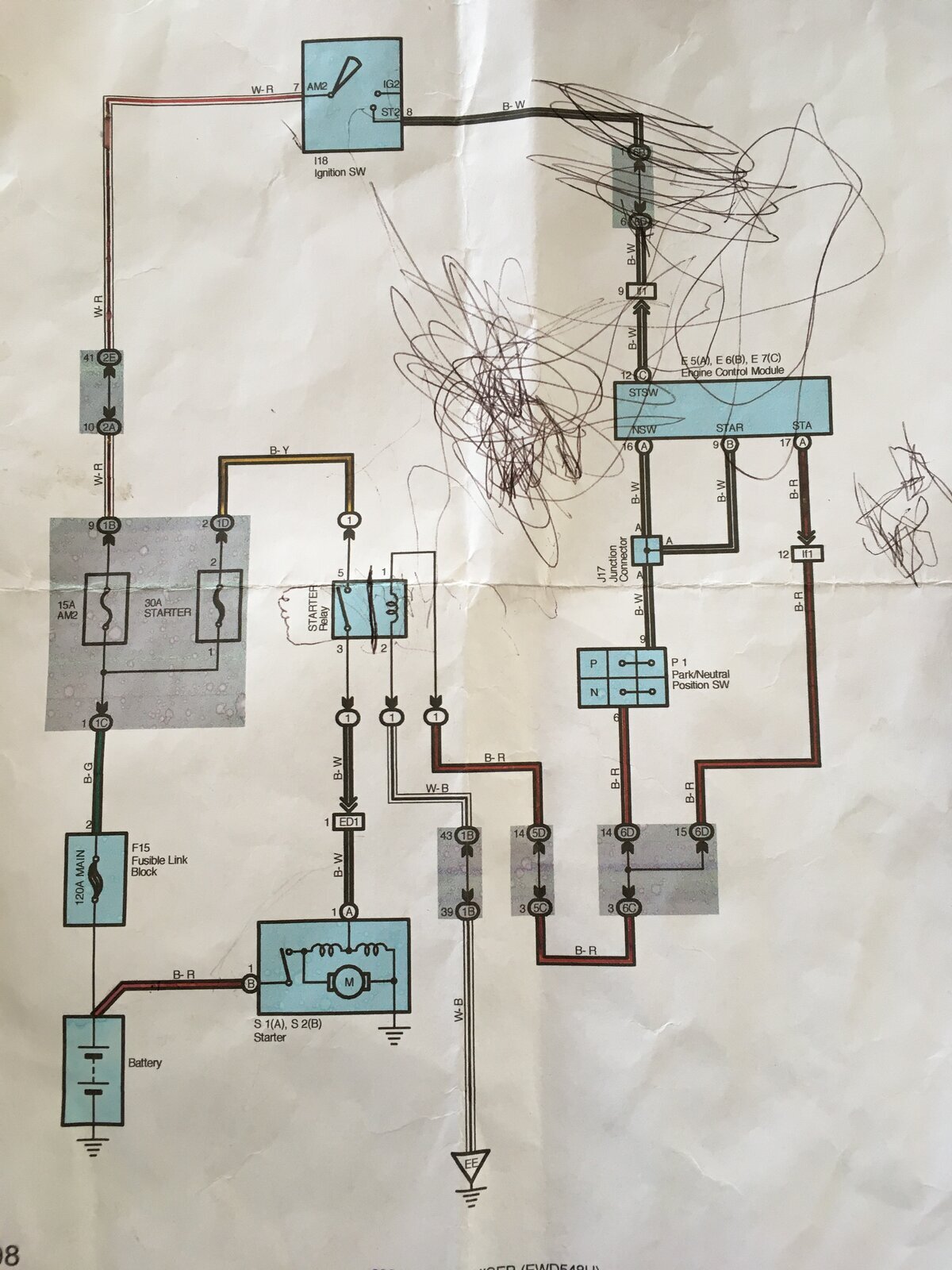

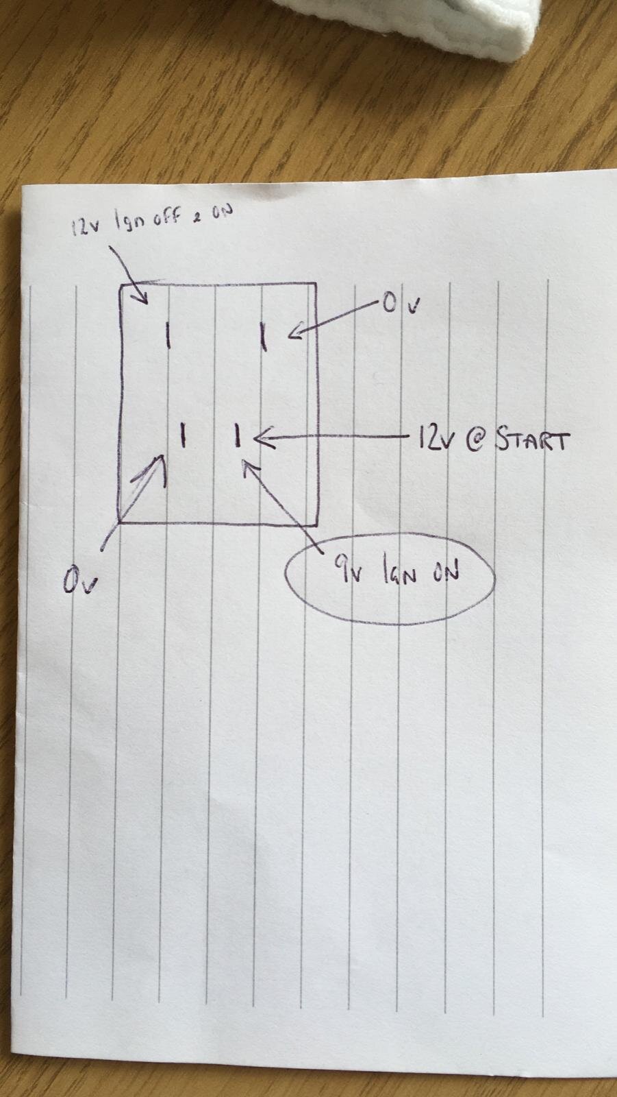

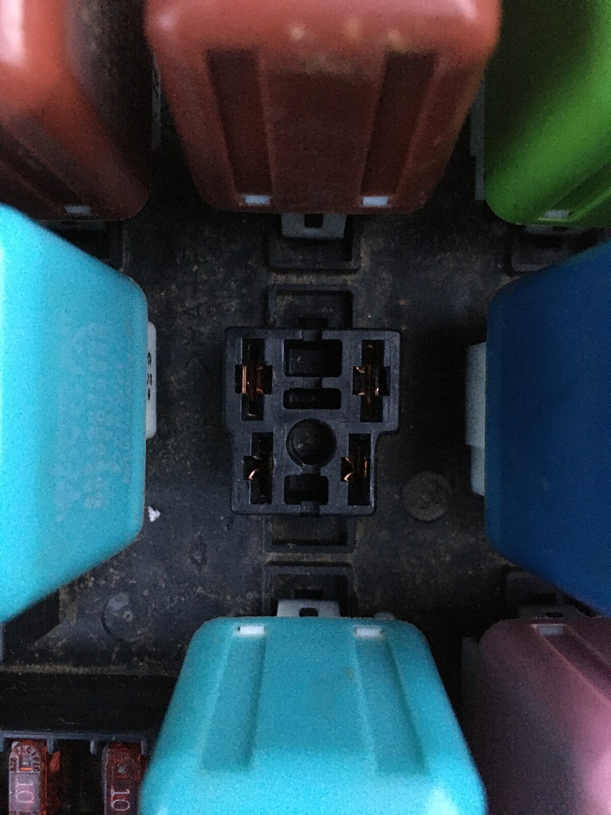

Where on the vehicle is J17 "junction connector" ....... separating the wire from pin 9 on the engine ECU will further limit where the 9v is coming from .
I'm beginning to wonder if it's not an internal ECU fault .......it seems you need or have 3 separate ECU outputs to the coil side of the start relay .....
What does "NSW" "STAR" and "STA" stand for ?
STAR...... I presume is start.....
Is the symbol on the B-R wire from pin 17 of the engine ECU indicating a diode at whats marked as "12" ?
On many machines I work on they have a 12volt system but then also a 10v and 8v and often a 5v processor supplied voltage used for sensors , switches and potentiometers ......
10V is often a clean stabilised voltage and is pretty close to the 9volts you are seeing .
Pull the engine ECU multiplugs and look for corrosion on the pins that maybe allowing voltage to track from another pin .
Also you can measure 9v but can it do any work ? Maybe try using a 5amp sidelight bulb in a bulb holder with 2 wires and put them in either pin on the coil side of the relay connector ....... with the multimeter also connected in parallel ........you may find that because you are then requiring amps the voltage measured drops away . If the bulb glows then you have a definite short to a 12v supply or poss fault with the engine ECU......
My only reservation with using the bulb to add a load to the 9v is if the engine ECU is supplying this voltage even 5amps maybe too much .....
