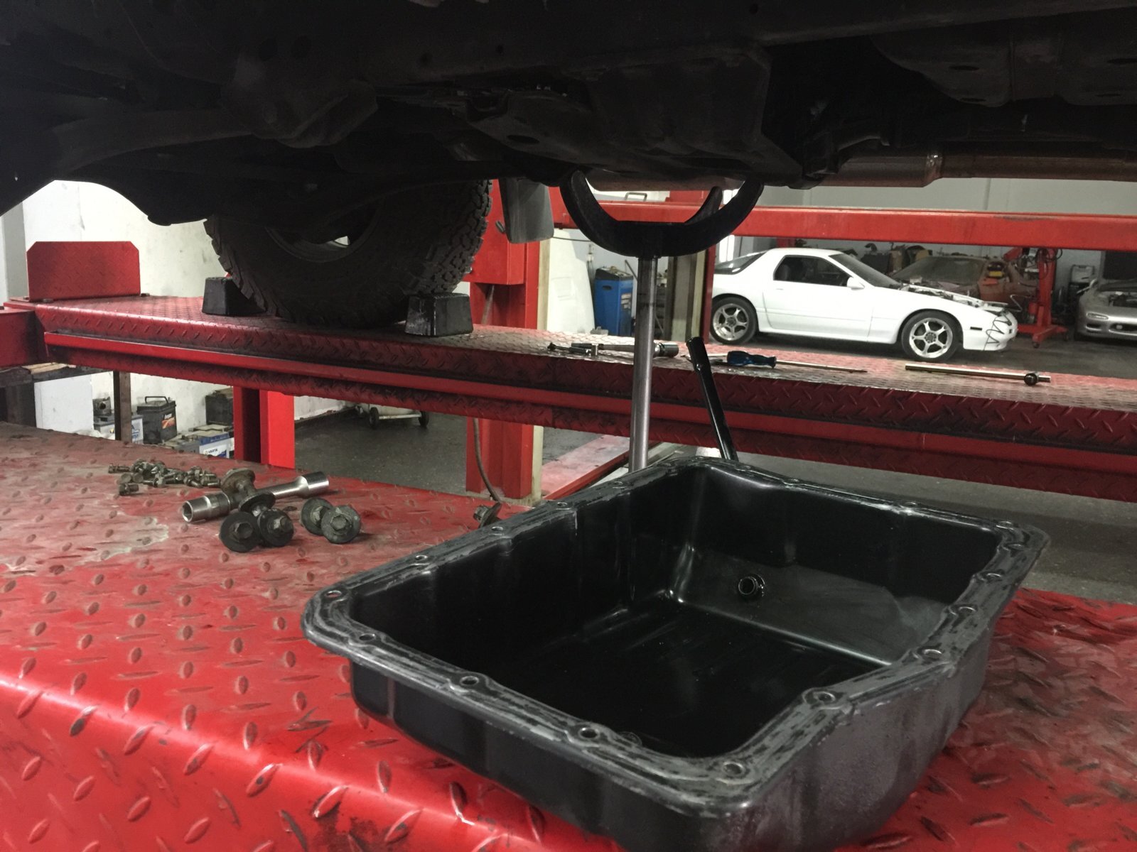

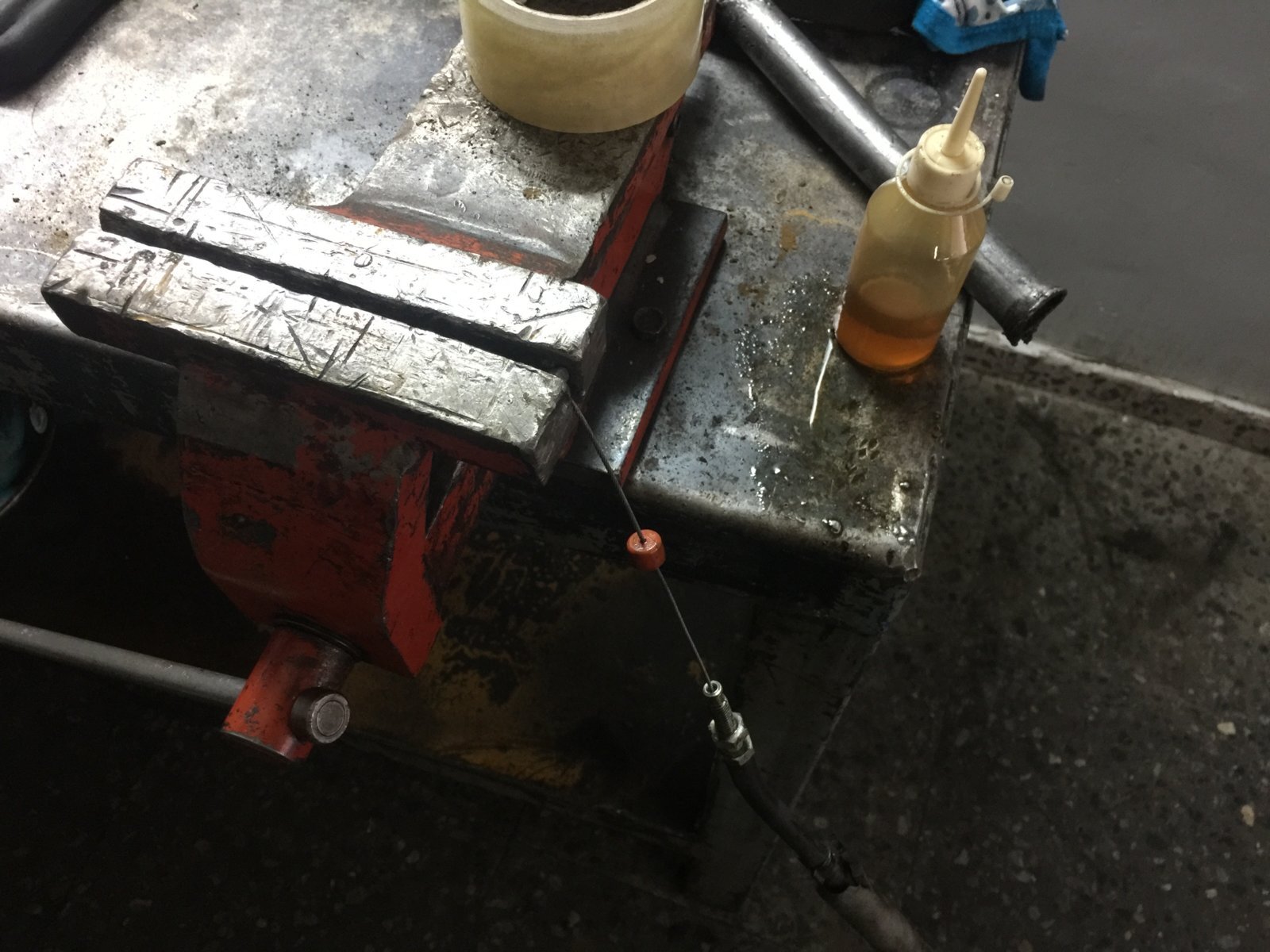

Guy today attempted to get to the bottom of the gearbox throttle cable that seemed stuck and non functional.
First up was to drain the gearbox oil and then open up the pan, reach deep on the side inner wall and undo the cable. Luckily the cable was accessible without having to take the brain out aiding no further trouble taking things apart.
Upon inspection the wire was stuck and seized. Best solution was to ease this with oil drip by drip easing out the seizure eventually enough to free the cable once again to work thankfully.
Once connected and tweeting the fuel pump it was aligned temporarily for a test run for the next few days.
One thing I did notice was the kick down was far better and top end speed opened up significantly reaching 150KPH (94MPH)
