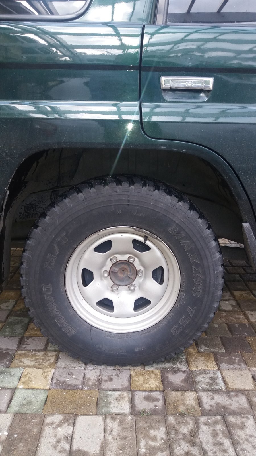

Thanks for the response. Do you know what width these are? If I go for a new rim to fit 285s what width should I get and...what offset? Thanks for your time.285's will fit but not be safe as they need to be on a rim at least 2" wider. 245's are as wide as you want to go on those rims.
Best advice anyone can give you Jam is to search the web and find a truck to copy because its all been done before .
I don't know but i am inclined to think a 2" lift on the LJ70 will allow for 285'/75's on 16x8 minus 30ish offset rims , which for me begs the question will 16x10 zero offset with a 305 tyre fit ?
It doesn't look to me like you have a lift which makes all the difference .
How about telling us a bit more about yourself and your truck , are you just buying bigger tyres because you need new ones anyway or might this be the first step towards a highly modified truck ?
I just wanted bigger tyres and 4/5 years later i'm still here and still modifying
Nice. Thanks for the input. Heres my 70.This is my daily driver with a 1kz-te engine approx 10,000 miles a year and the only downside i can think of is maybe i use a little more fuel than a standard truck .
As you can see we have different trucks so i'm not best placed to advise you but i run a Pedders 2" suspension lift under a body lift and 285/75 on 16x8 -30 something offset rims .
