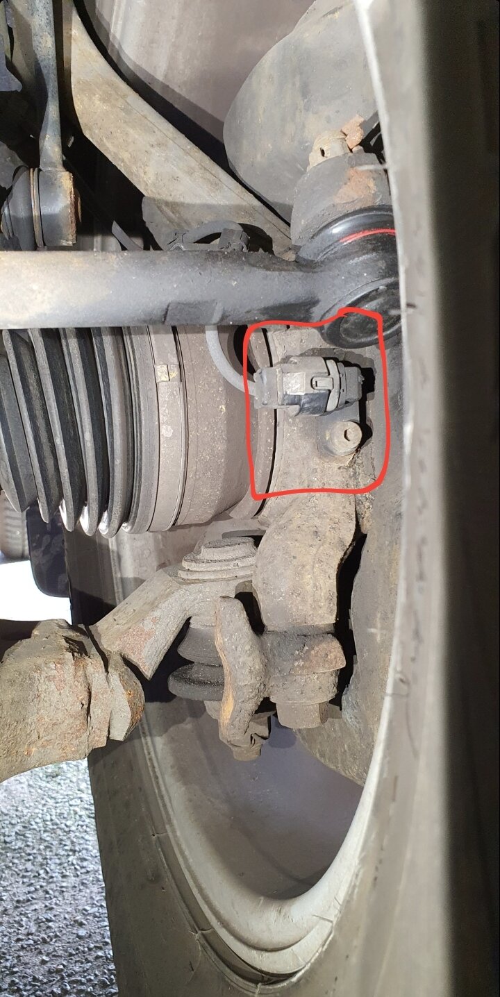

You can see where it is on this pic. You probably dont even need to jack the car up! One bolt, one connection.
Make sure you buy the left hand side one, as right side is a mirror image of it!
I bought a couple on ebay when I thought I needed them, they were only cheap.
