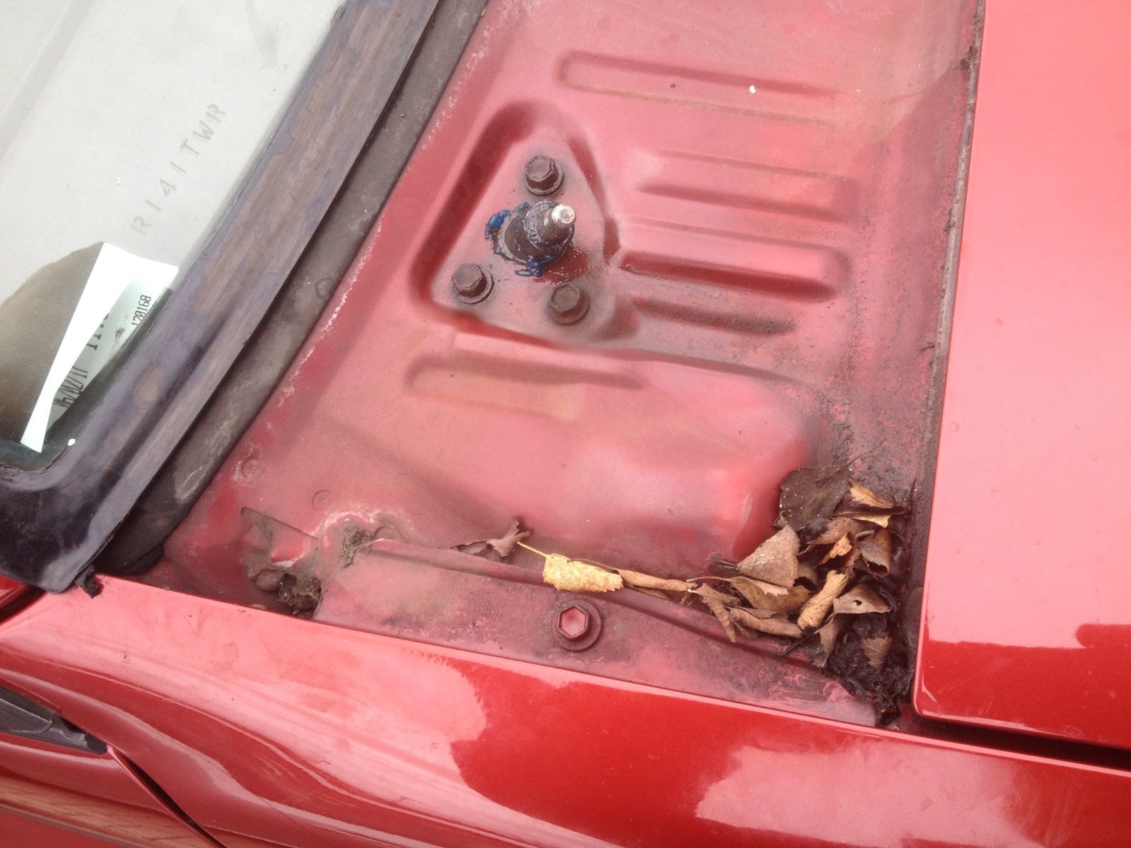

Had a closer today and removing the scuttle panel means removing the bonnet first and I was on my own today so that plan got scrapped for now. The screen rubber is definitely bonded to the bodywork on the screen pillar side. Being a bit more forceful with the feeler gauge I managed to get it between the rubber and glass round the bottom corner of the screen. There was definitely water in there so wiped it clean and dry with some rag and squeezed in some sealer. Nice neat job and you can't tell I've been there but I still don't buy 100% that it's a screen leak. If water does get between the glass and rubber how does it get into the footwell without showing on the inside of the screen? Had to wait for some heavy rain to stop first thing yet there was no water ingress so I still don't now if it's fixed. Sealer should have gone off by tomorrow morning so it'll be the hosepipe test.

OK, so I had another go and got the scuttle off, used a small ratchet with crosshead bit :thumbup:
As mentioned above, not an awful lot under there. The drains were well blocked with debris but other than that nothing obvious, no corrosion, holes missing grommets etc. The screen is well stuck to the body, just can't see anywhere water could get in. Even with blocked drains why/how should water get inside? Cleaned everything up and tried the hose with everything back together and couldn't see any water inside. It'll be stood all week as usual and we have some heavy rain forecast so I'm leaving the carpet up for now!
If there is no visible water on the inside rubber and it is the screen leaking it must be leaking between the body and rubber. The corner of the rubber looks like it might have been resting in a puddle of water and therefore there could be a capillary path leading to a crack in the body/glass seal. The puddle of water could be due to a bloke drain. I don't think I cleaned my drains when my valence was off but on other motors I've used A bottle brush and plenty of soapy water to get the slime off and capillary path broken down.

Tried another good dowsing with the hose and this time water got in. If I play the hose on just the bodywork where the bonett/scuttle/wing meet, avoiding the screen it still gets in which throws even more doubt on a screen leak. It's very difficult to see up under the dash as far as the bulkhead top, not helped by the close fitting, rubber backed sound deadening everywhere. Tried looking through the gap between the wing and bulkhead in the door jamb and also took out the side light for a look up through the inner wing for any signs of corrosion but not a trace. I reckon it's got to be in this top corner of the bulkhead some where. I've also noticed the weather seal along the edge of the scuttle which is supposed to seal against the bonett doesn't do a very good job of keeping water out of the engine compartment when faced with the deluge from a hose pipe etc. Might try taking some of the lower dash off at the weekend so I can get a bit closer to the bulkhead top.
