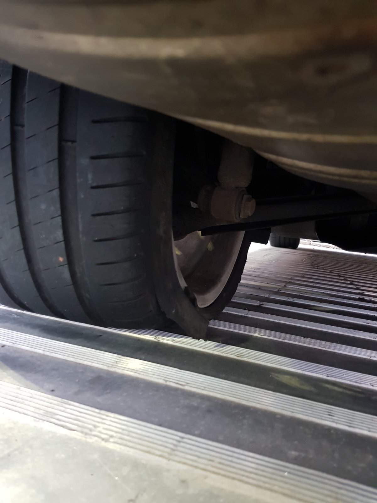

When i first got it (8 years old) it was the front right that kept going down, the others were topped up with the rest of the 50p. Id notice it more because it woukd wonder towards the right when driving. Now they've been refurbed and its just one of the back ones it gets pumped up when i notice.... which can mean there's bugger all in there. Im not surprised in the slightest that tyre died, just annoying i couldn't undo the locking wheel nut. I had anither tyre in my garage which saved me spending another 200 quid!
