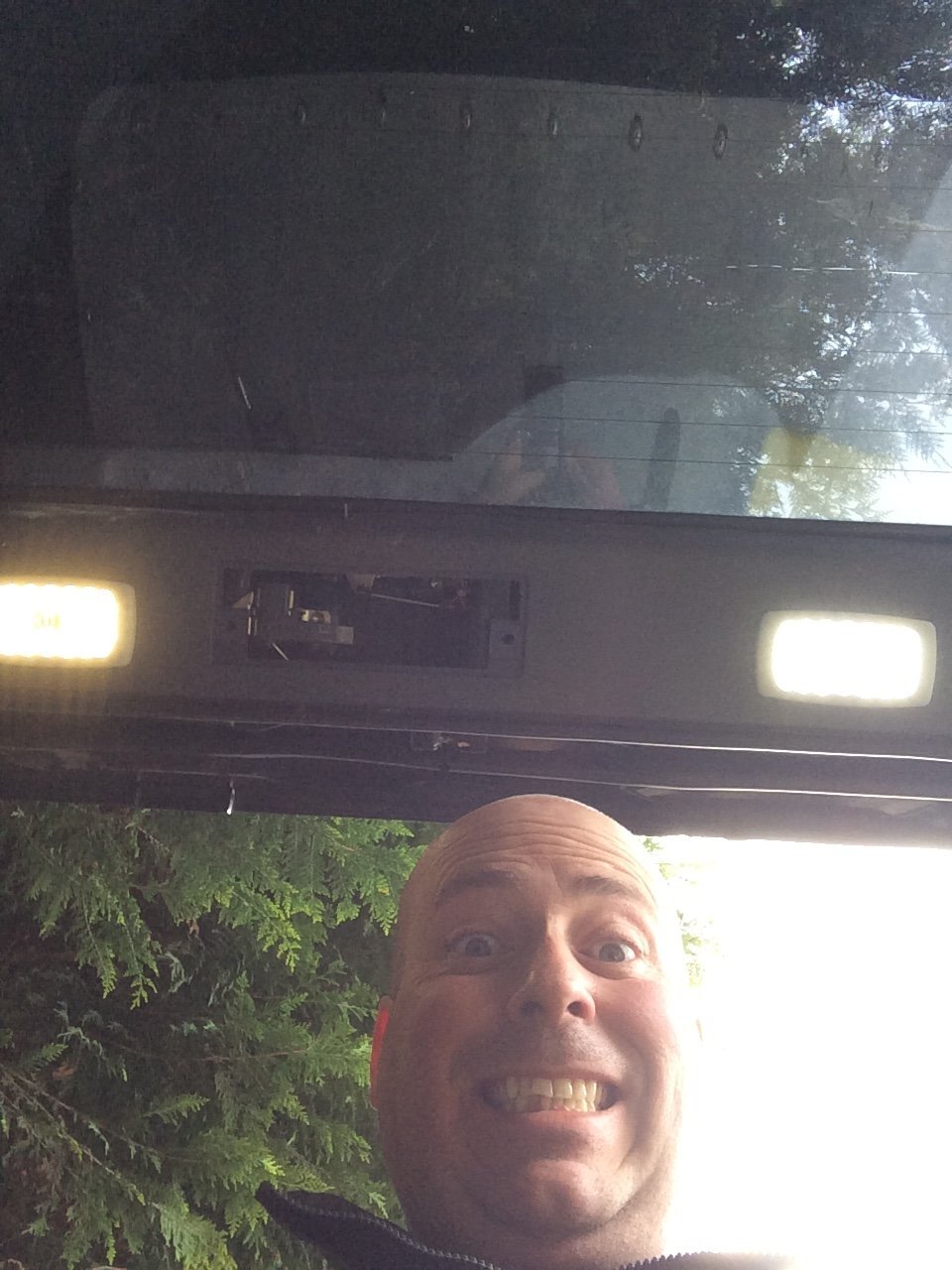

It certainly was! Fitted that light this morning, blinding. Just having a go at wiring in the mud uk lights into the tailgate.Basic service (air, oil and fuel) including a fully greased transmission.

Your really good at balancing that tailgate on your head , can you do it with a bonnet as well?
I'll have to give it a try!Your really good at balancing that tailgate on your head , can you do it with a bonnet as well?
