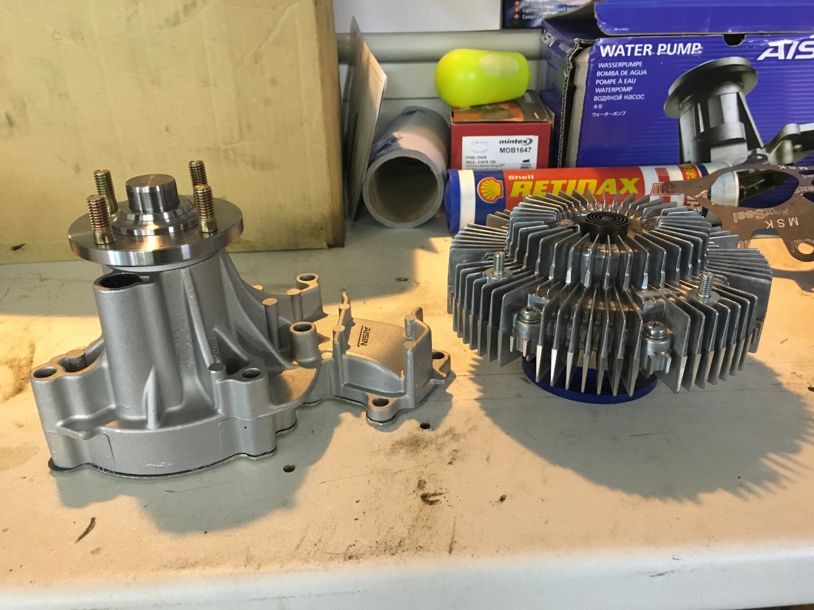

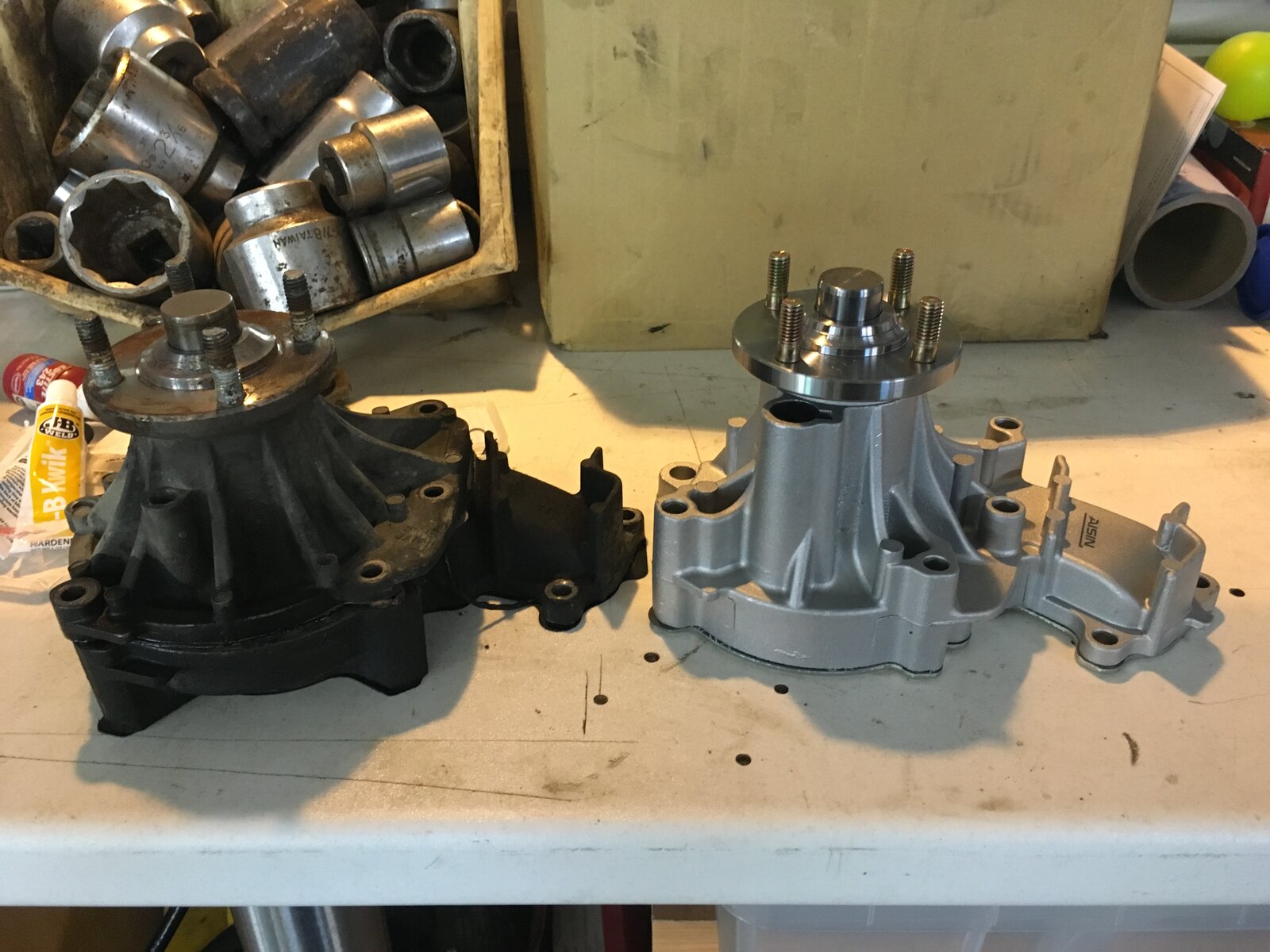

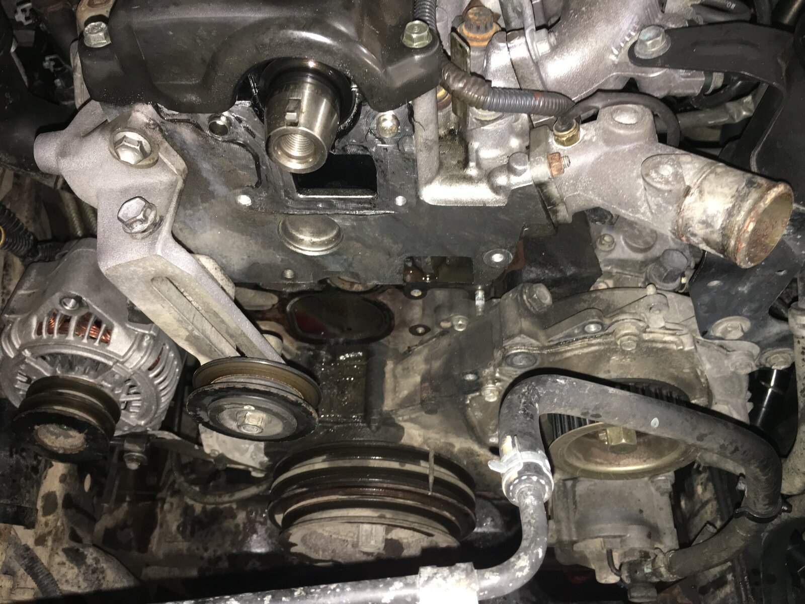

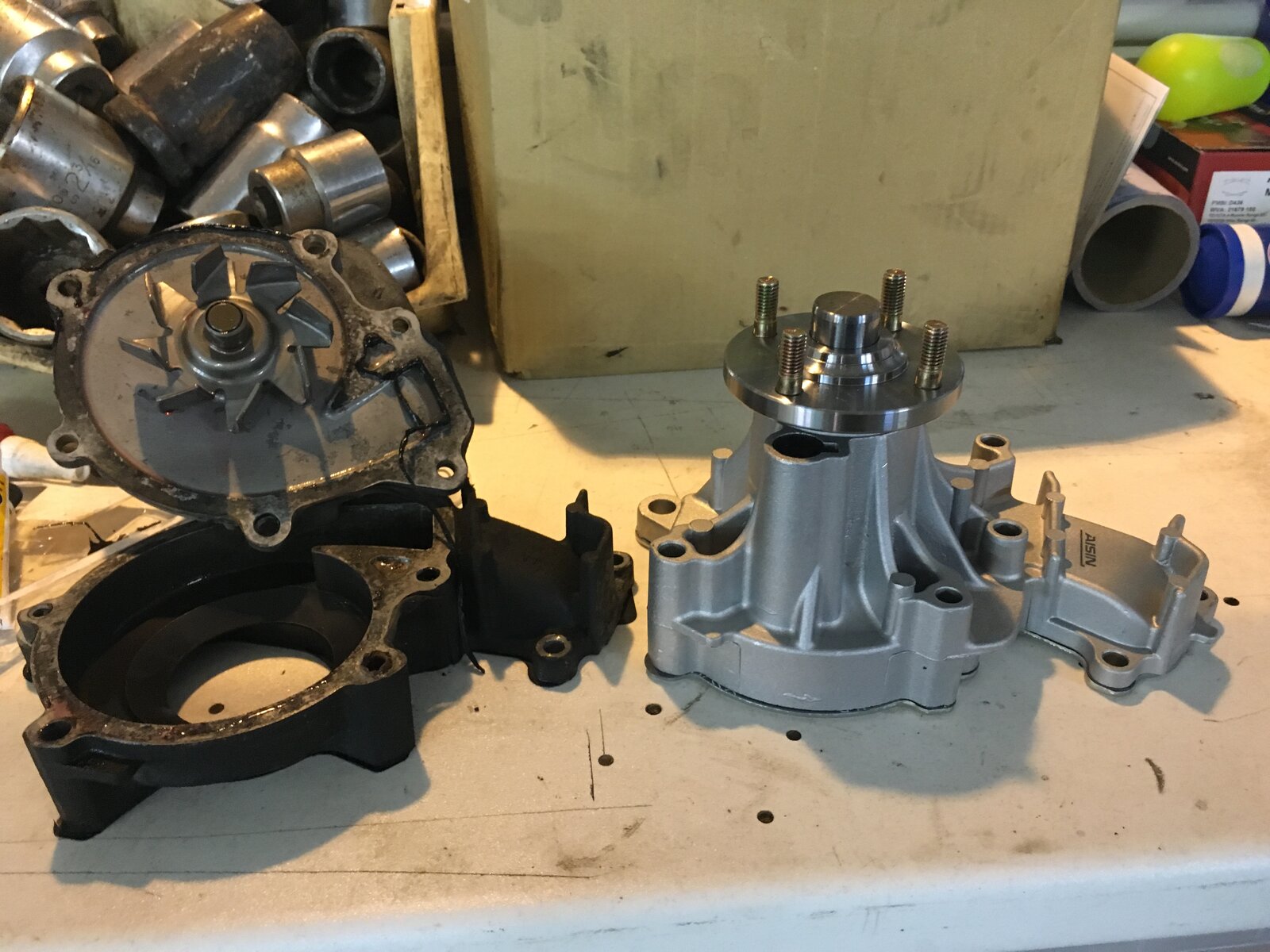

Friday I ftted a new 82 degrees thermostat as i found unless pulling my trailer around the 71 degrees stat was making my engine clog up by not running hot enough, i also fitted a new aisin viscous coupling and new water pump, the new cast bodied water pump has alot bigger high flow pump inside!
http://www.roughtrax4x4.com/aisin-water-pump-with-cast-housing.html
http://www.roughtrax4x4.com/aisin-viscous-fan-coupling-7436.html
I've also gone waterless by using Evens waterless coolant so we'll se how it goes.

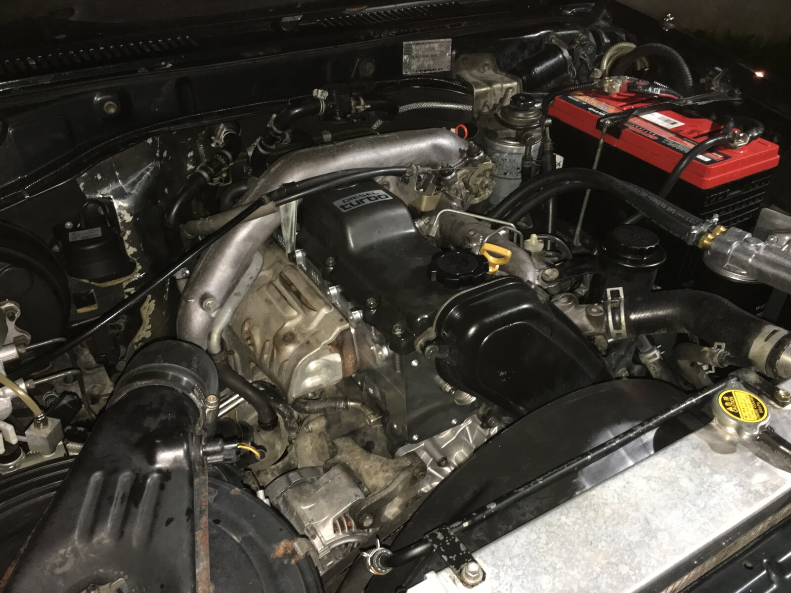

engines running as it should around 84 even driving at speeds, just need to try it with my trailer on.
Few pics of parts and strip out

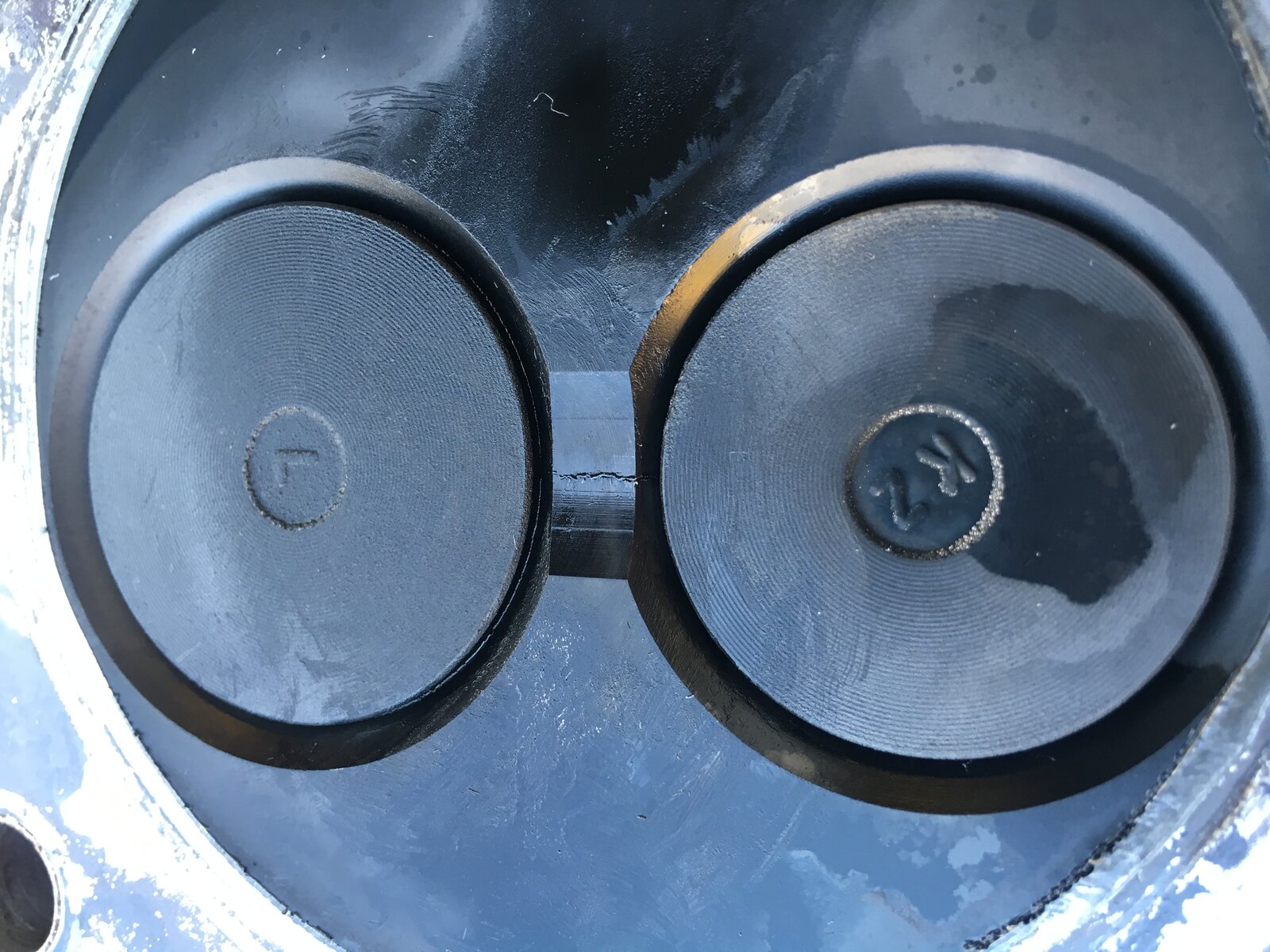

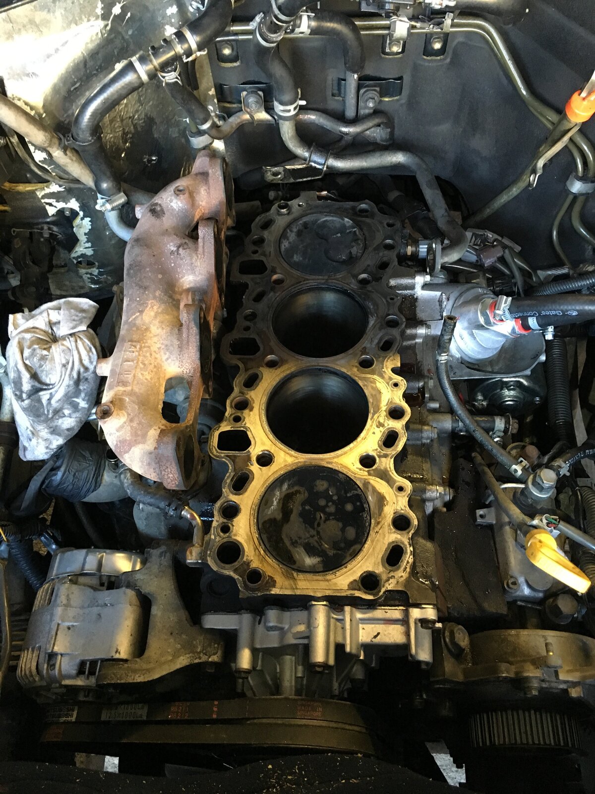

Well that was an expensive litte operation!
Ive been running a 71 degree thermostat but as winter is coming fitted the standard toyota 82 deg stat well two weeks later after a bit of a mad rant down the motoway and temp only hitting 95deg I cracked another head!

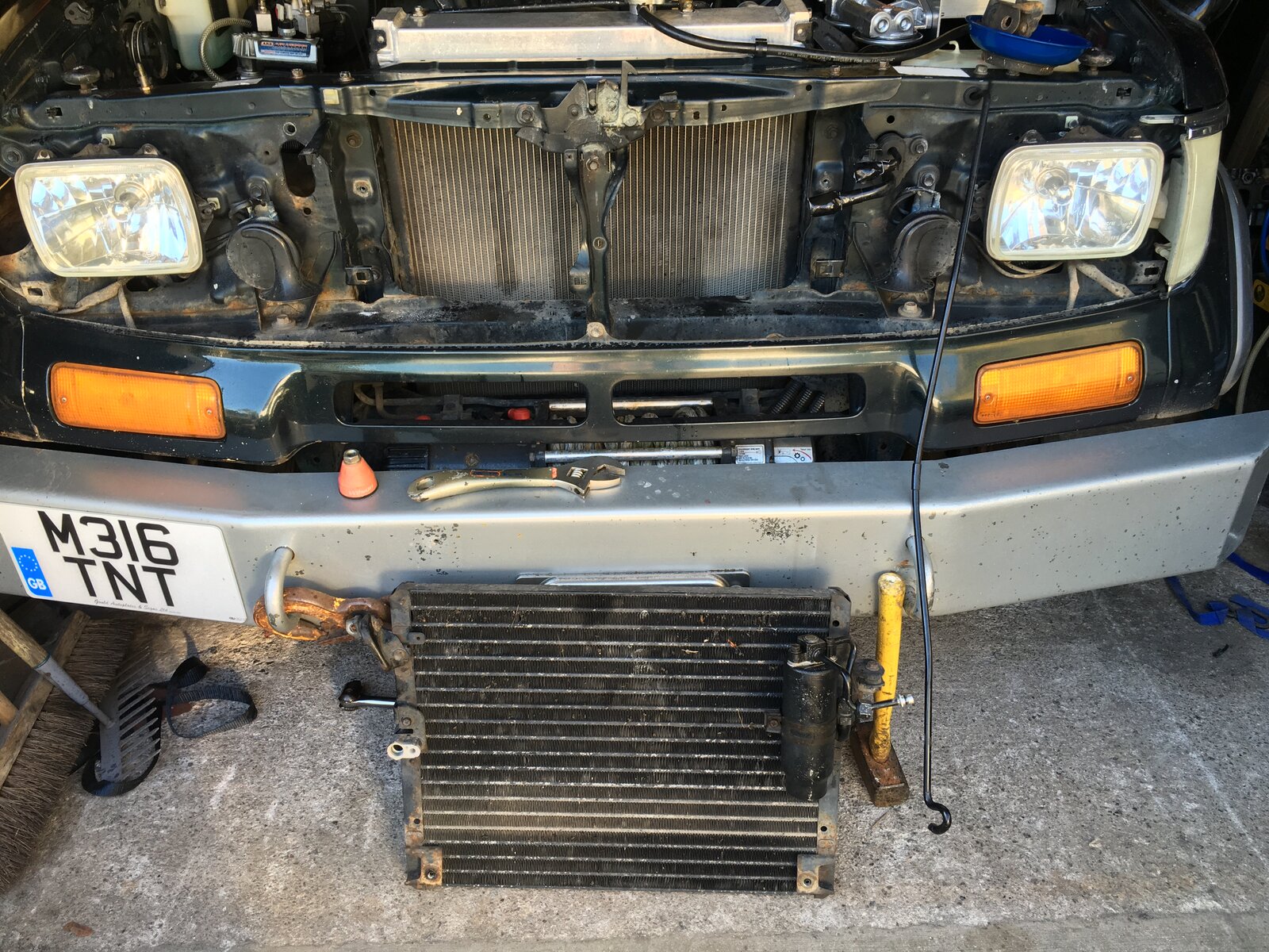

Even after removing the air con rad from in front of the rad it still climbed to 95 easily on the way to the lincomb meet! Ffs.
So back down to the 71 stat and all is good again!

My main problem is, is that running round on the lower stat is causing my engine to oil up and the oil to get shity because its not running hot enough to burn off all the impurities, even the two weeks is was running on the hotter stat it cleaned up and wasn't smelling oily any more and no exaust smoke.

I'm also intrigued how easily it overheated and cracked the head. I recently had my 1KZT-E hot. The needs was in the red for a while and the water in the system had emptied itself (burst hose due to my laziness). Anyway, my head had a tiny little crack in between but not all the way through like yours. However the head ended up badly warped. Surprisingly no coolant was being blown as the gasket was gone so badly it was throwing compression into the cylinders next door instead.
