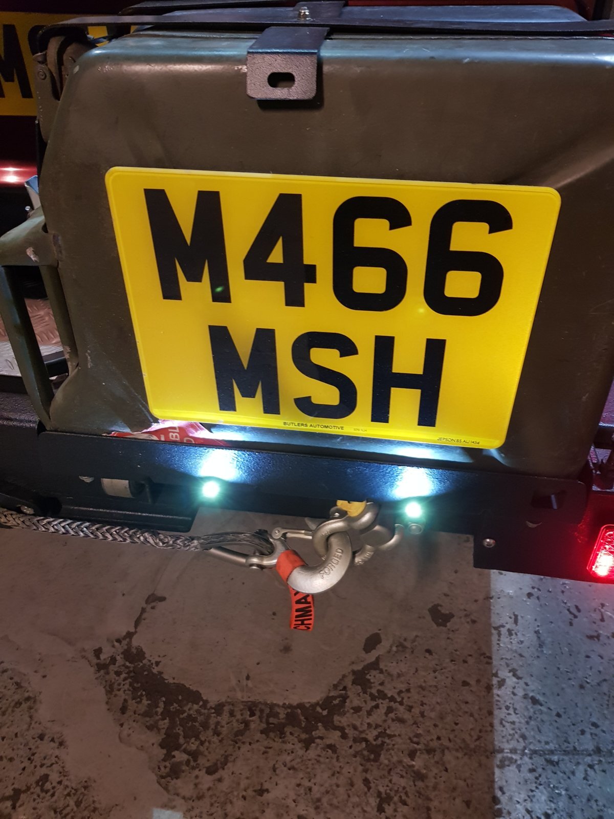

Managed to get a few hours today to work on the truck and the number plate problem is 1/2 solved.
Just waiting on a LED motorcycle number plate light.

Tempted just to fit another set on the rear bumper. Anyone know if I'd need to discount the ones on the rear boot? Or can i have four rear fog lights ?

That's one of the reasons why I built my carrier the other way around. Just made life simpler.
You can have as many as you like as one is visible centre or driver's side.

Steve you could mount a surface mount onto some spare or visible space on the wheel carrier rather than fit in the usual under the rear bumper and if you have time look under the rear and there maybe some factory plugs for trailer electrics and tap into that for fog light power oh and dont take this the wrong way Nice Rack and Rear End

@SteveJB That's the plan I think, I'm going to mount the fog light in the centre of the spare wheel, as there are already mount points. Also already got a 7 pin female plug, that I'm using to wire in the fog light / numberplate light.
