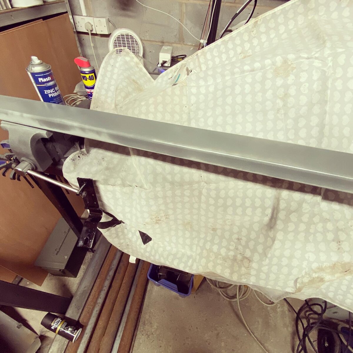

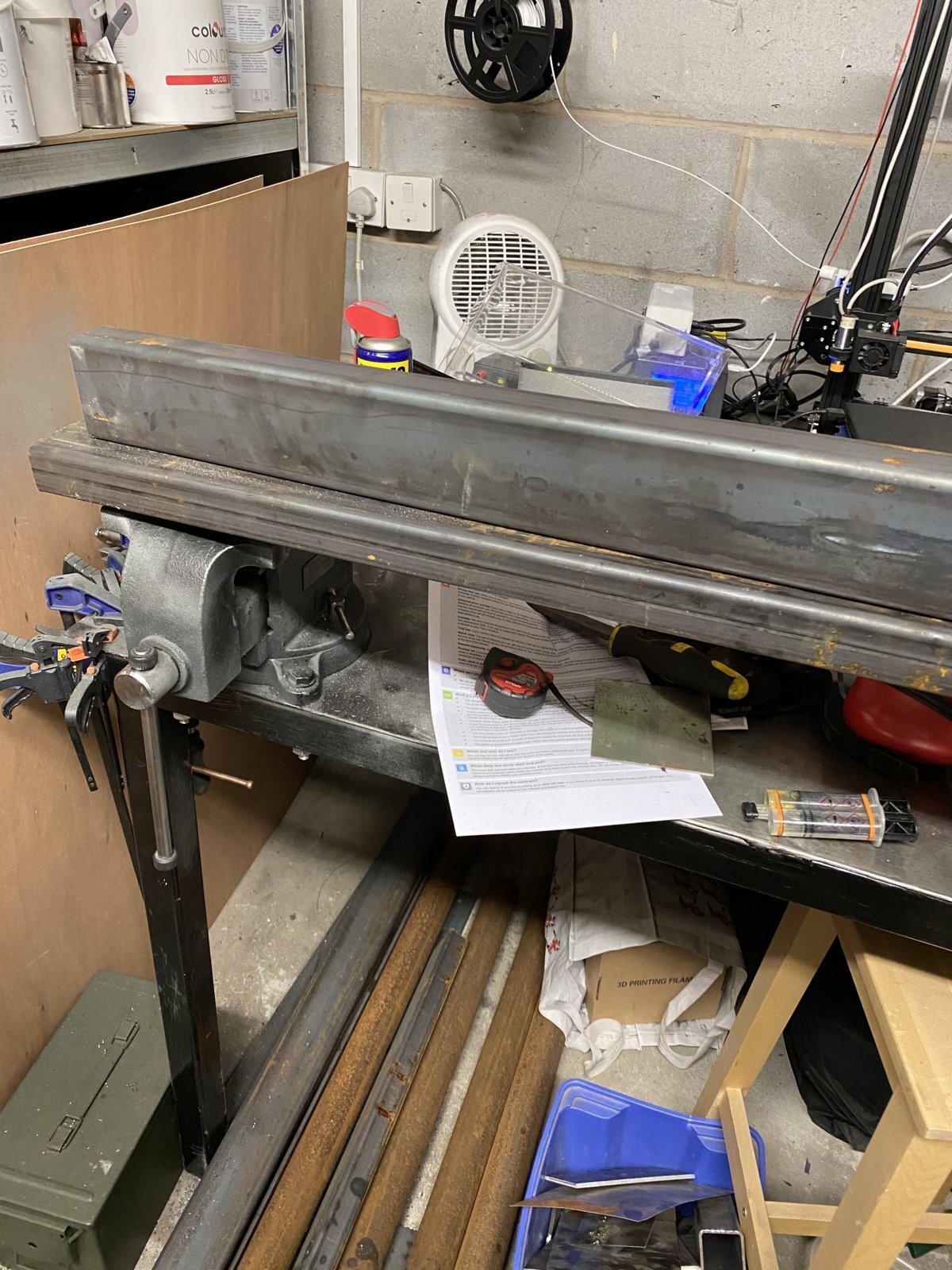

But I needed somewhere to mount them, so got around building some, first thing was the correct selection of stock material, well whatever was in the off cut bin.
Shame all I found was 3mm steel, as everyone knows working with ticker steel is so much easier than using the correct material.
So after chopping it up into the correct dimensions and measure the distance between the mounting holes, five times then measuring them once again after I've marked up the stock it was time to drill the holes.
Holes all drilled and some M8 threaded rod welded into the holes and the other holes tapped for some M12 bolts (yet again all i could find in the parts bin). After a few sprays with a rattle can doesn't look half bad. Finally mounted on the truck.
At the moment they are held down using some massive washer and some M8 wing nuts using the threaded rod, so it's easier to get the recovery boards on and off the truck. Some M12 bolts with massive washer mount through the roof rack to hold the entire thing down.
