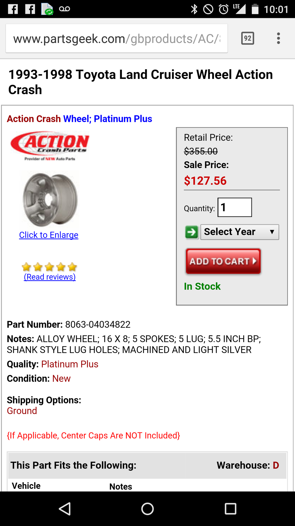

Question is, the wheels I see by Action Crash, are they legit? They look like stock replacements for a 93', but are they or are they replica? Does it matter?

Here is what I was looking at (sorry can't post a link yet)
They look very close to original and at that price are a steal! One thing, they state 5 lugs which is not an 80 fitment. But the photo shows 6 holes. Probably worth checking with them but other than that they look superb.

Scroll down Clive, there seem to be better prices there, though on first inspection I don't see why the difference. They seem to list 6 stud 'acorn' style which will probably be cone nuts (earlier 80) and no centre caps. I found some reasonable centre caps on eBay from the States.
At the price I couldn't buy a second hand genuine alloy and have it refurbished to anything like the new standard.

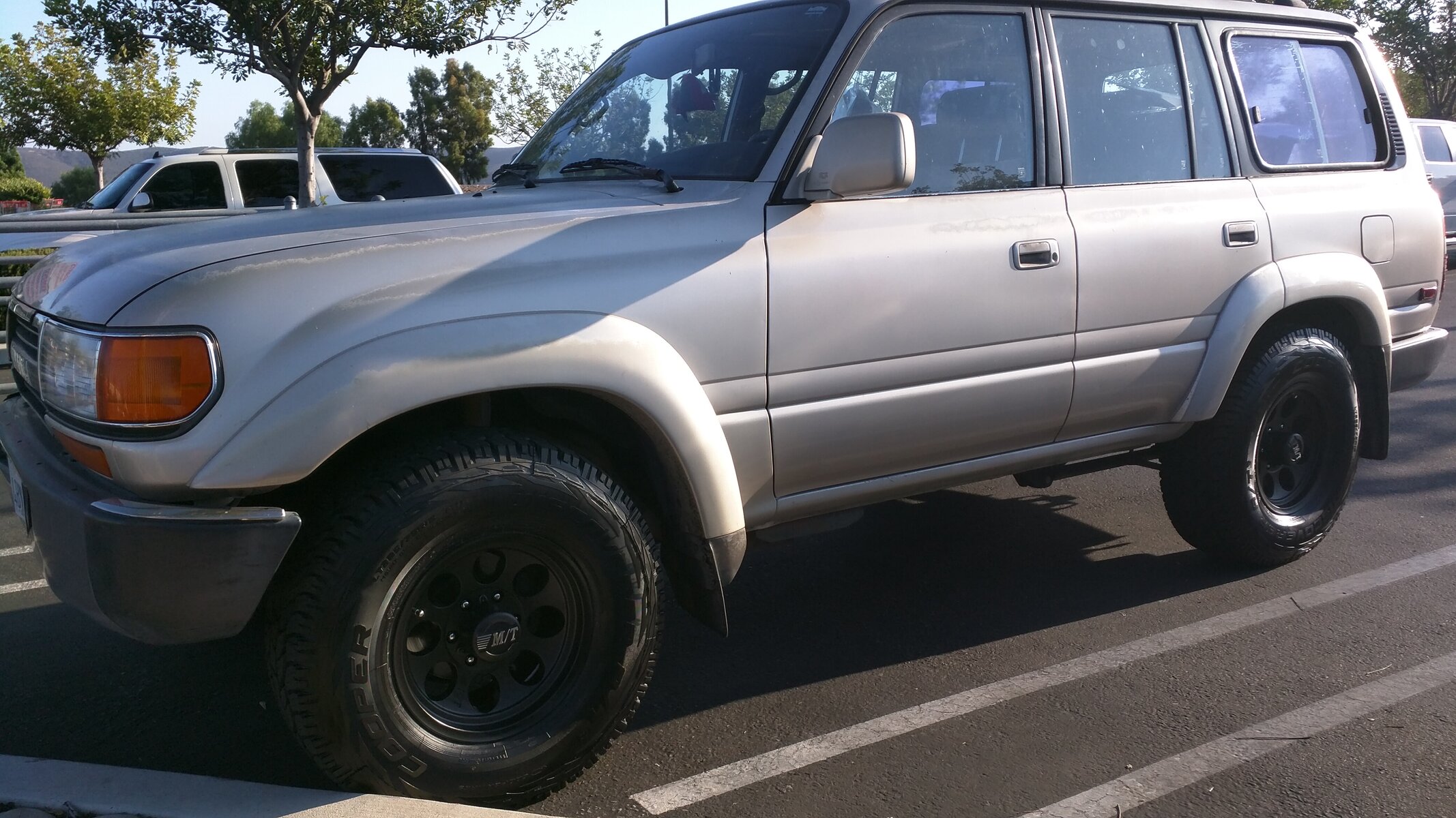

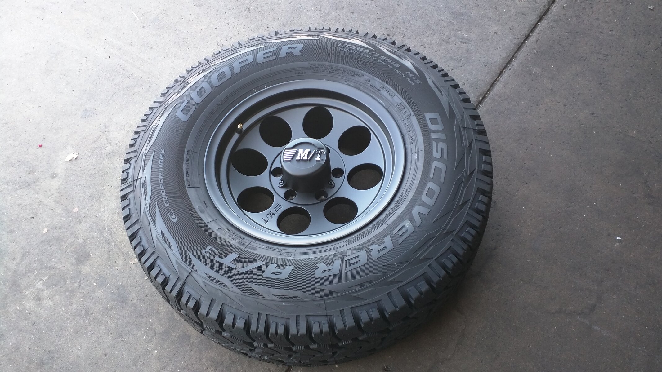

So this happened today. Installed the MT wheels with 285/75/16 Cooper AT3 rubber.
Have a desert/mountain trip in 2 weeks I'll have to report back. Super happy thus far.
Looking into that OME stock height kit.
Looks like you've had a good result there Alouis, I rather like those and there's not many in black I do like. All I keep hearing is praise for the Coopers. I put some second hand (private) STTs on a set of second rims for off road use and they are very good and seem to be pretty good on road too with only a small amount of noise.
The truck looks great with those on [emoji6][emoji122][emoji4]
Thanks SC! Ya I'm super excited about them. My dad has the AT3 also on his F150. Everywhere I check had them priced really high so I wasn't aiming for them. I was ready to go with the BFG KO2. Last place I checked had them for a stupid price so jumped on them. Really happy with them so far. I had just found an article on these and the SST right before I called the shop and was really impressed with the review.
