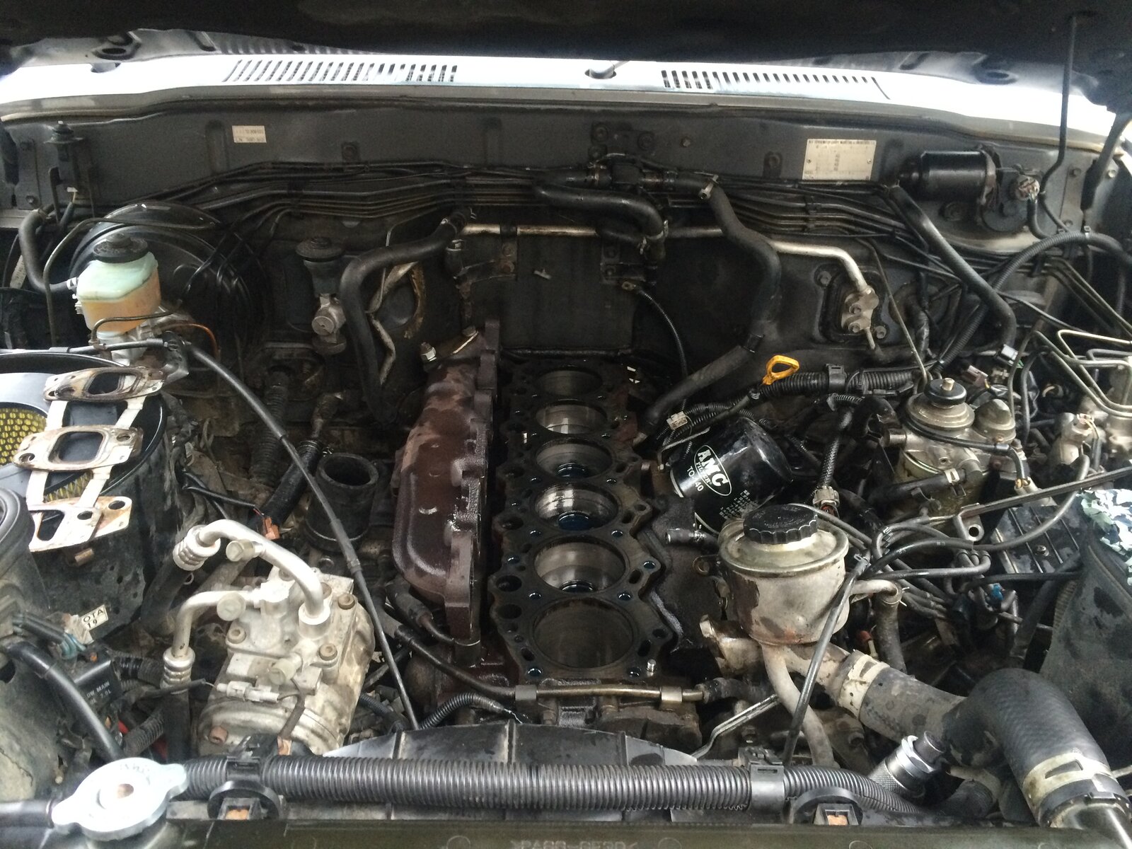

finally got started on my engine today the bores look good no gouges or deep scratches i can still see the cross hatching and after i remove the carbon there is no ridge so i shouldnt have to take the block for a rebore but i will know for sure when i get my micrometer from work tomorrow IMG_1438.JPGjust got to get the sump off now
