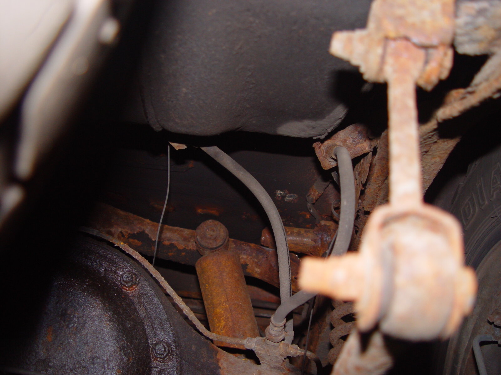

hi i made the same mistake with milners springs my wife has to put on a sports bra to keep things under control the hole truck pitches foreword on every bump even after 150000 miles it has not softened up my last hj60 i put some coils between the springs and the chassis that was good i i bent some 10mm plate to fit the chassis then welded some bar the same id as the springs did the same to fit the leaf springs this got the ride hight back up when the she got the tool box in you can just see the spring in the picturehello peeps,anyone know for a set of standard leaf springs for my 60 series,
