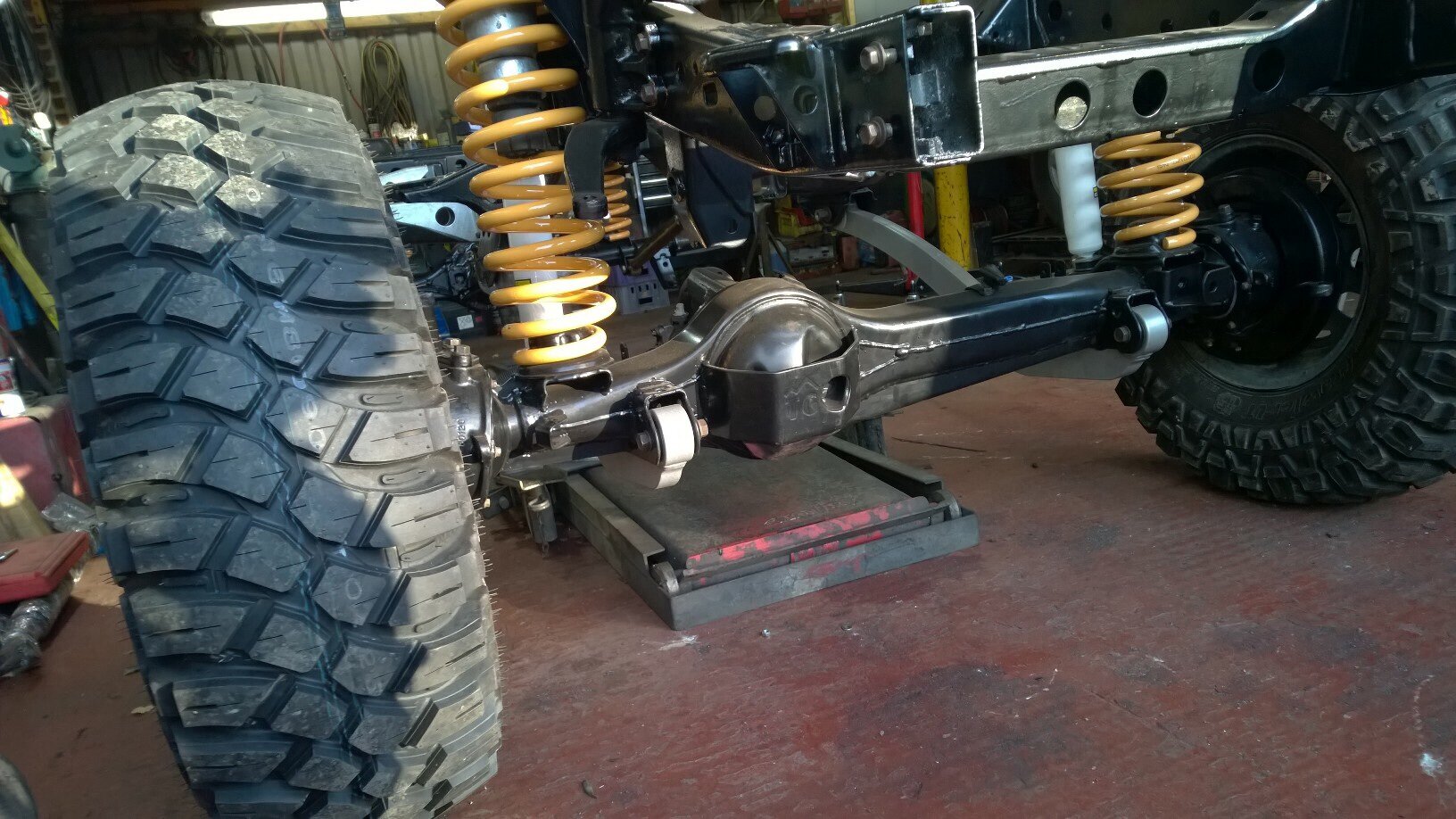

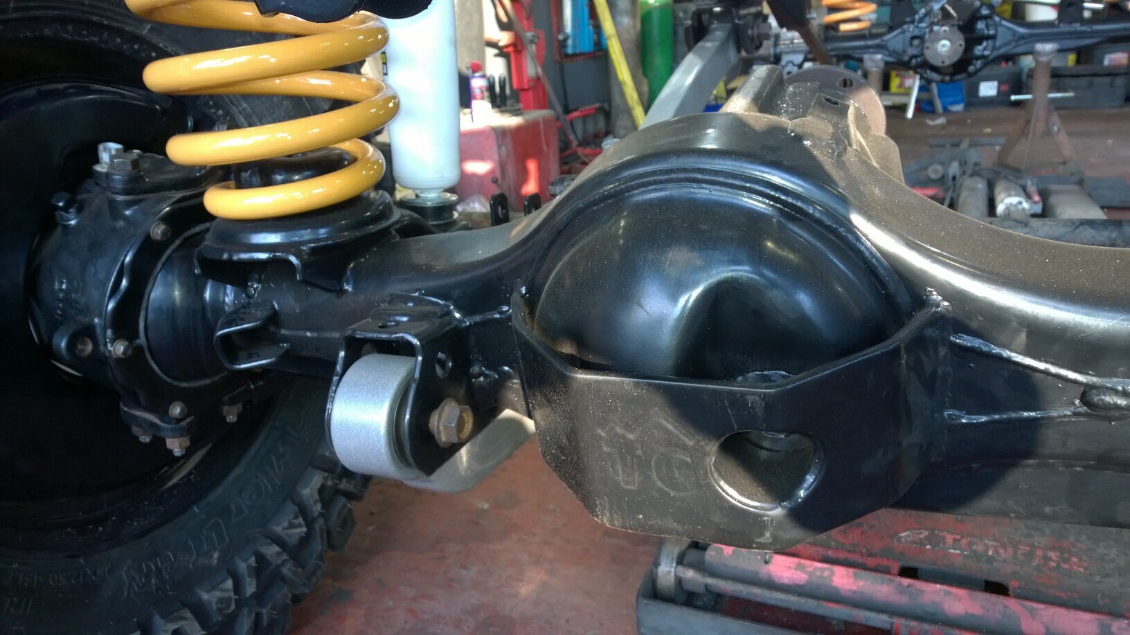

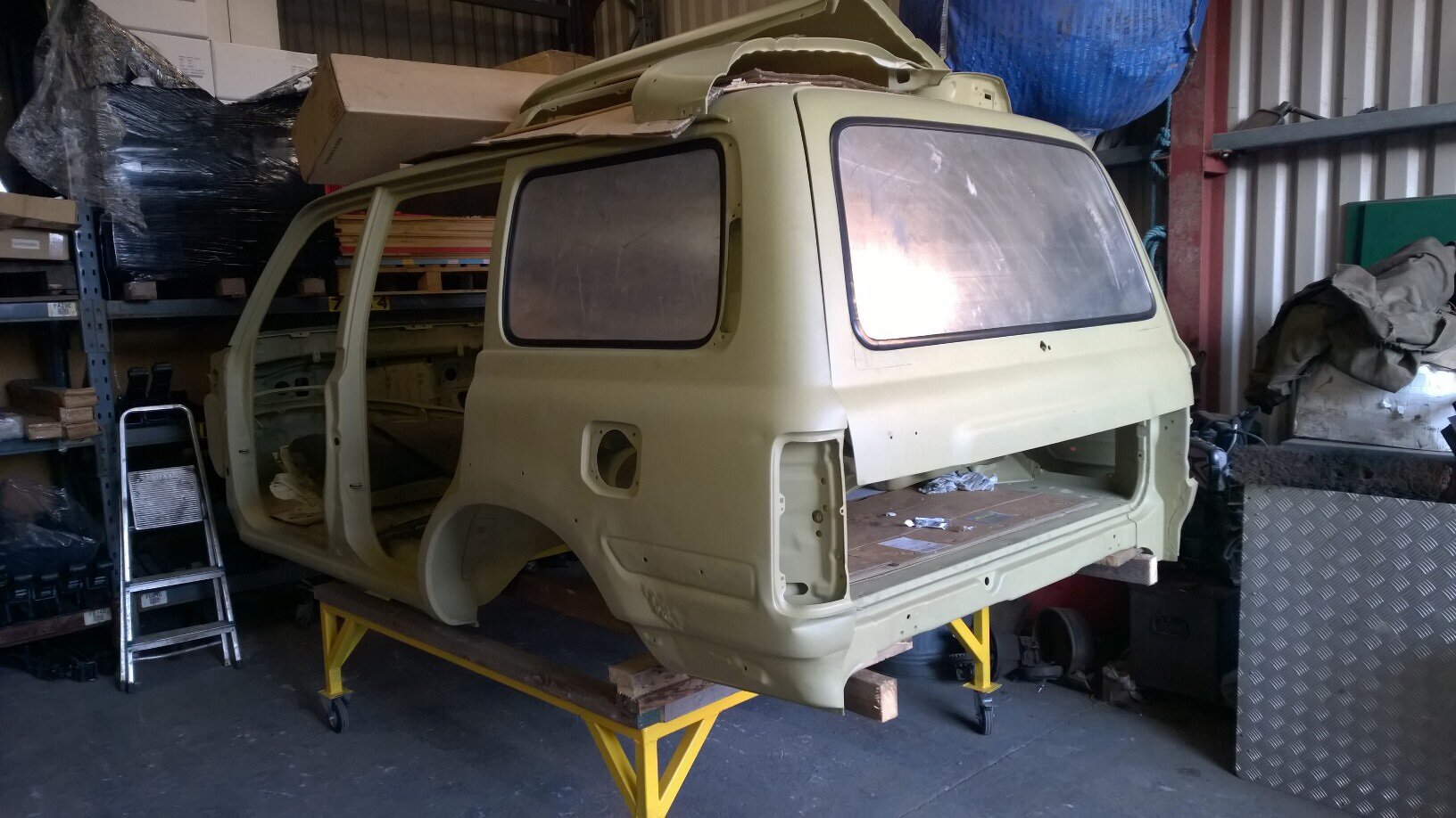

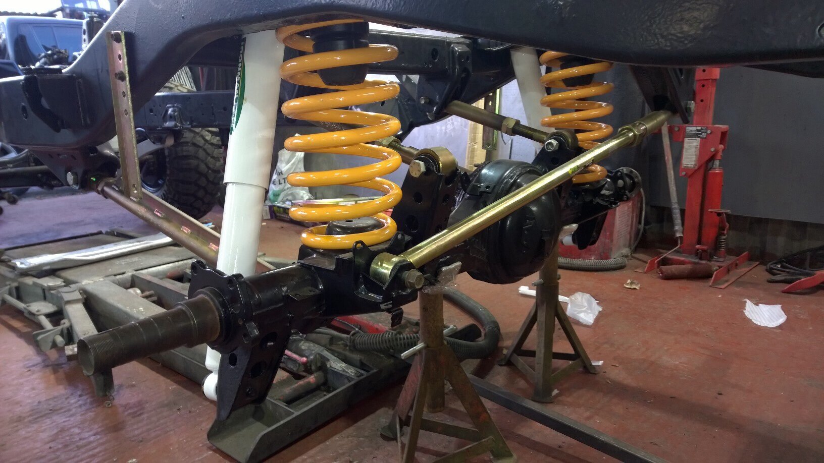

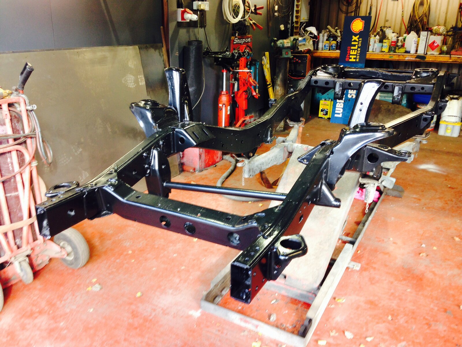

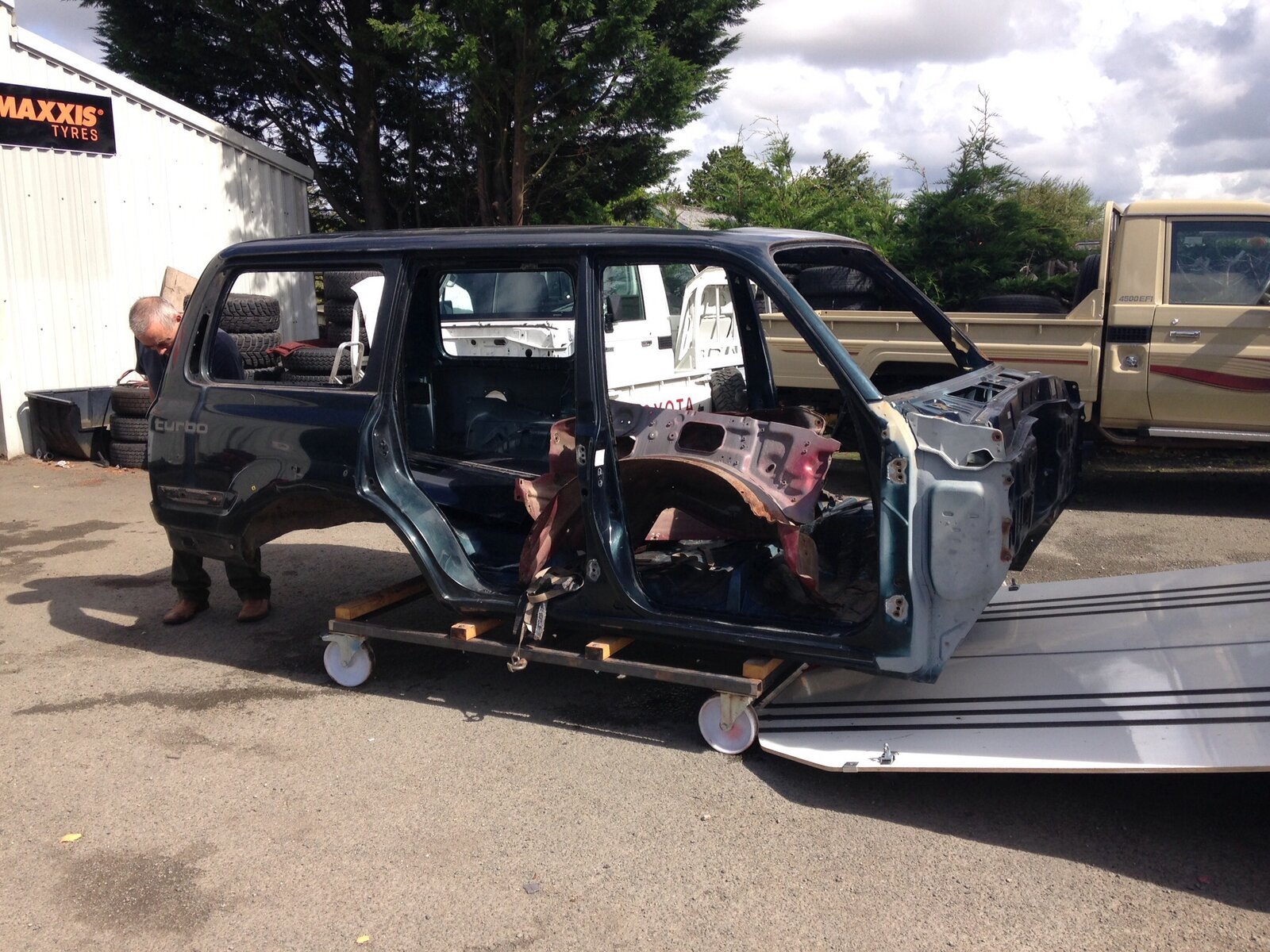

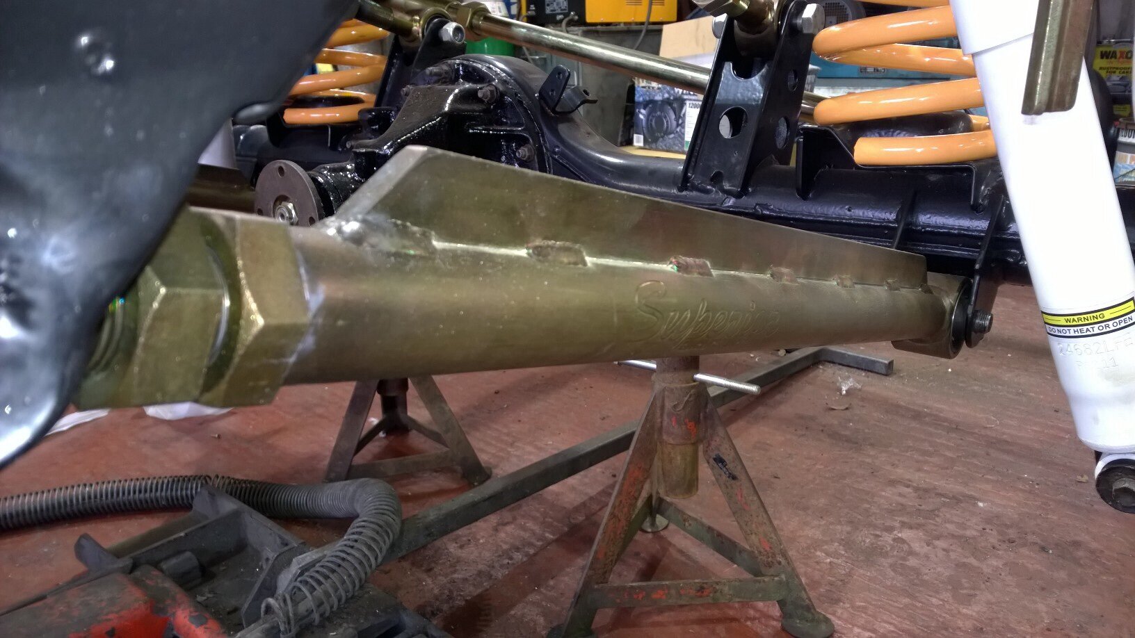

Just a bit of a build thread on a 24 valve 80 I am currently rebuilding for a customer, the end goal is to have a mint condition vehicle and prepped for over land travel,unfortunately I didn't get any picture before I started I only started taking pictures as I started on the rebuild, currently I am getting the chassis in to a roller,the chassis has been away and blasted then we got it galvanised and coated black,while the chassis was away the body shell was completely stripped and it then went to get acid dipped along with all the body panels,the body was in acid for a total of three weeks,we were surprised at just how good the body was after being in acid,while both the body and chassis were away I had the axels casings sand blasted, the rear went straight for powder coating while i set to on the front adding strength in to the casing,for that I used a superior engineering brace kit and a trail gear weld on diff guard, I have all the parts back now and it a starting to come together

But first, take the IM springs off, have them blasted and coated too. and the shox. If you do that now, they may not be piles of rust before the weekend.
Where are the adjustable upper control arms from?

The coating has been changed from factory on the springs and shocks, I didn't mention I work at west coast off road,they are the imported for all products from Superior engineering, the adjustable arms and castor correction arms off them are a very impressive product, I'd very much like a full rear set for my 100

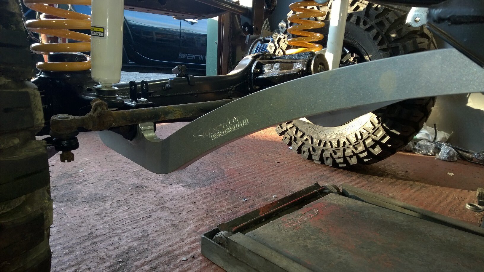

BTW, no castor correction on the front (yet), what's the plan? Thought you might have modded the castor on the axle brackets whilst it was off and being welded.
Viewing with interest.
Clive I think that are probably modified arms. They look like they have been cranked already.
Chris is correct the arms are castor corected to suit the 4" lift kit so no need to mess about cutting mounts just unbolt the old arms and bolt the new ones in, job done

Out of interest, why weren't the SE superflex arms used...?
For what the truck is going to get used for it will flex plenty so just the castor correction arms were chosen

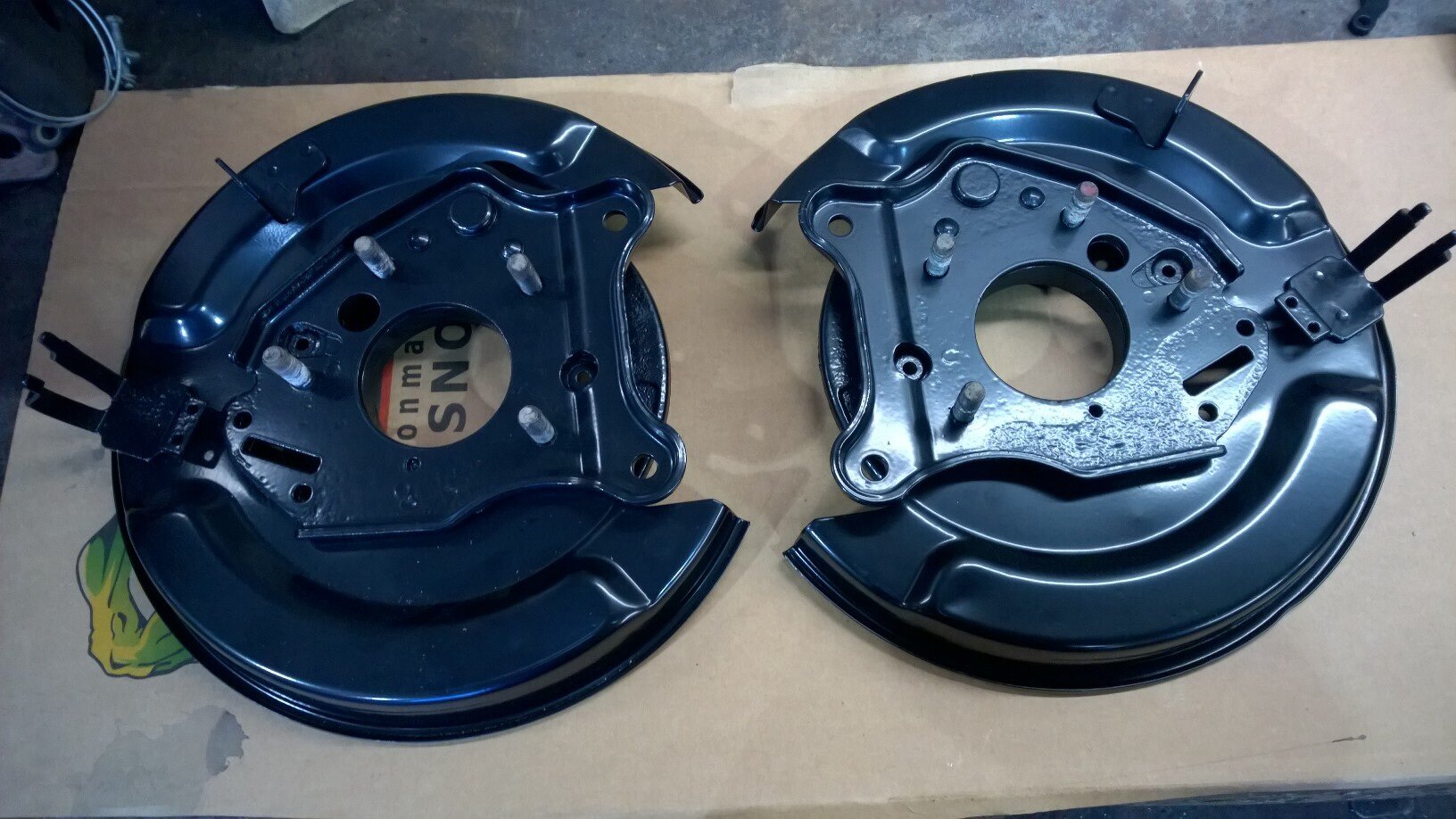

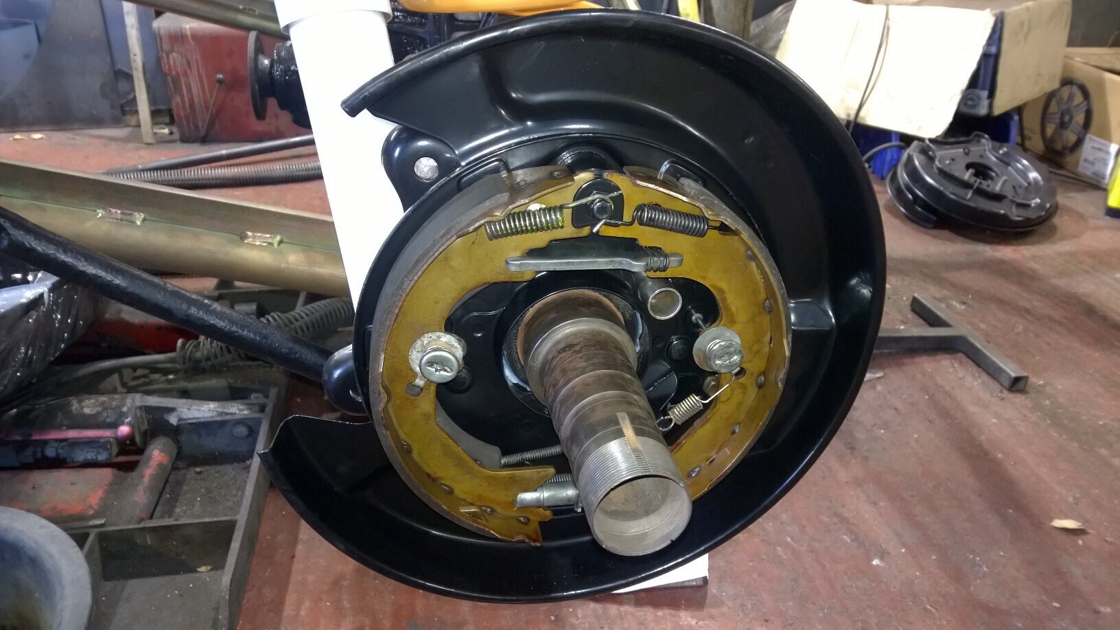

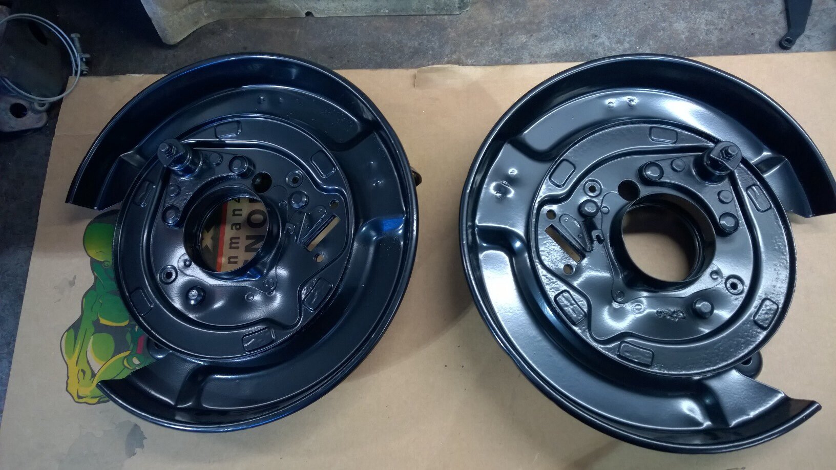

Got the rear backing plates back today but didn't have much time to spend on this project between other jobs, hopefully get it sat on all fours this week with the engine and gear box mounted image.jpgimage.jpgimage.jpg
