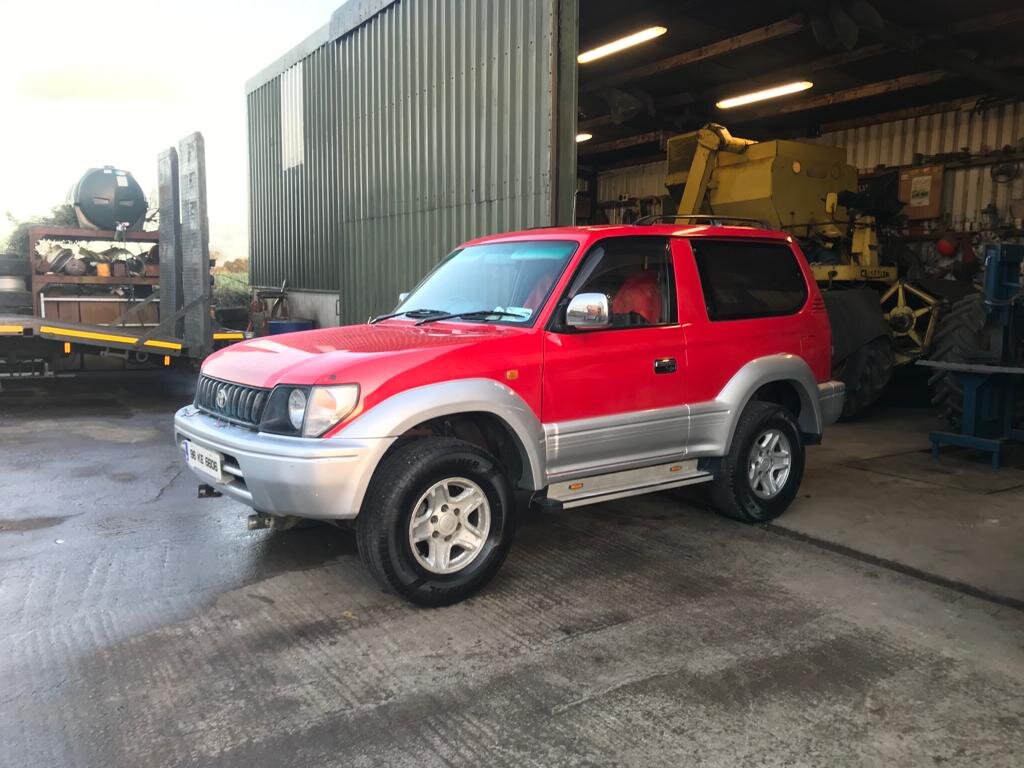

First job was to get it looking reasonable for a bit of inspiration, so a deep clean and polish was done.
Next removed the front Bull Bar and Spotlights
Removed the metal plates inside the rear windows and got them unbolted and working properly.
And a set of fresh Number Plates
