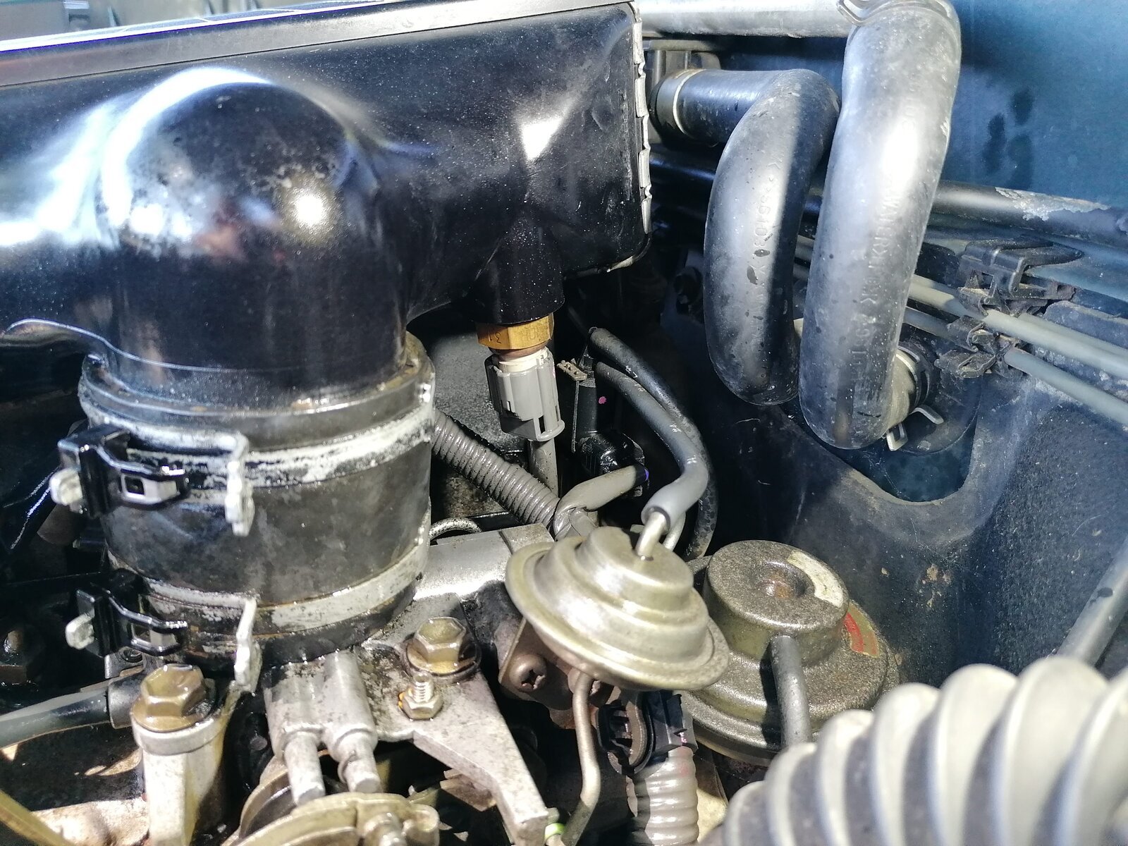

Hello Grimbo. Is this the area that the oil is showing up, at the bottom of the black pipe?
I get a bit of oil pooling up at the bottom of mine, but it's not a lot, not often, and seems only to occur when I've been doing long trips on very warm days.
I did remove the intercooler some time ago and flush out any build up of oil, so it may just be the residue still working its way out. The engine still functions extremely well, I haven't noticed any problems with the running of the car, so I haven't been overly concerned about it........... so far! :)

Hi Bert,
Yes exactly there.....although his is more than a bit oily...... I may get a new pipe and try that as the original is going soft from age and oil contamination and try that , otherwise it can only be coming from turbo oil seals as with the turbo inlet hose off the breather from the rocker cover looks to be oil free .
Hi, ok so I've had the same issue with mine. In my case it is a faulty turbo & cracked pipe causing the oil leak.
I've noticed something from the picture. It looks like one of the vacuum hoses is missing.
I would suggest you get the intercooler cleaned. Fingers crossed this will fix your problem.
In terms of the vacuum hose, someone had a diagram on here on how it all comes together, but I believe, you are missing the hose that connects to the intercooler.
