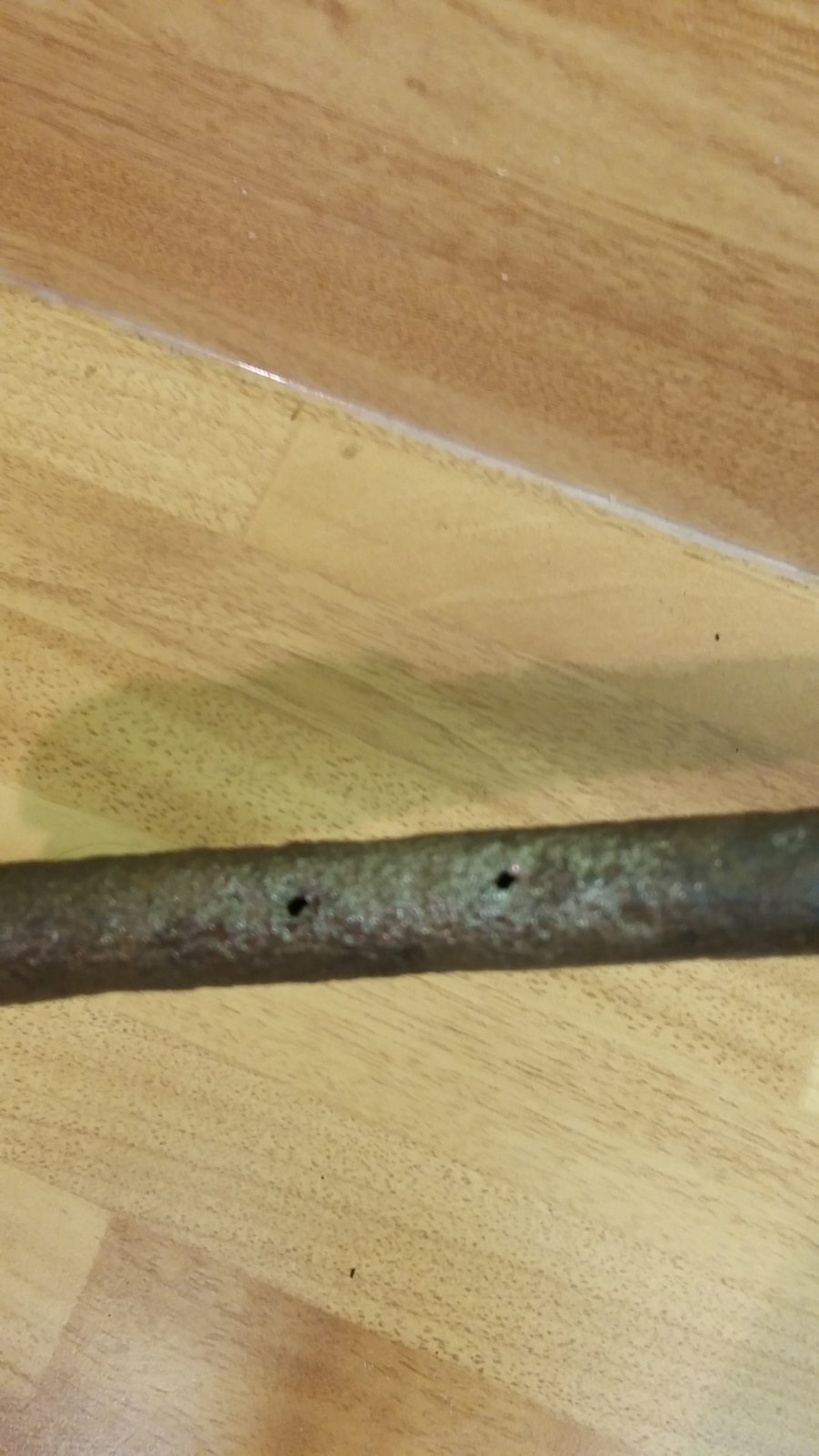

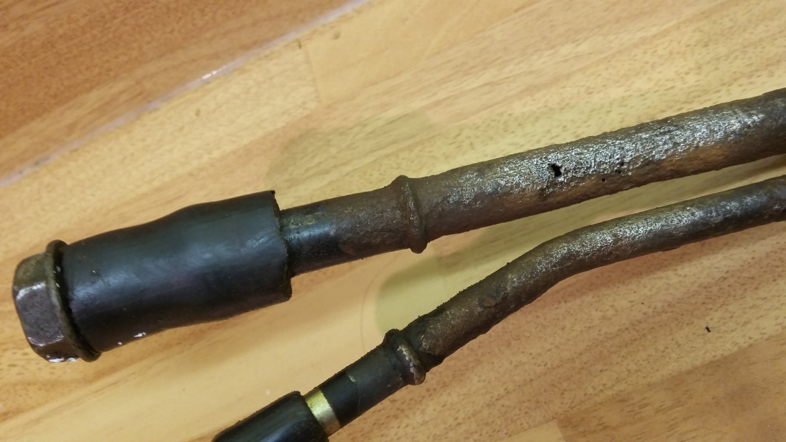

An update on the starting issue i managed to remove the tank today and yes you knowledgables on here you were spot on the feed pipe was holed and perforated as seen in the pics i intend to cut the offending bit out and replace with fuel hose really do hope this is the end of my starting problems watch this space:?
Wow! That's a helluva hole(s). Well done on persevering and finding the problem.
Thanks Dave the holes weren't as big when covered in rust but showed themselves after a bit of wire brushing being a bit of a sceptic i do wonder if this was the actual starting problem as there were no signs of diesel around these holes surely if air was able to get in fuel was able to seep out and the area would have been damp???:?
