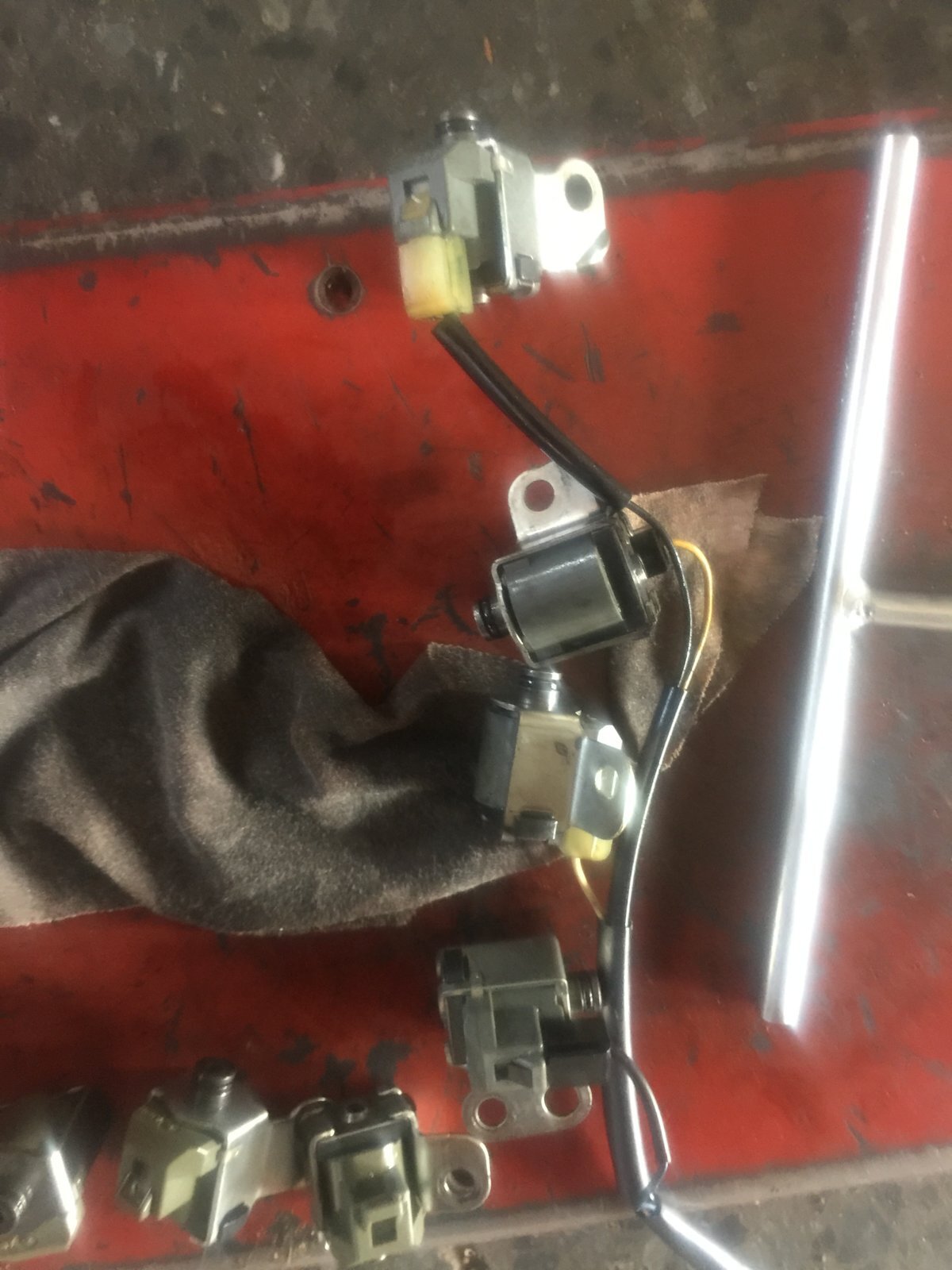

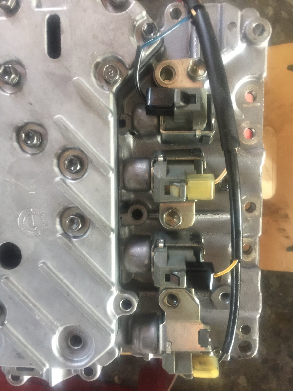

So with advise from my mechanic and "bandsnbrakes" member to look into the valve body solenoids. Upon opening the pan up took all four off and tested them with 12v current to see if they work. All had issues and and cleaning blowing air were deemed shot!!
So with the grace of God my mechanic had a used a442f transmission in bits. Took the valve body and cleaned and tested his 4
solenoids. All good with 13.5v current so upon fitting was back on the road with a smile.
