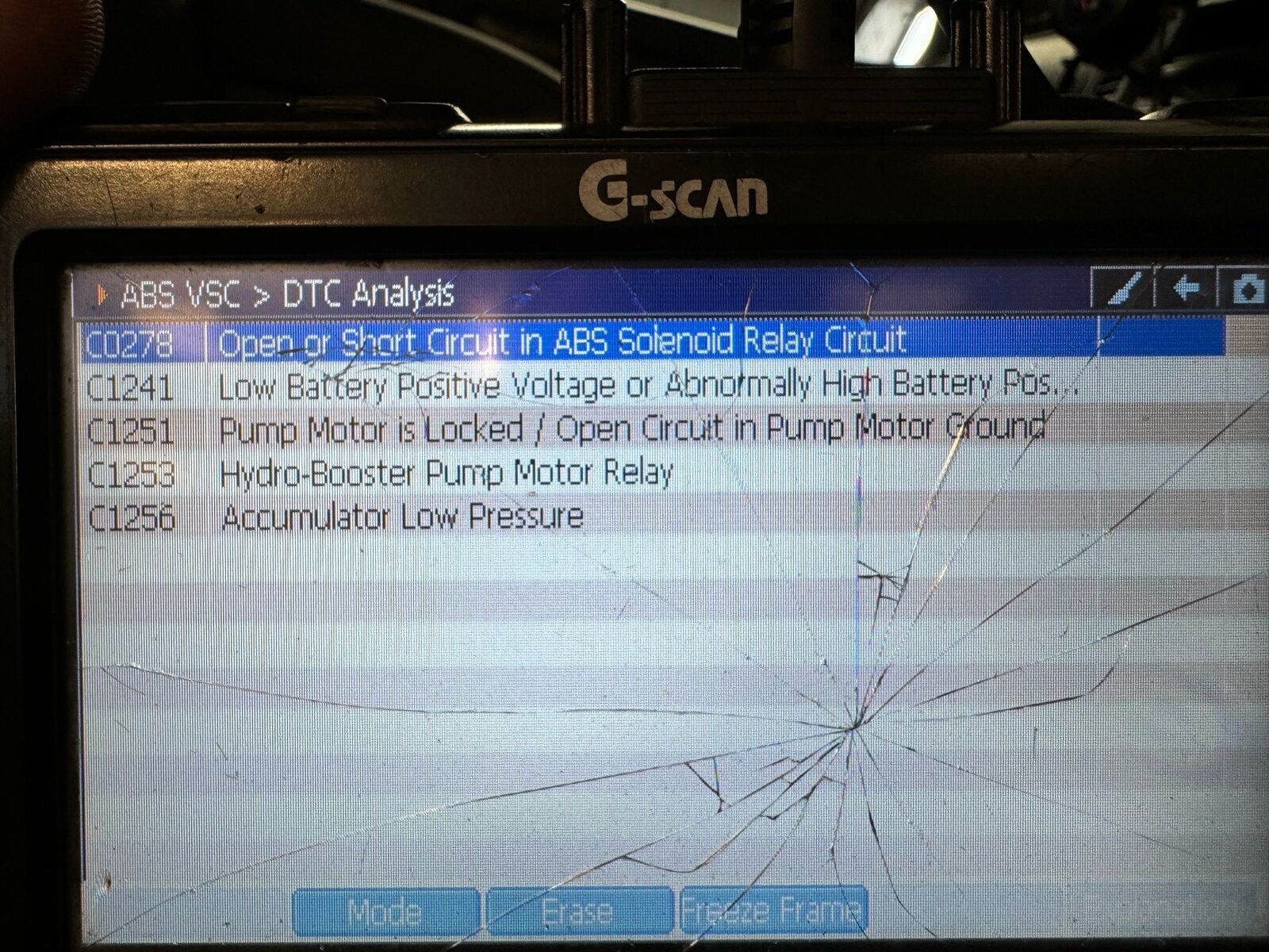

Straight to garage, with Fault codes (had to use old style reader as the new ones did not pick any faults up):
-C0278: Open or Short Circuit in ABS Solenoid Relay Circuit
-C1241: Low Battery Positive Voltage or Abnormally High Battery Pos...
-C1251: Pump Motor is Locked / Open Circuit in Pump Motor Ground
-C1253: Hydro-Booster Pump Motor Relay
-C1256: Accumulator Low Pressure
Mechanic cleared codes and says to drive and see if it happens again, then might have to get the Master break cylinder rebuilt.

First thoughts:
There is nothing indicating that a brake master cylinder rebuild would help.
When you get several fault conditions like this, the problem is often on a more basic level, like grounding and power supply, or corrosion in plugs or ECUs.
I would check :
- grounding to the affected/involved parts, and to engine, alternator and batteries.
- power supply to the the same, together with relays.
- the alternator plug being loose/corroded can give all kinds of funny faults, like this one.
- Is the battery voltage good and stable.
- plug to abs controller (attached to the brake master), and connection to booster motor (corrosion).
Tow socket is exposed and prone to corrode internally .
