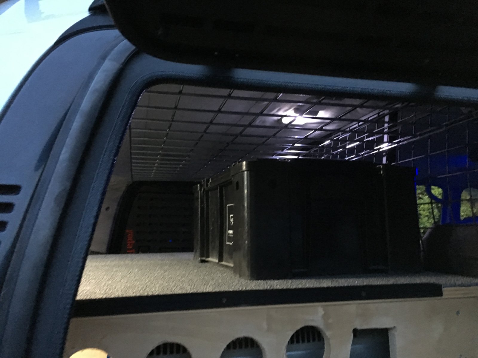

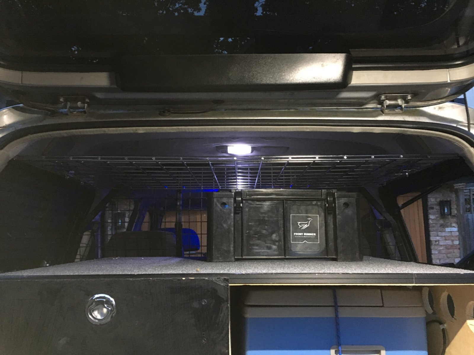

So thought I would add this mod before going camping next weekend, ordered some 4x2 shelf mesh, and picked up some 30mm x 50mm x 1 meter angle from B&Q and some wiring clamps.
Removed the 3rd row grab handles to fix the angle to.
Think the 2 foot width is to much, and will have to cut it back by 6 inches.
clothes bags will slide in under and then all the other stuff will go on the shelf, well that's the plan
