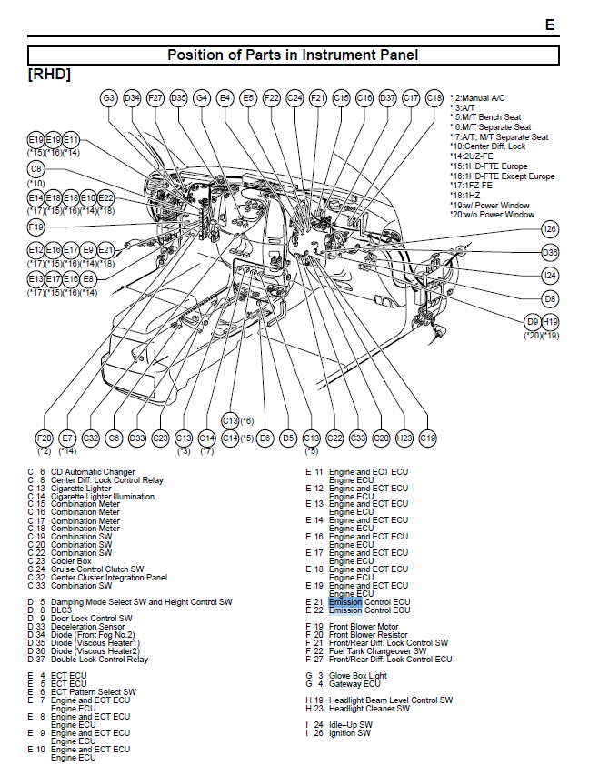

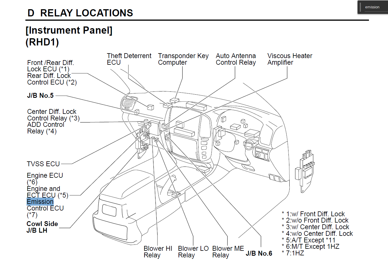

Ben, this may or may not be relevant, late 2002 an environmental mod was made to these vehicles (In Australia) , throwing a lot of the wiring out of whack compared to pre 02 wiring diagrams. There was a exhaust gas recirculation (EGR) installed along with some supporting sensors and a control unit. I believe its called the emission control unit (ECU) not engine control unit. Since this was the only bit of "smarts" the vehicle has and the dash didn't natively have a check engine light the glow plug light was repurposed as the check engine light" Youe glow plug light will act as normal when you first turn on the ignition but also can turn on when the car is running to signal an issue with the ECU.
more importantly many signals were parsed through this ecu. However The vehicle with run without it. (possibly with a glow plug light on) I can tell you with certain if you unplug one of the harnesses of the ECU you will loose your taco and oil pressure gauges however all other gauges will work. The unit is a silver box behind the glovebox.
Fantastic @shane11r will see if indeed this mod is installed and implicated. Thanks very much for explaining it and sharing.

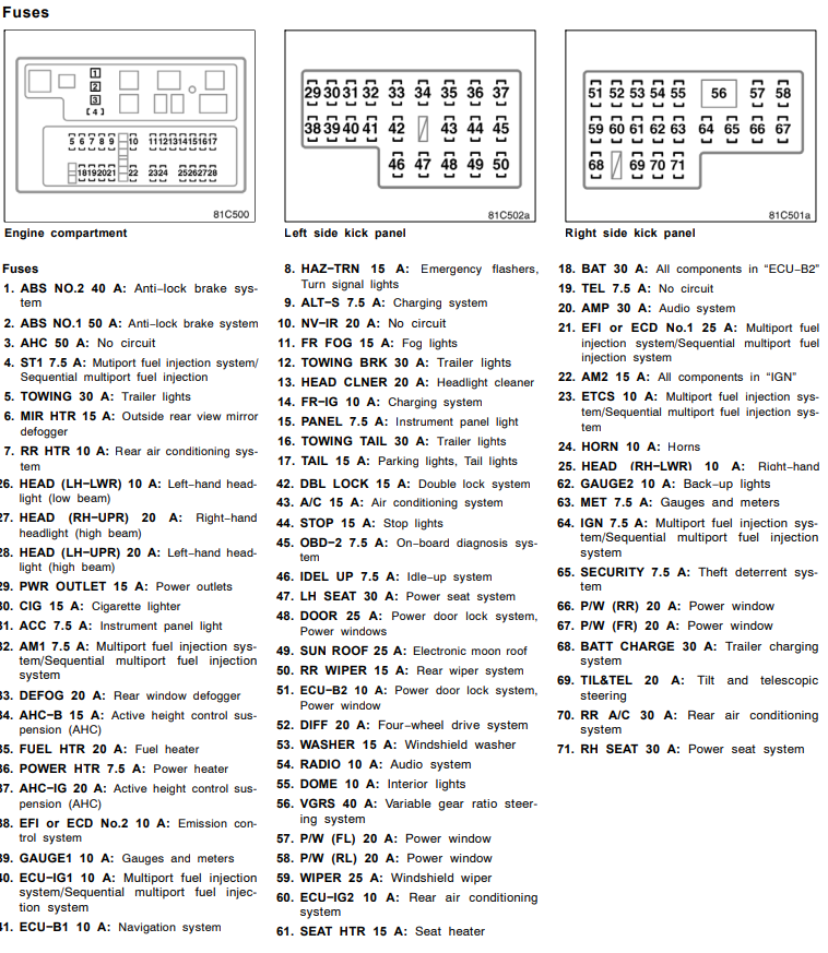

I amalgamated the most accurate fuse data i could find into one image file
you can see here location of the ECU
