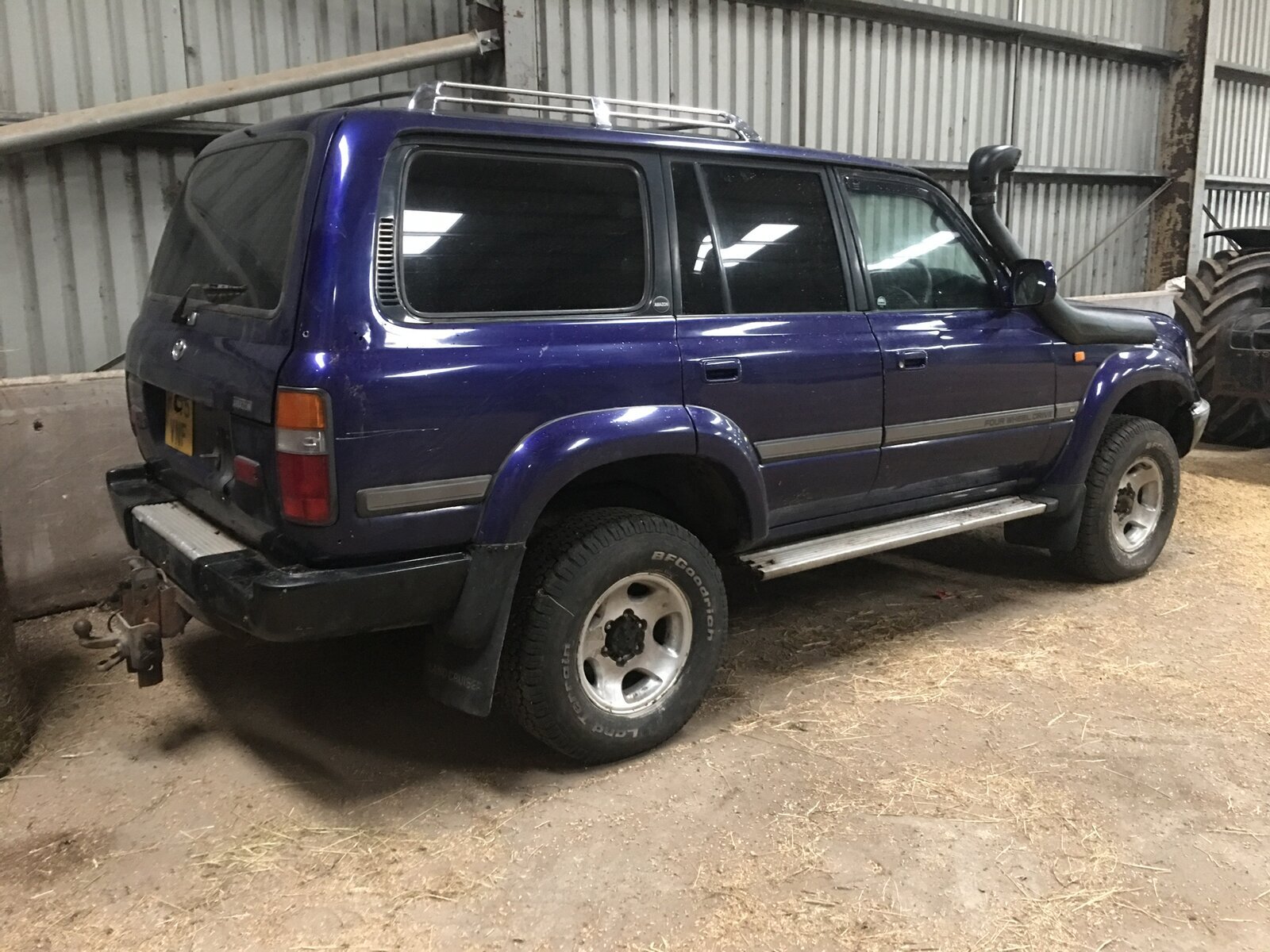

She is a 91. There is the older 4 spoke wheels on it at the min, think they are 15s but really don’t like them!

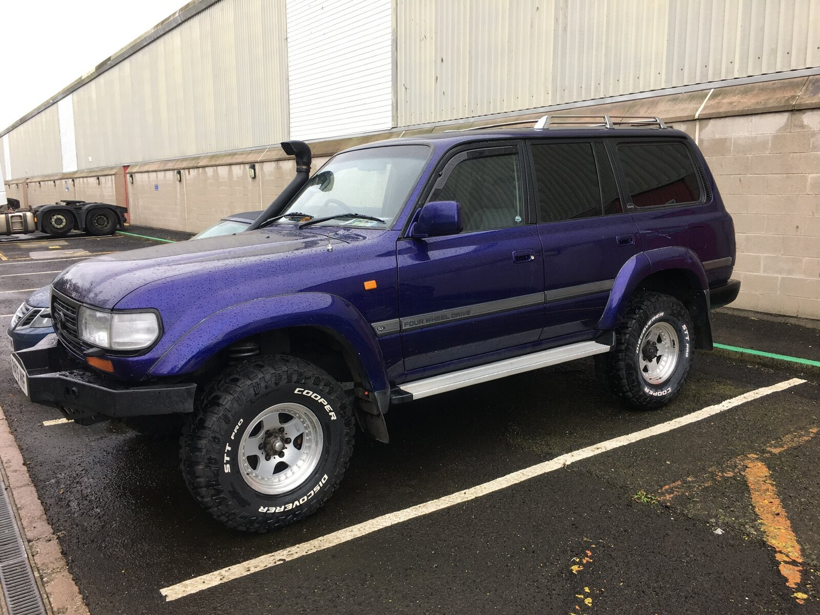

Class lookin rig :rolleyes:. Hopefully some day I might get mine to that spec!
Cheers, its solid and most things work, air con, both diff locks, etc. Photos flatter though, its had numerous repairs to the bodywork and there are areas of filler where its been dinted in the past. That said, its the second best one I've owned.

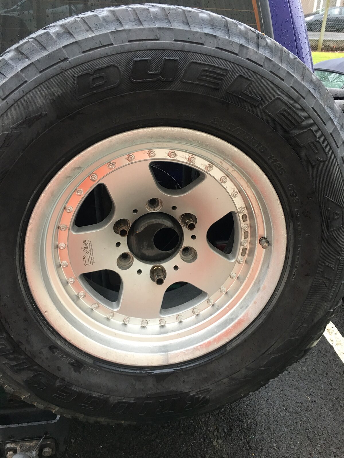

I’ve got a few sets of 16”wheels for the 80 for sale, 1 set of 4 oem wheels, 1 set of 5 and 1 set of 4 jap import 5 spokes. The set of 5 wheels is fairly decent but the other 2 sets would need a refurb!
Ya I’m on my first one and am in the middle of a body off ground up build, chassis has been repaired and is ready for blasting, body has had the sills repaired arches repaired, inner front wings and 2 new wings, all welded no filler so far! I sometimes think Shit this isn’t worth it or what am I doing until I start up the engine and Rev it, then all is forgotten!!
I'm with Andy - stock 16s, we colour coded them, with 285/75/16s - stance is good and the truck handles well. My 80 came on 305/75/16s, I think - they were too wide and the truck handled weird. Also 285/75/16s are a common Landy size, so easy to source in the UK/Ireland.
Do you have the wheels advertised somewhere so I could see them by any chance jake?

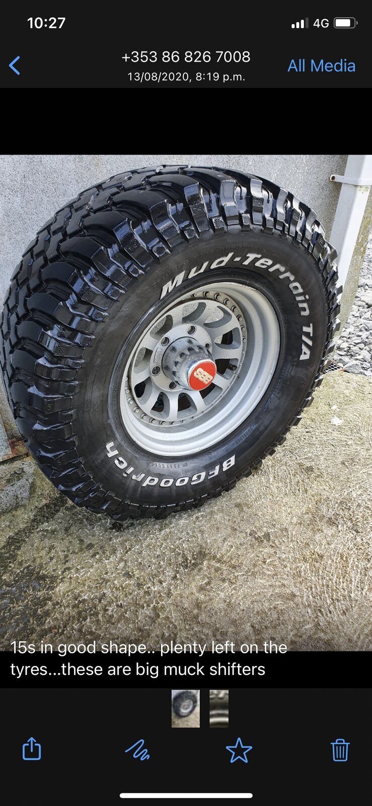

I agree Tony cool looking wheels them so i wouldn't care about 15" if the width and offset was right . And tyre size of course .
