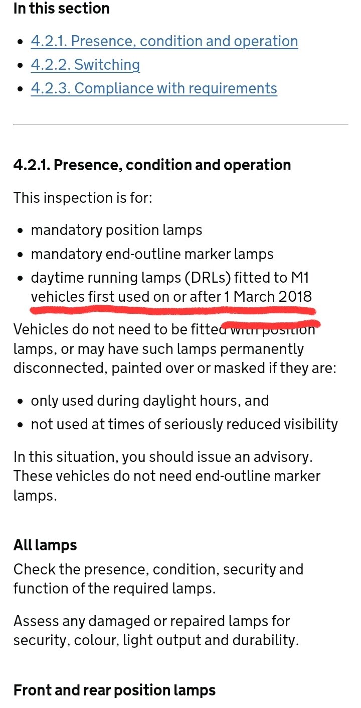

As above no need for drls.
That's fellas. The MOT guy said I needed some daytime driving lights and that he could make it look good by placing LEDs just under the headlamps. I'll double check.
He also said that he can make my front side amber lights into turn signals, so no need to add additional side lighting. Finally, he said that he can make one of my reversing lights into a fog light. He's trying to preserve the look of the vehicle. We'll see how it goes!
