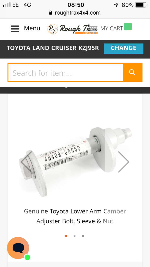

I’m having to replace my inner tie rods but the shop wants me to purchase the camber caster bolts before they work on it. Can anyone tell me what cross reference camber caster set I can order? Thank you in advance.
Hello Andrew - I don’t believe there is any link between replacing inner tie rods and the need to replace the camber bolts. New tie rod ends only affect the toe-in/ toe-out dimension, which is adjusted using the outer tie rods.
If you really do need to replace the camber bolts for some other issue, they are available from Roughtrax- see picture for Toyota part number. You’ll need 4 of them - 2 for each lower wishbone, but be sure you really need them. Fitting them can be a real pain.

The shop I went to is replacing the lower control arm bushings, rack and pinion bushings, and the inner tie rods. Once that’s all done they’ll have to do an alignment and he is assuming they will be seized up so he recommended replacing them. I found those part numbers but when I went to my local Toyota dealership they weren’t coming up in their system
