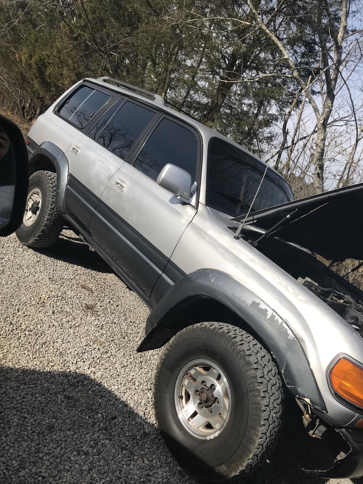

    hello everyone,
    I just picked up a 92 FJ80 and she is a little on the rough side but side runs and drives like a tank. The issue i noticed is when the truck is cold starting it can be a little challenging it definitely has some hesitation. Also I noticed it has a little bit of a rough idle not too bad but you can tell its not normal especially for a yota. Any thoughts on what the issues are? Any feedback will be much appreciated.

    Welcome to our group. We love pictures and demand at least 1 every post!! Lets see the beast.
