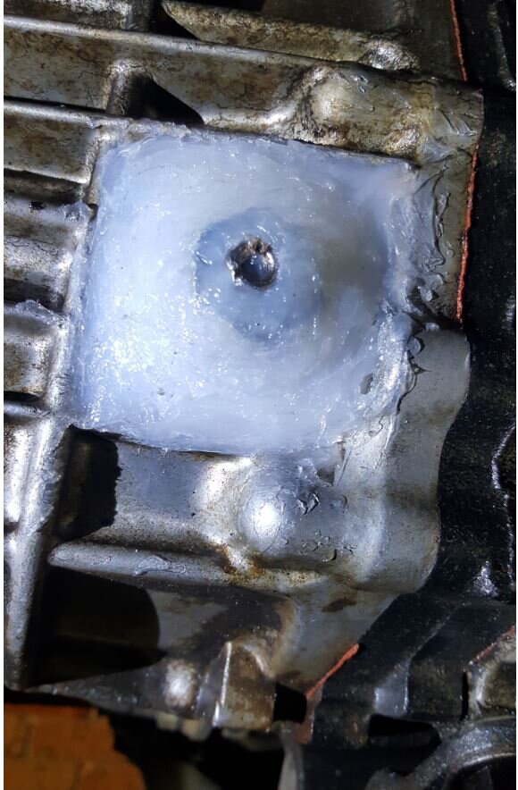

Returning to Toyota parts quality. I am not a monster, rather a small frame. I did not use any extender of a breaking bar. After changing oils yesterday I went under the vehicle to inspect for leaks. The gearbox fill hole was showing some oil. It was problemmatic before as well. So I was tightrning the plug and suddenly it went much easier. I reached for a stronger glasses and to my horror there is a crack. I have to say I reused the bottom plug to plug that hole because the plug that was there had the head pretty damaged, but otherwise they looked identical.
I think the vehicle is still driveable, I will put silicon over that, but any suggestion apart from a new gearbox installation? The vehicle is close to 400,000km.

Thank you Shayne, epoxy did not cross my mind :) If Selleys does not hold, will try that. Otherwise in 4 years I will remove the plug, drill a 5mm hole in it, cut 6mm thread in it and silicon of glue it back. 6mm hole should be enough for my Chinese oil pump to fill the gearbox.
