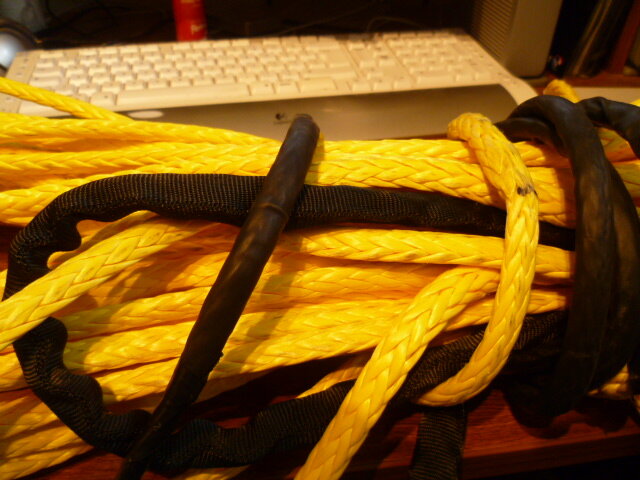

OK OK. Well after a disastrous off road session this weekend, I decided it was time for an infusion of new plasma. I went to Winch It, Chris Plumb who was mightily helpful in accommodating my needs. 25 hours later, I had a box of goodies on my hall.
Safety yellow.

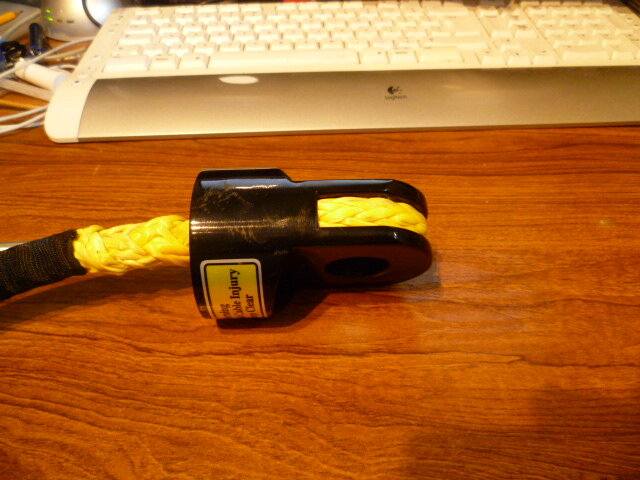

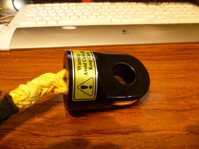

Now instead of hook (supplied) I decided to follow JW's lead and go for something a little different. A thimble

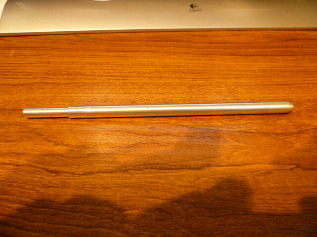

I machined up a fid to spice the rope and set too.
Half an hour later and the mainbrace was well and truly spliced. Proper job. And a rock guard duly slipped over.
The rope comes with a rock guard on the tail end and sort of shrink tube on the hook end. I don't think the shrink is very tough so I reversed the rope and put the sleeve at the thimble end. Yes, better.

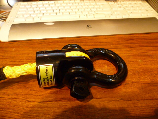

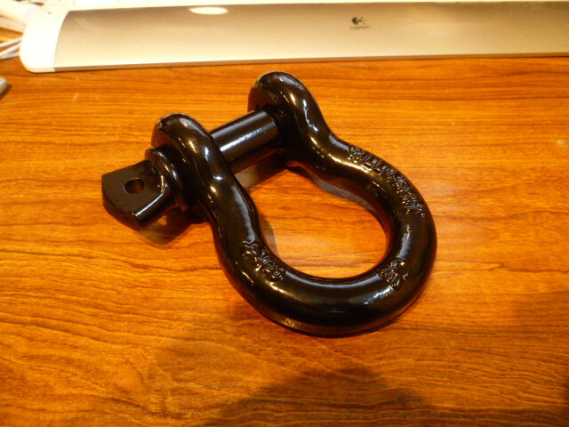

The thimble comes with a mighty shackle. I bought 2 additional ones as I had bust one up on Sunday.
Whaddya mean why? Oh you must be new to the forum I guess.

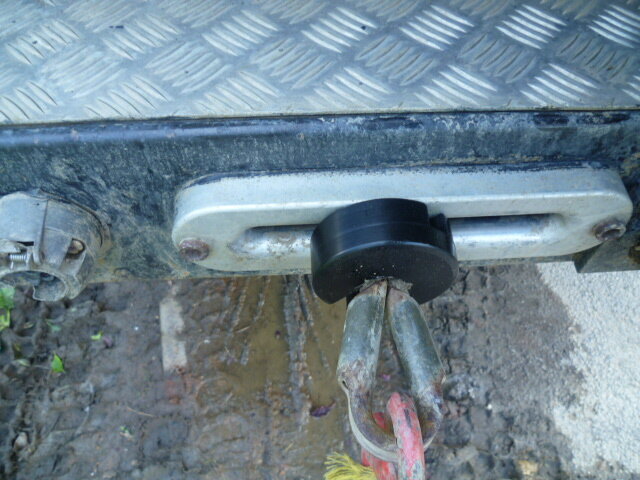

Essentially, I will not have the shackle in there all the time so all that will be showing is the thimble sticking out of the hawse. Nice and tidy. No hook to stow, no jangly bits.
Like this, only different obviously.

What's the rating on the shackle Chris? I tried to enlarge the photo, but apart from seeing "made in China" I couldn't see a rating (joke!).
I paid a fortune for 4 of them, can't remember how much, but it was a lot. I think forgetting the price is nature's safety valve, to save you going insane (or to stop the wife finding out) works both ways.
They're 4 3/4 tonnes Clive. £4.99 each. Bargain. Seem nicely made not simply stamped out of an old Russian tank turret.

CJ, nice bit of kit, but if that shackle fails, thats one hellva missile coming your way no?

Well the only way to avoid any missile really Lazz is to have a loop knotted in the end of your rope. Plasma (or synthetic) has very very little energy stored in it. I have seen them fail and the loose end barely has enough energy to knock your coffee over. The more wieght you have on the line the faster it dies. But you have a massive steel hook on the end of every rope and all I have done is replace that with a shackle. Given that most of the time that you are winching, you have a shackle on the end of what ever you fasten the hook to - in effect I have done away with the hook! If the rope fails, the tethered end (with the hook on) doesn't go anywhere. It's the loose end that whips.
The thimble on there is actually alloy too it's not steel. It's very safe. I have done a lot of winching and I trust this set up a great deal. You should see a steel rope snap!
Splicing plasma when new is soooo easy. There's no potential for damage to it.
Sorry, shuld have said - shackle failure? Never seen it. Not een in industry where we were lifting 30t drop weights. The pin is 22mm thick.
