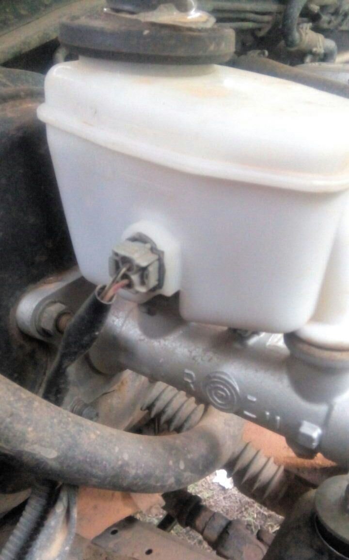

I managed to get by with the front caliper. The load sensing valve needed assembling correctly to get it to function. The master cylinder ended up in the bin. As the master cyl was replicating the problem that I had before fitting, I was convinced it wasn't that and had to be something else in the braking system. But, after a lot of head scratching I decided it was a faulty item and replaced it with genuine.... this sorted my issue.thanks Paul, some things best bought from dealership but some parts must achieve quality standards its a case of finding them, £470 for a master cylinder without trying to find a cheaper alternative is as reckless and buying one for £35 from ECP .. did you get by with those items you had substandard or bin them?
