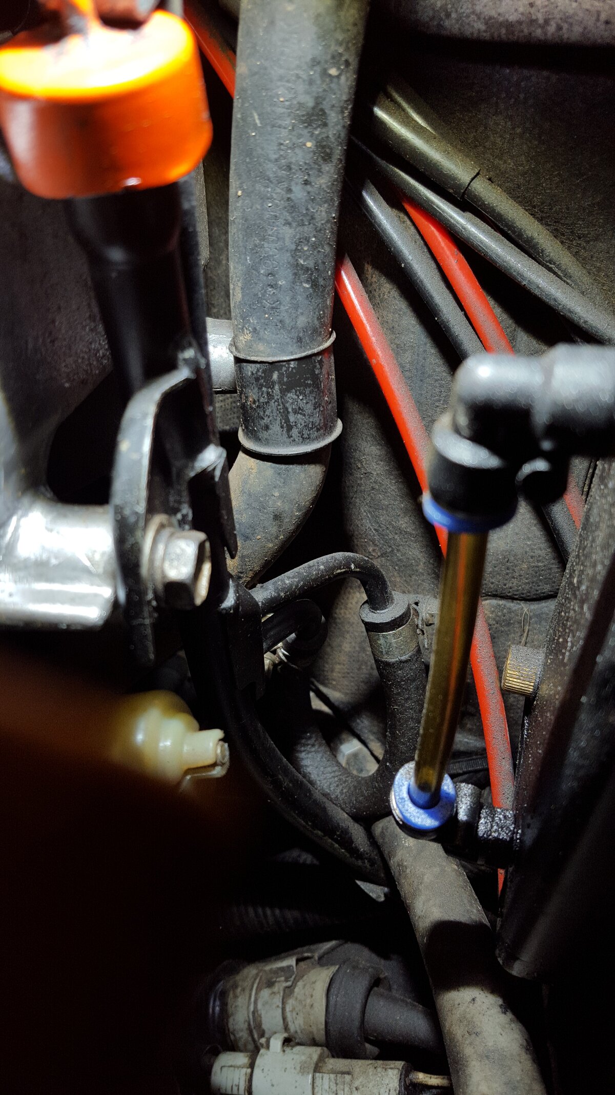

One is the auto box the other is the transfer box iirc and they are open no flapper valve or anything like that to stop the water getting in. The other potential point of entry is if the o-ring where the dipstick shaft fits into the oil pan isn't very good or the seal on the dipstick itself.Are the auto gearbox breathers the pair of pipes that appear on the side of the gearbox dipstick?
