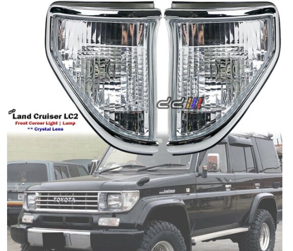

I removed the original 1157 amber bulbs and replaced with LED version in the front corner light assemblies quite a while ago. These are not to be confused with the lower rectangle lamps that are your turn signals/blinkers (see image). I want to go back to the regular bulb but can't remember if they flash or not. I'm assuming they would since it takes a two filament bulb like the 1157, one for park lights and the other for turn signal. I did swap back to the original two filament bulb and no flashing/blinking. These are supposed to blink correct? Maybe I fried something by installing the LED version? Thx!

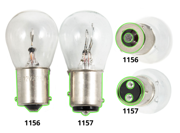

Mine is a 1994 LC Prado import. KZJ78. It definitely takes the 1157 with the offset pins. I threw in those LED's and found myself asking, "Wait, didn't those blink before?", then researched a bit more and found the LED and flasher issues since they need a Canbus or resister. Of course a year+ has gone by now. I did throw in the original two filament bulbs and no flash and no 4 ways/hazards but park lights work as should. All other lamps work as should: lower front blinkers, fender side turns, taillights. Stumped. Keep the puns coming.

Quite how it worked, I don't know, as I would've thought if the 2nd light filament was drawing power from indicators, that would flash too. From memory, I just put single filament clear with offset pins as normal in, to have brighter sidelight/parking lights.
Maurer, trying to work out why you think those lights would flash as indicators, when you have them in the lower amber rectangle as mine for indicators, + as Tel says, the liitle repeater on side wing. Odd, isn't it ?
