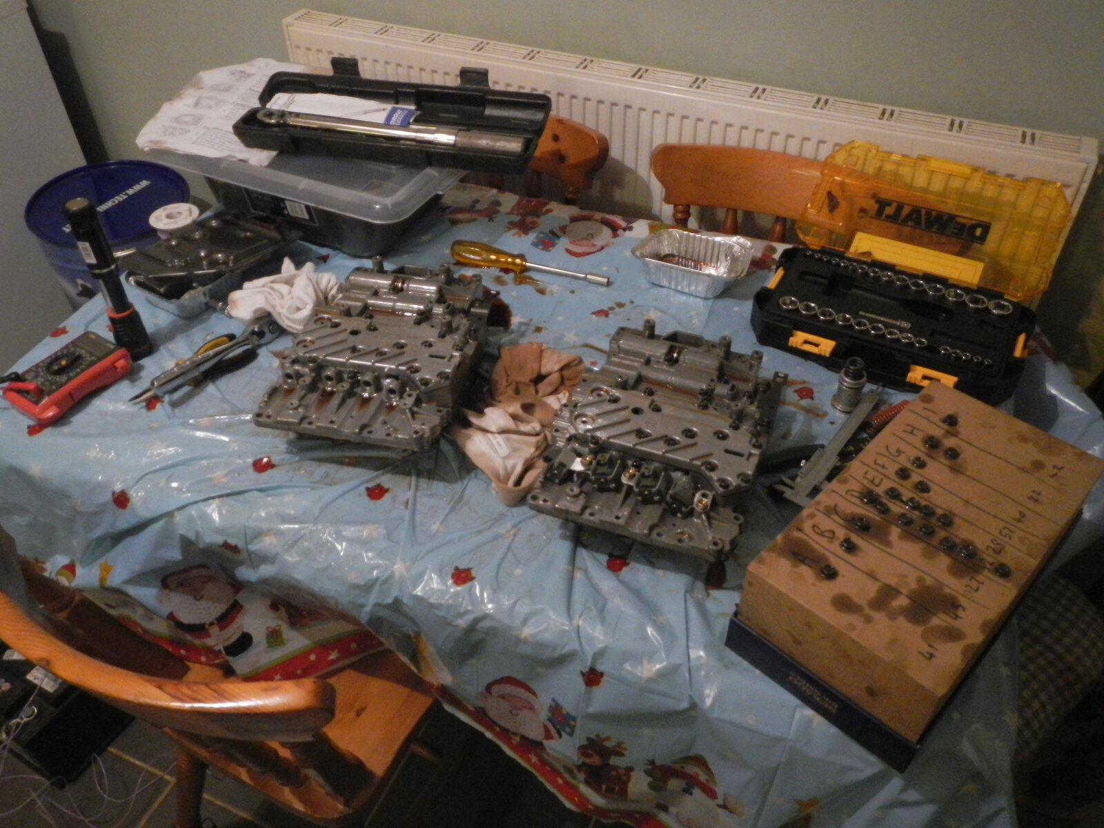

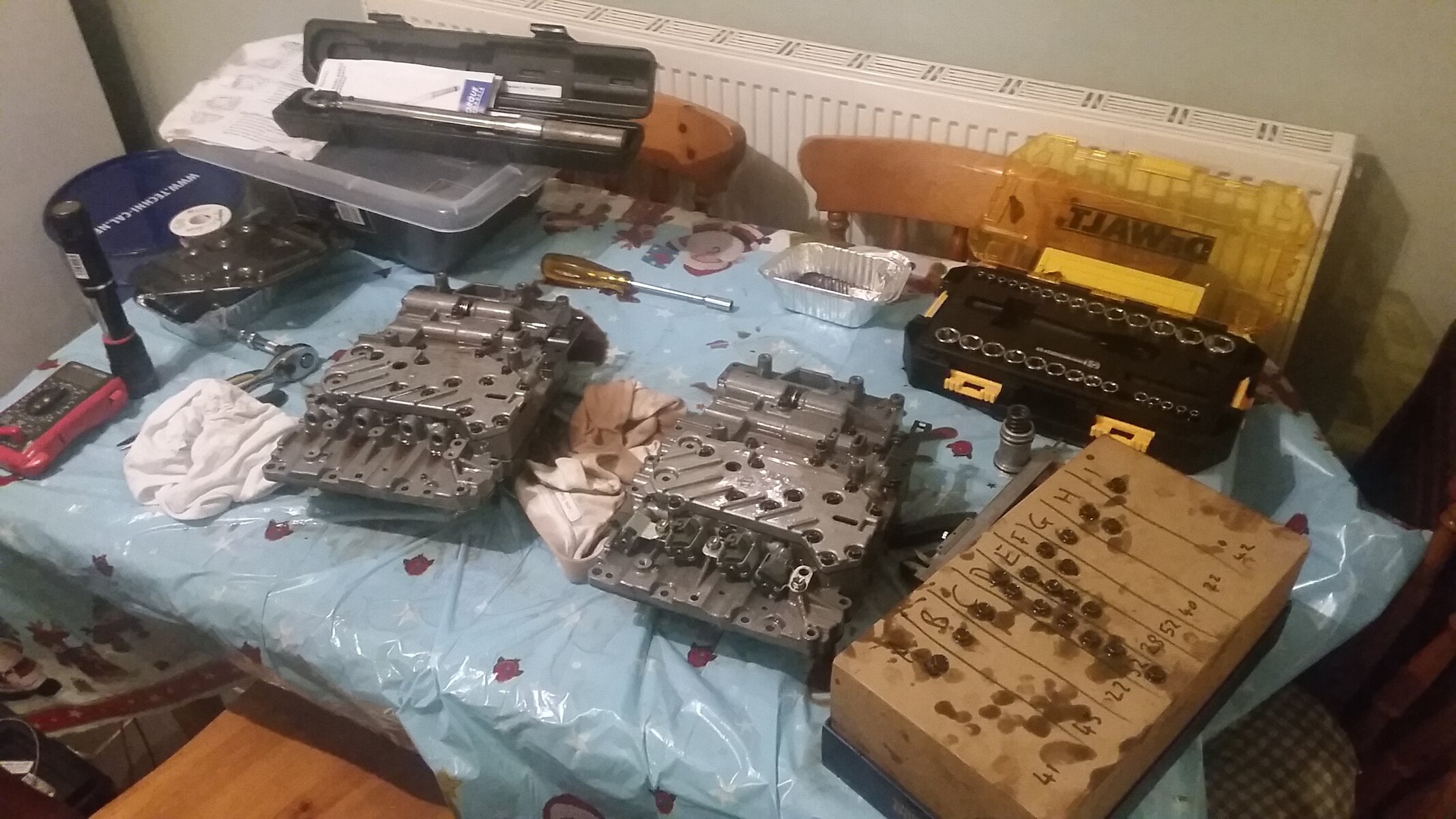

Just fitted the Nomad valve body kit from wholesale automatics on the 80 series 12 valve and on first test seemed to be working great. Smoother through the gears and even making the truck feel like it has a lot more power.
