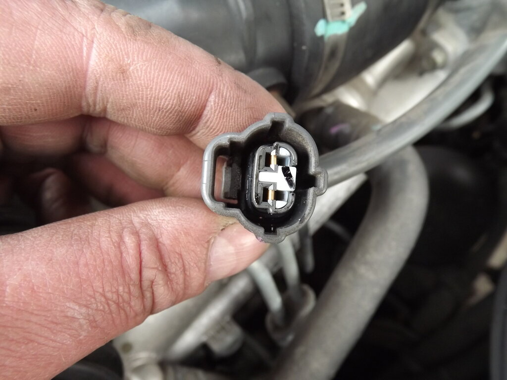

Has anyone got access to a broken collie ? i need some wiring .
Even Simon Holton couldn't find a matching plug in mrT's own catalogue , would have to buy the whole loom just to get a single plug . I had pretty much decided to do as you say using bullet connectors and silicone but it occurred to me that during my web search i had seen other Toyota sensors with a brass screw fitting and a female connector that might accept the plug we have . It was 5pm by then but i passed this on to Simon and he confirmed receipt by requesting a pic of my plug so maybe tomorrow he will have some luck .

Despite his best efforts which are very much appreciated Simon Holton cannot find the required connection so not much hope now .
It's 2 pin Iwan but thanks for the thought if I had a local scrapyard to mooch around I'm sure I would find something that would fit .

Think this is it just need to find a UK seller 90980-11062
In the end I just decided to buy it and try it but I can confirm 90980-11062 fits !
Its its not the right plug and comes without any internal pins but it is a very tight fit on the sensor so run your wires through the holes and jam in on and jobs a goodun . 8 quid from Simon Holton :thumbup:
So just for reference, can you confirm does it fit, or have you forced it?
The sensor pins are seperated by maybe half a mm to much and have left a slight groove in the recieving plastic slots , the connector itself is tight but the right shape and is let down only by its retaining clip which cannot catch .
I'm wondering now if it could catch if I drilled a hole in the connectors clip , I had to put the sensor back on as I will be out for the day . I will post some pics when I get a proper computer .
Well it's fitted and no evil lights on the dash , there might be a bit more go in the truck but it's getting hard to tell so we will see what the Mrs says next time she steals it , personally I think the benefit of this will show more in improved fuel consumption but only time will tell . I don't think I mentioned moving the pressure sensor up to the intercooler seems to have given me another 3mpg up from 20mpg last time I worked it out .
