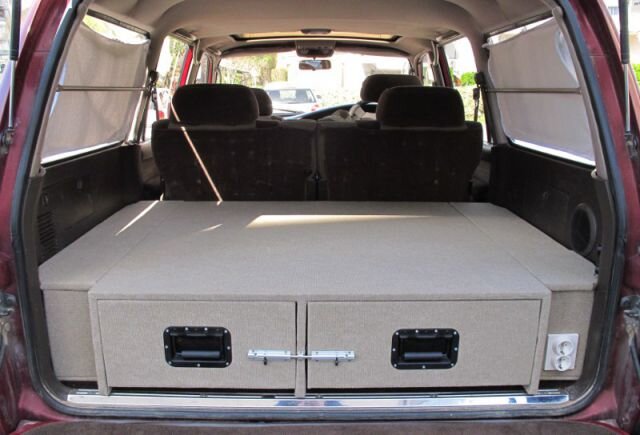

We started with the rear drawers.

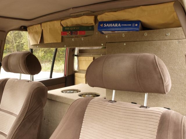

Loking back from the front seats, there is a "bookshelf".

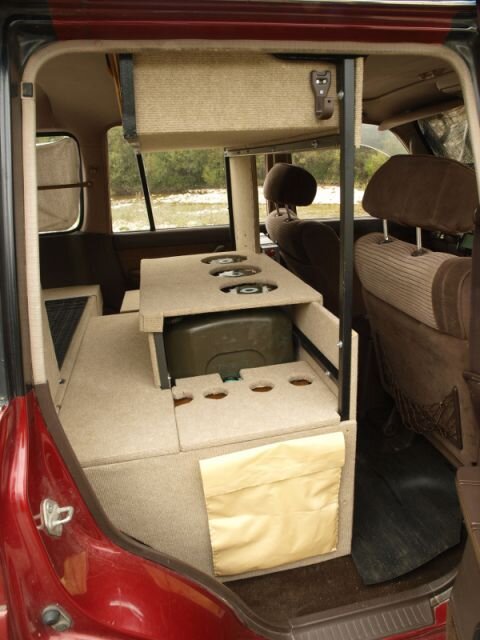

Looking to the inside from the right side of the vehicle. In the middle are water containers (ex-military 3 x 20 L, hard plastic but the same dimensions as jerry cans). They are removable but they can be filled or emptied in situ (by means of the electrical pump and hand pump). The boxes around are for storage of spare parts, tools, etc.

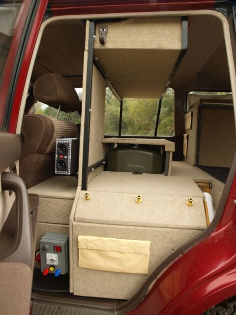

Looking at the inside from the left side, we see a box for additional battery, the battery controller (display of present voltage, plug-ins for 12V pump, electrical sun collectors etc). There is another 22L water container with electrical pump and the three water hose plugs (filter in, filter out and water from 22L container - mainly for shower).

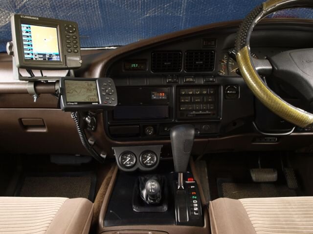

The dashboard has three additional gauges (EGT, ATF temp and engine oil temp) plus fixed large display GPS plotter and also the portable GPS plotter.
