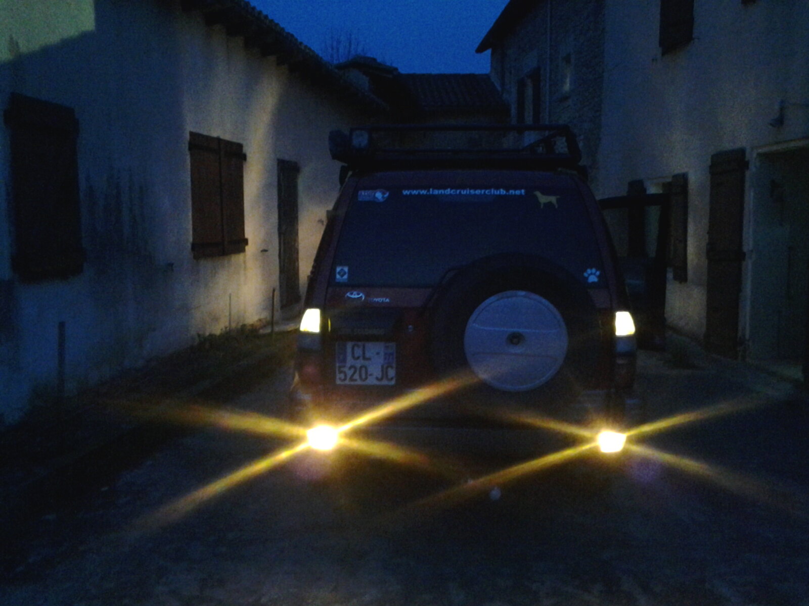

Hi everyone. I ordered some LED lamps and lamp holders from tinternet with the intention of turning my rear light clusters from just reversing light (l/h side) and fog light (r/h side) to l & r indicators as well!

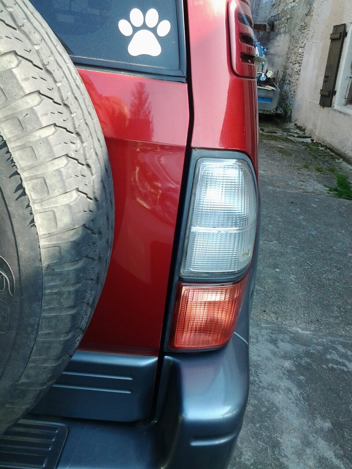

Easy peasy to do, just find the right plug (in the jack storage area) tap in your lights, run a cable to t'other side, and roberts your uncle. I drilled 2 holes in the top lense (clear on my 2000 Colly) and put 2 yellow LED lamps in each. Not super bright in daylight, but in evening and night time pretty good.
Taken with my Samsung, so not too bad
