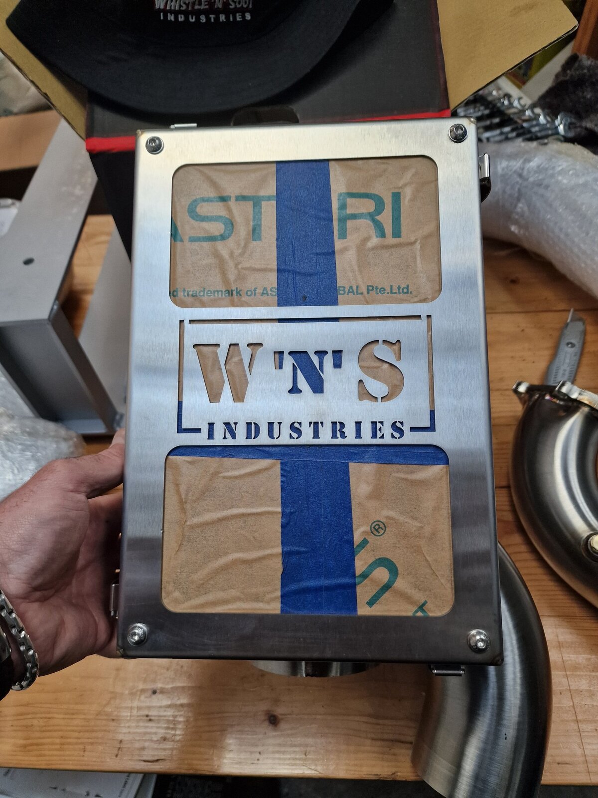

All packages have been opened up and a quick review of plan of attack done!
Might as well swap out rad top and bottom hoses while doing this all so be on the hunt for them in UK after this post.
Must say the kit from Whistle and Soot is very good and comprehensive with very clear instructions provided as is intercooler kit from Legendary 4x4s in USA.
Ordered my EGT monitor now I now what thead my bung on dump pipe is.
Fist job is to clear out a space inn log store to back pick up into so I'm undercover before I start strip out.

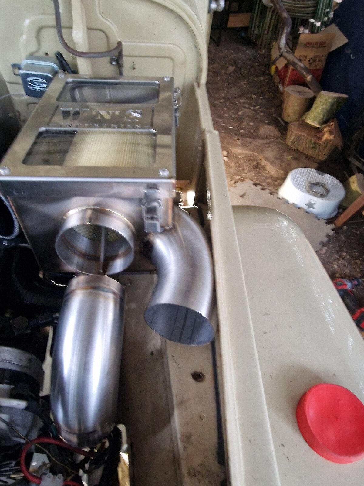

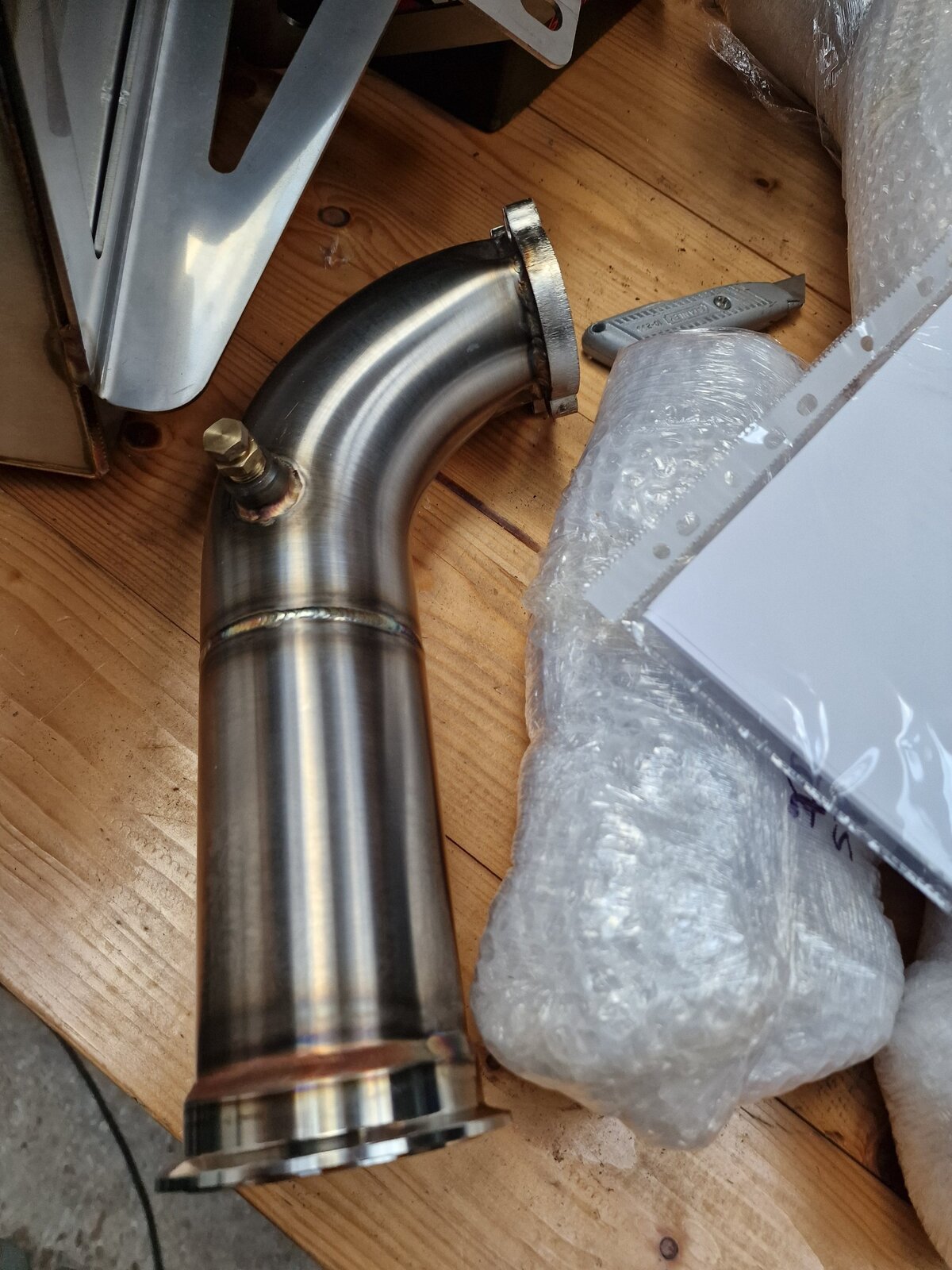

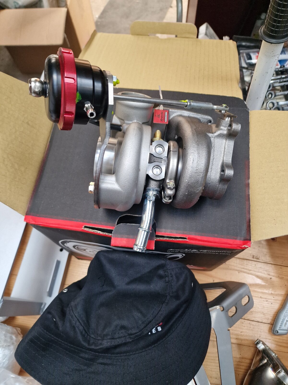

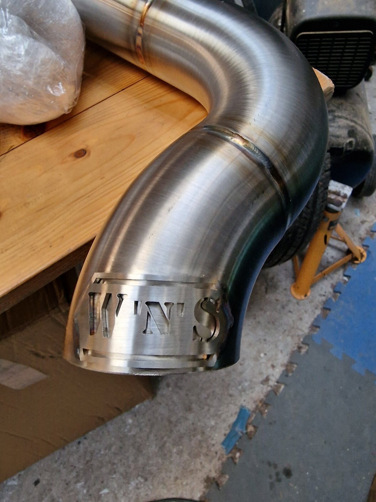

Few photos of kit attached.

Is the dump pipe the best place for an EGT sensor? The piston temperature is the concern I believe so the dump pipe will have a relationship with piston temperature but quite a bit cooler.
So establishing the relationship is key to avoid any damage. How would you know what the offset is though?
Which gauge did you go for?
It's just the easiest place to fit one, the dump had the bung ready waiting for it. It's quite early on in the flow so will be a good guide, if not as accurate as a in cylinder reading.
Used mainline sensors as theirs are very accurate and wanted the digital ready out rather than a dial.
I can build my own margin in from what gauge reads to what is going on in cylinder.
It's more just for me to know when things are getting a bit too hot for my liking and to ease off.

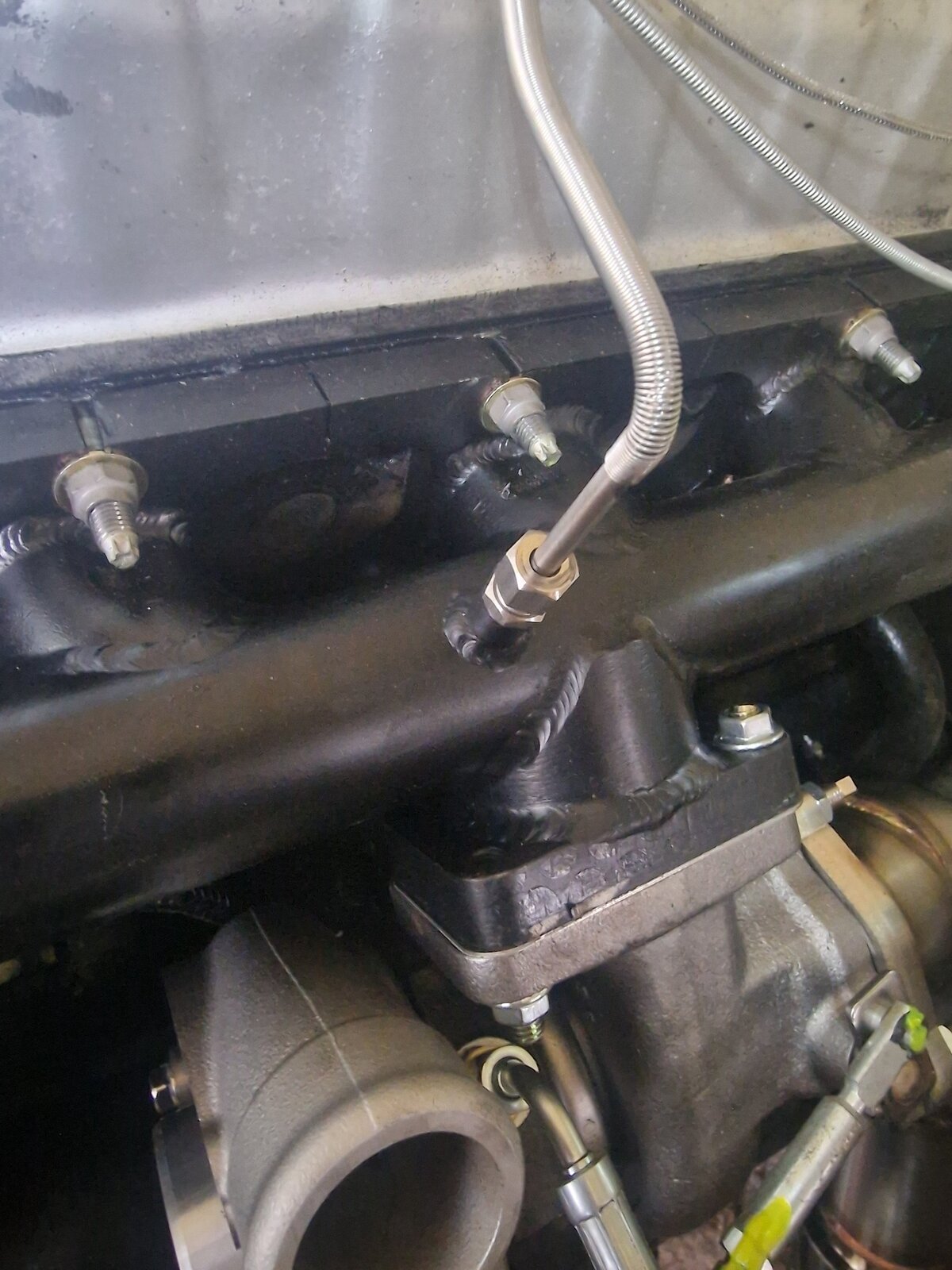

If you have the exhaust manifold off, would be much better to fit your EG sensor into that. The turbine will take out a fair bit of energy.
The readings you get wont be easily comparable to others as, mostly the sensor is pre not post turbo.
Great project and look forward to seeing it progress!
Hi Felix
Where would the sensor go? would I need to get the manifold drilled and a npt nut welded on?
David
Close to the entry into the turbo.
most egt kits will come with an NPT threaded bung, they are cone shaped so as you screw it in it naturally gets tighter.
You will have to drill and tap the correct sized hole
You could alternatively get a bung welded in, but is not easy to do on a cast iron manifold, assuming you dont have a tubular steel one?
I'll check when back workshop if it's cast. The kit does come with nut, just though easier to use one already on dump pipe!!
It's not cast its welded tube sections so that should be easy enough to drill and weld npt nut too, thanks for tip

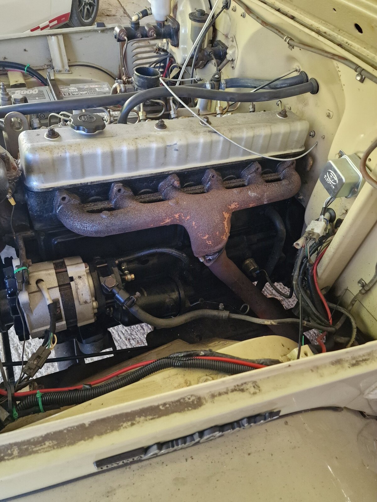

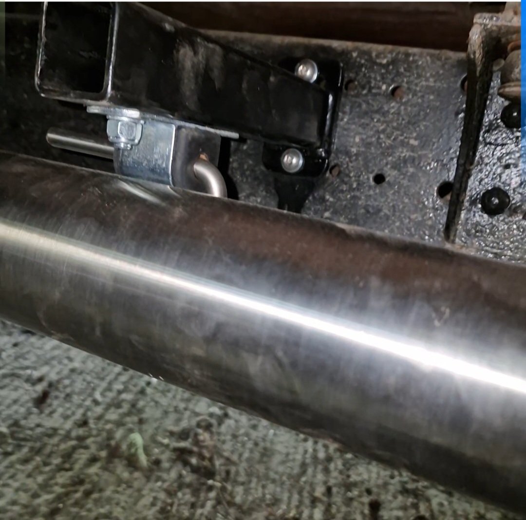

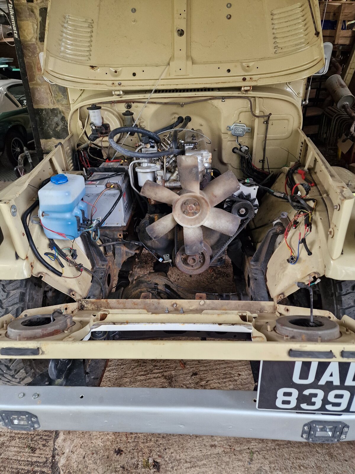

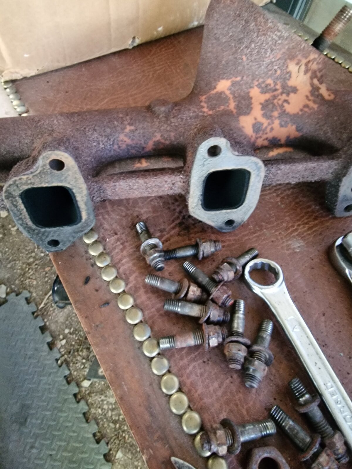

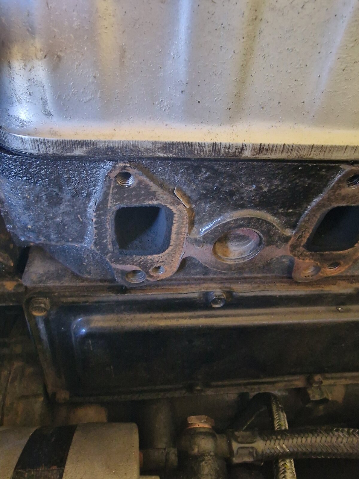

So finally made a start!
Had to clear my log store to be able to get HJ in there to work on so all winters logs are cut split and stacked.
First stage done and it reiterates how willing this vehicle is to be worked on.

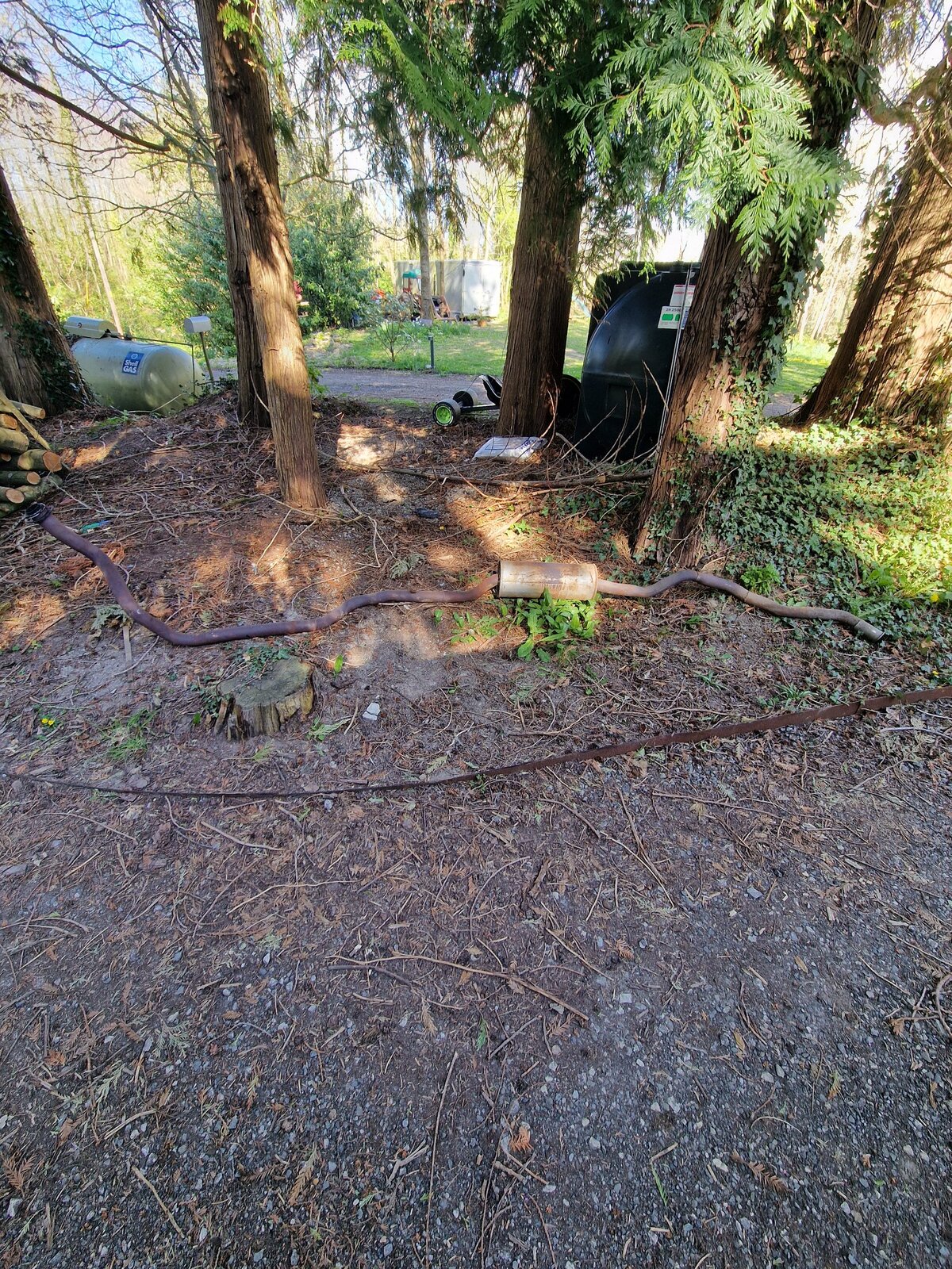

Air filter housing off, exhaust manifold off and not one siezed or snapped stud (guarantee that would be a different story if it was my lotus!). One thing I did spot is it's been running without manifold gaskets so that might explain the easy nuts as it's obviously been off before.
Hardest part of today's quick 1 hour stint was wriggling the full length exhaust out as its in 1 piece, that was fiddly.
Hoping to get a full go at it next week but couldn't resist when I found myself with a spare hour.
So far so good.
David

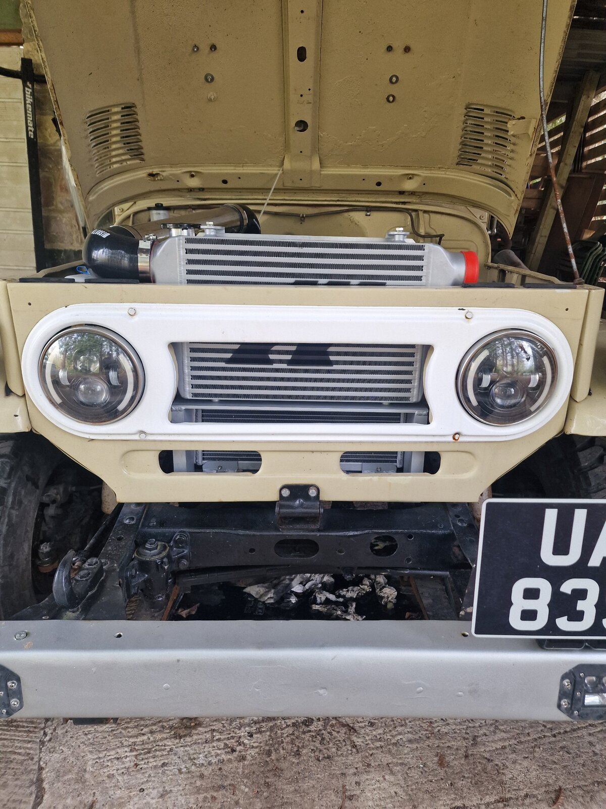

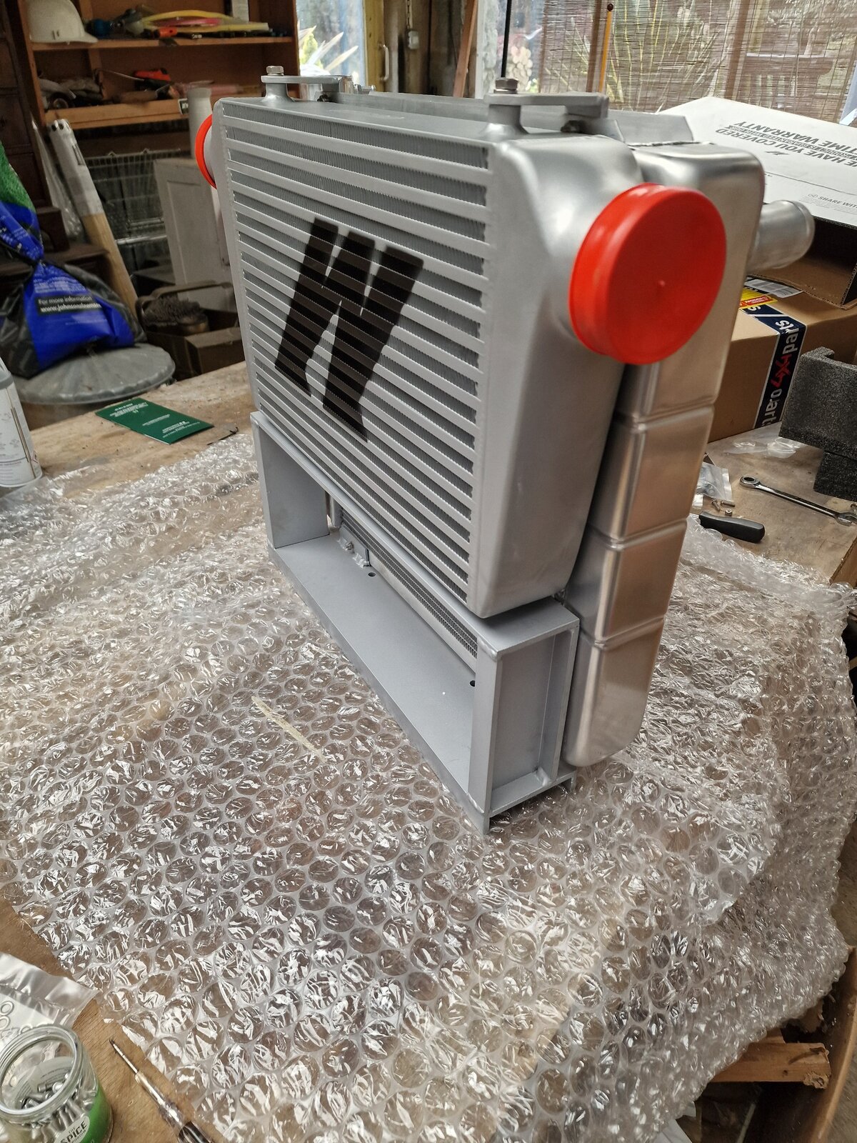

Little bit more progress today.
Old rad out, block and heater give a good flush through to clear and crappy water.
Great feature this fold down front grill assembly

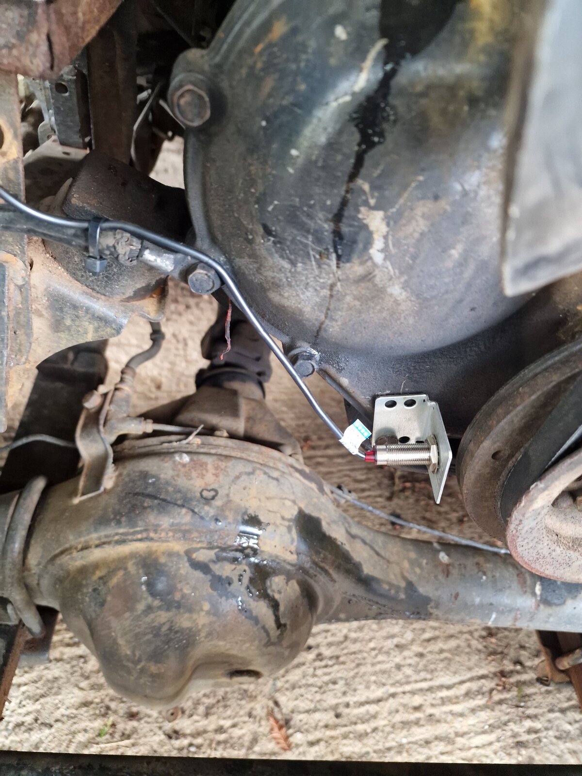

Whistle plenty of room, for the sake of £30 I've added a hall sensor rev counter.
Assembled new rad, intercooler and bracket from Legendary 4x4s.
Offered up for fit and just want to nudge their fixing holes over slightly, that way rad will sit dead centre on front grill. Ideally it would go a couple inches more as fan behind isn't sitting fully central on rad but bit of messing around with the cowl and it will fit, also any further over and bottom outlet from rad might foul engine timing chain cover.
I might have a look at the original rad to see if that would fit with intercooler and stack bracket and get a new toyota rad for perfect fit yet.
Hopefully I'll get a bit more time on Monday to meddle.

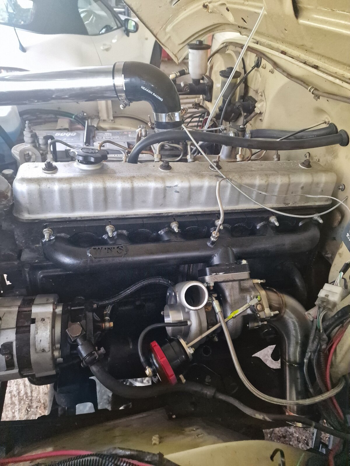

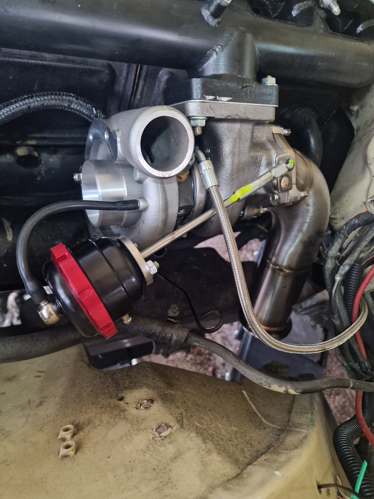

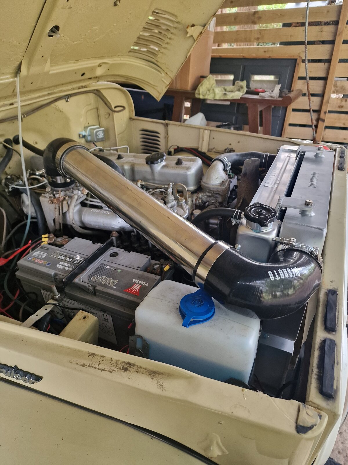

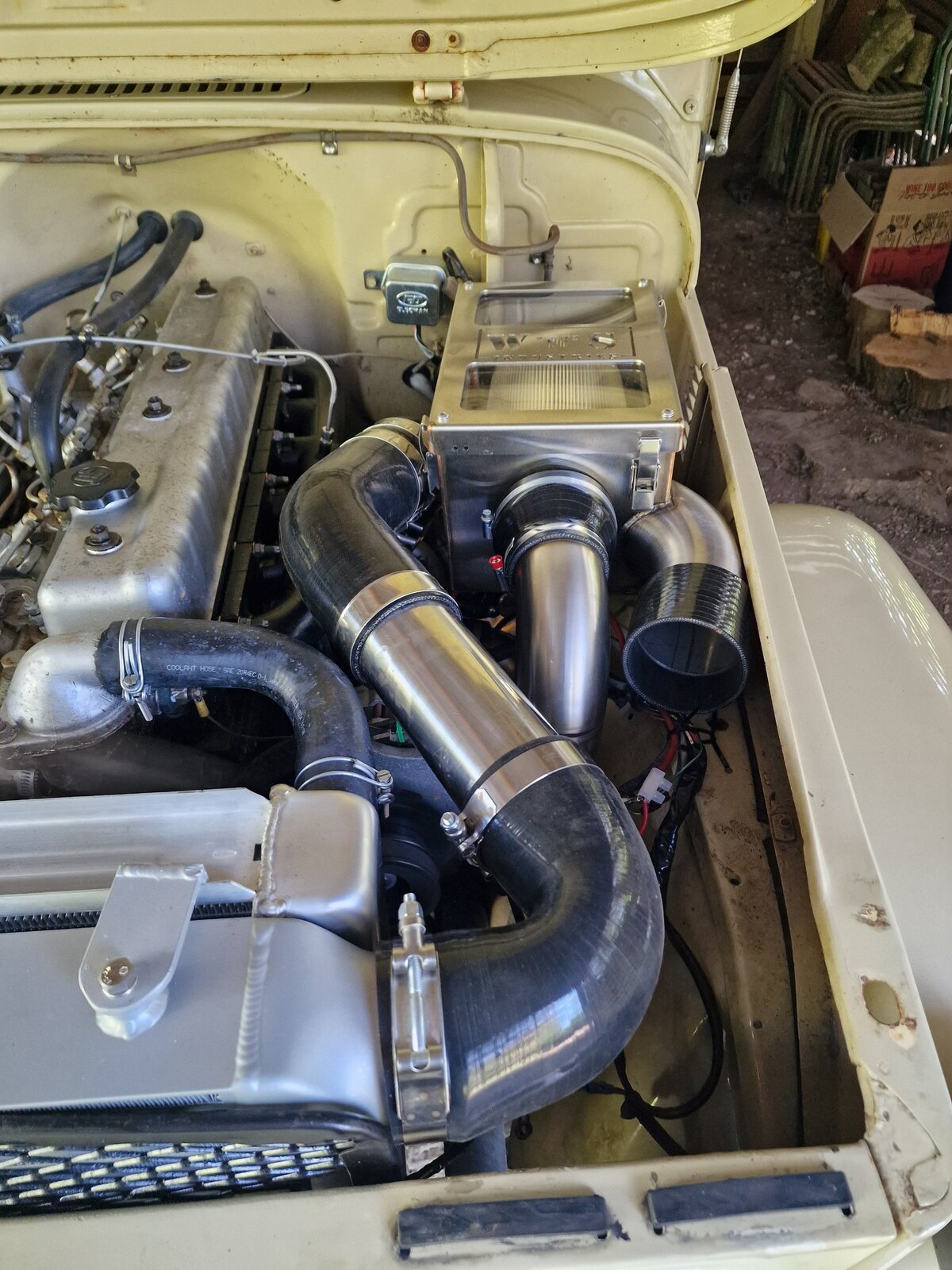

Making good progress here.
Rad and intercooler fitted.
EGT nut welded to manifold for on the spot readings!
Sump off, new oil pump fitted, turbo oil drain welded on.
Sump back on, letting rtv set before torque up and refill.
Manifold on, turbo on, dump section of exhaust on.
Left to do is cab dump exhaust bits, air filter box and piping to turbo and from this to intercooler.
