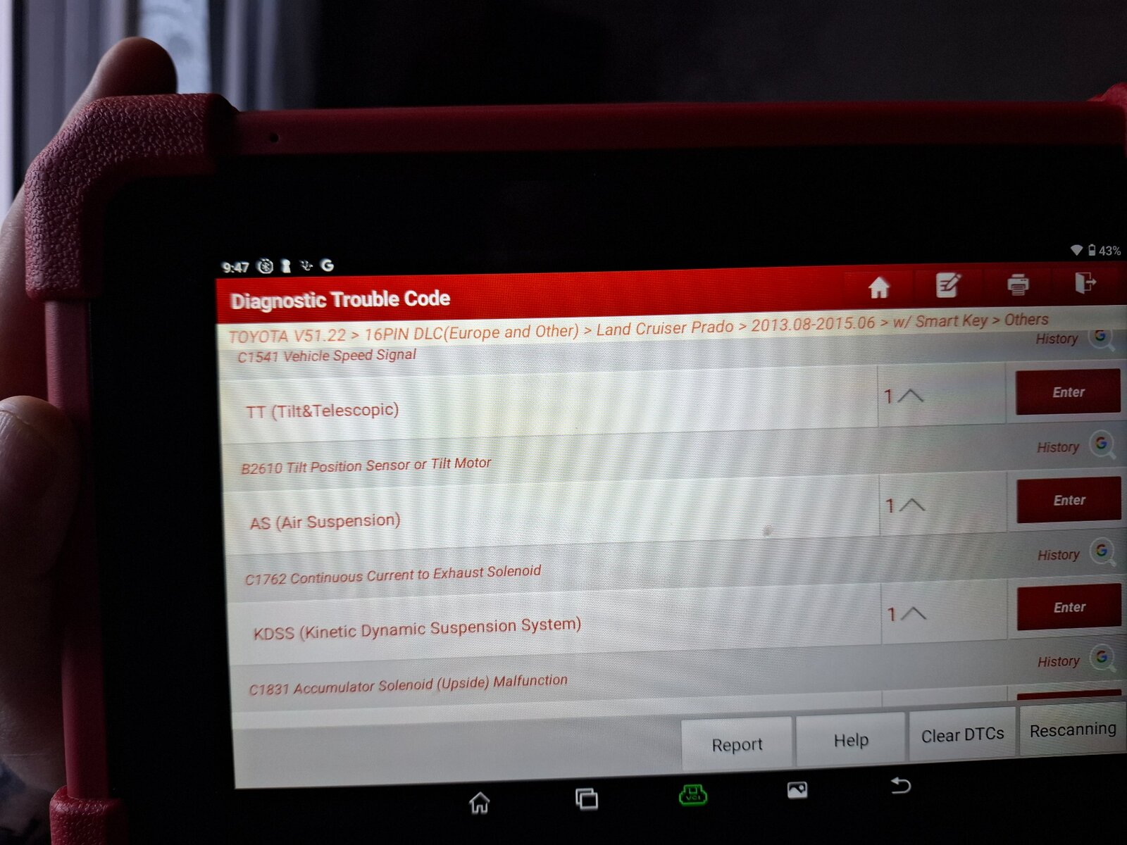

Not sure what this code relates to but after a scan came up with c1831.
I no its the suspension system on the invincible model but what is the actual fault.
Reading some posts on the net saying it's water ingress in the hydraulic pump.
Most of them quotes relate to a toyota bulletin.
My scan says it's a c1831( accumulator solenoid (upside) malfunction).
No idea what that means hence why I'm on here asking you guys.
