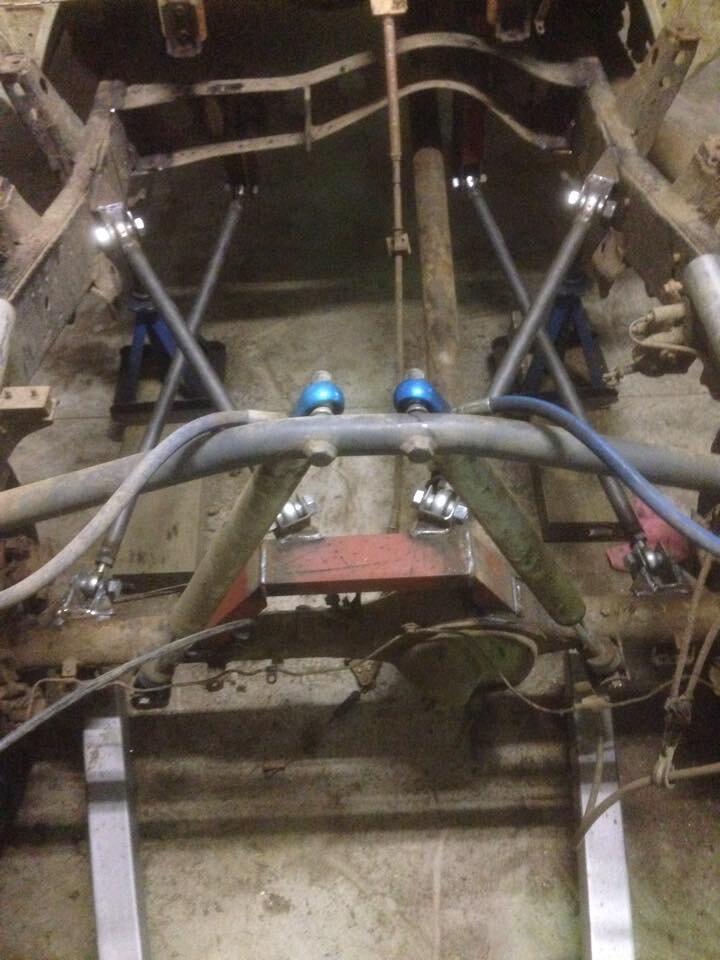

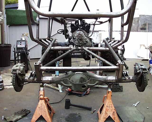

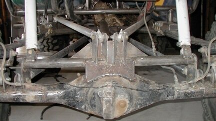

The prop shaft has a long floating section where it goes into the transfercase with splines.
I'm actually thinking of fitting a double cardon prop though to help with the extreme angle of the shaft.
Obviously its not going to be able to have quite as much articulation as in the pics above as the tyres hit the chassis. The length of shocks and a combination of longer bump stops and/or limiting straps might have to be fitted.
I think it will flex a little differently though once the weight of the cage, fuel cell, seats, center winch, etc. go on.
Having never done something like this before, it is very experimental for me and I really dont know how well it will work.
