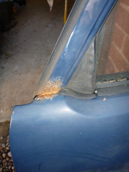

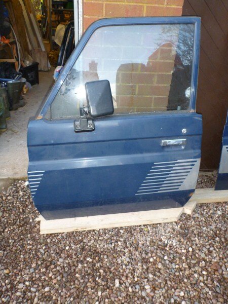

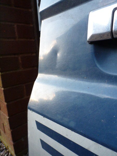

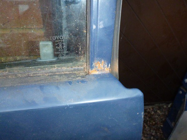

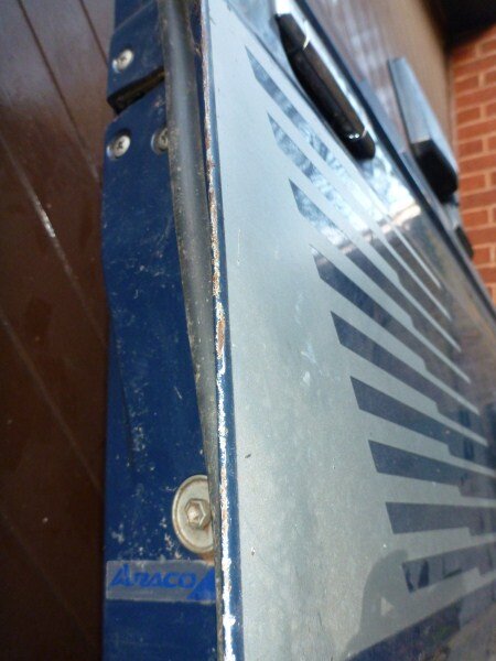

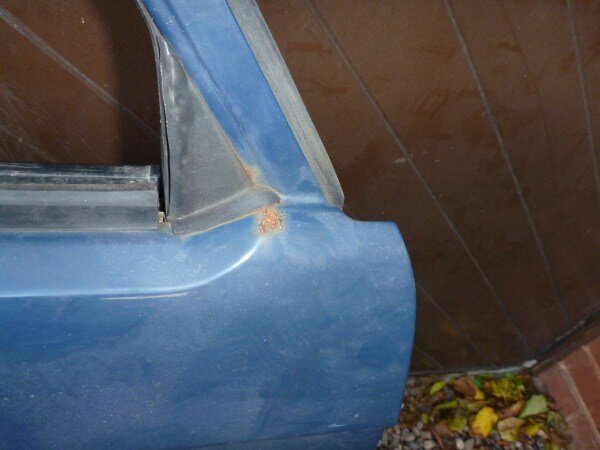

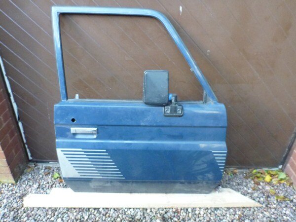

Replacement doors.
There a bit rusty, but there not bent and there the right colour.

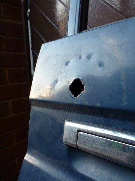

Looks like this door has been broken into.
