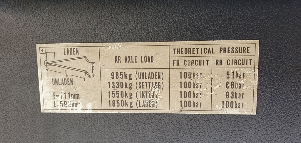

On mine, theres a sticker on the rear upper tailgate with the dimensions at varying body to axle height...
I think i have a photo somewhere if yours is missing or scrubbed off.
Let me have a look and get back to you.
Thanks. I just had a look at mine, nothing there. I have also found some videos on utube but it seems like trial and error setting it up correctly

Many thanks , I will have a look underneath tomorrow and set what it's set at.
Hi, I have just been underneath , the lsv is located inside left hand rear wheel area. I was going to spray the bolts with wd 40 to avoid breaking anything but, I can't for the life of me see where it can be adjusted. Any ideas or instructions from a workshop manual please.
