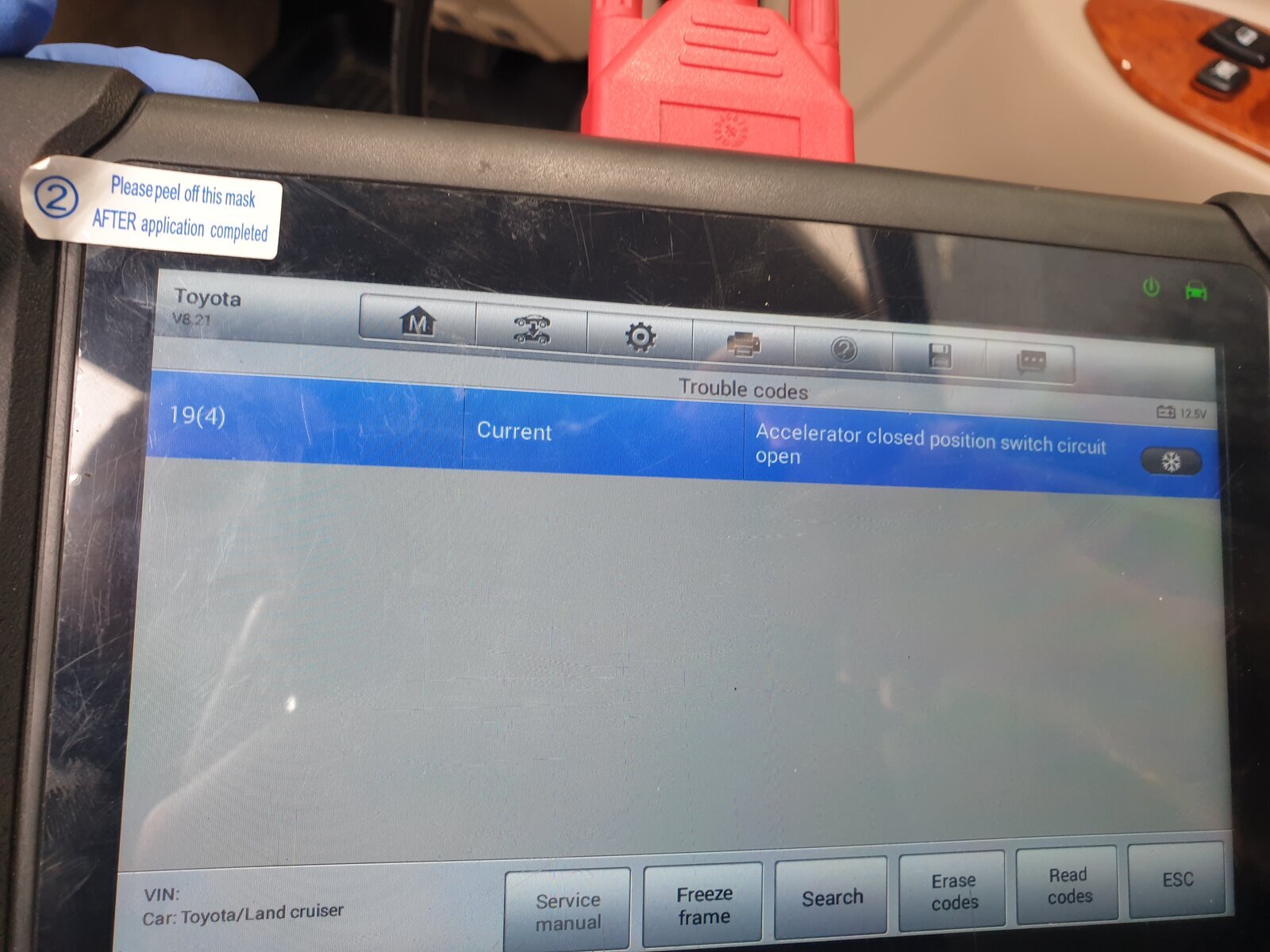

Hi all had my local.garage do a diagnostic which read
19 (4) Acelorator closed position switch circuit open
The garage were none the wiser so I've booked it into a 4x4 specialist in Glossop
Is this a job I could easily remedy myself ?
Cheers all
Open circuit - have you checked all the fuses? Else probably bad connection or broken wire
Any chance you could send me picture of where the connectors are please
Sorry mate i can't - dont have a 100, just a generic suggestion on where I'd start!
Iirc, that would be the idle switch on the accelerator pedal. There's a little switch attached to the pedal assembly which can fail. I had that, and just fixed the switch itself. Can't remember if I replaced or repaired, but only the little switch was defective, telling the ECU that the pedal was at idle position even when it wasn't.
Is it possible just to buy the sensor from somewhere on its own as Toyota will only sell it as a complete unit...a bit steep
Amayama have got it too about £300 with postage. Not sure what the duty situation is, but I don't think I paid any last time I had parts from japan
