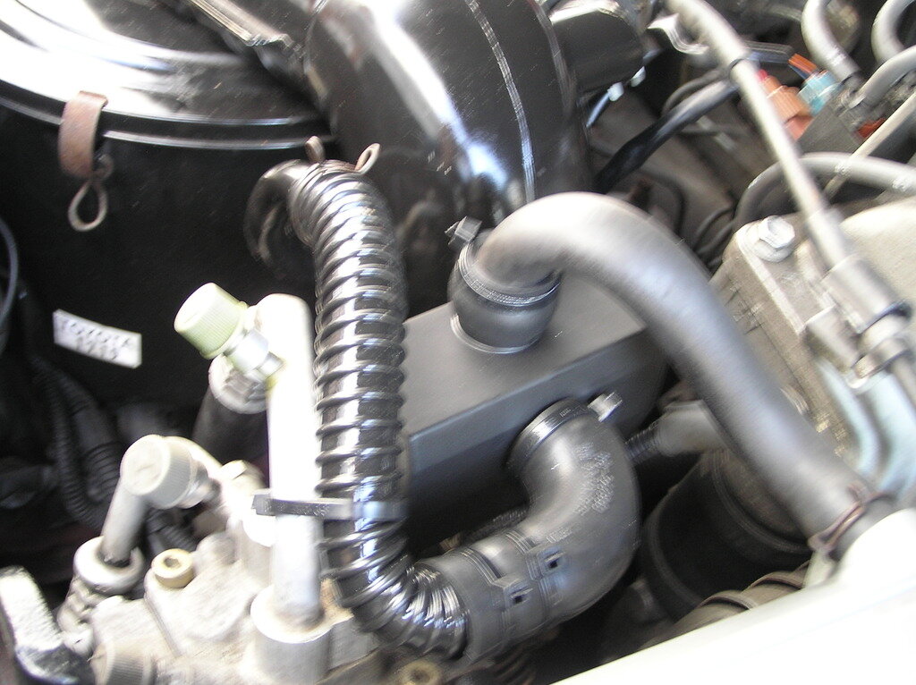

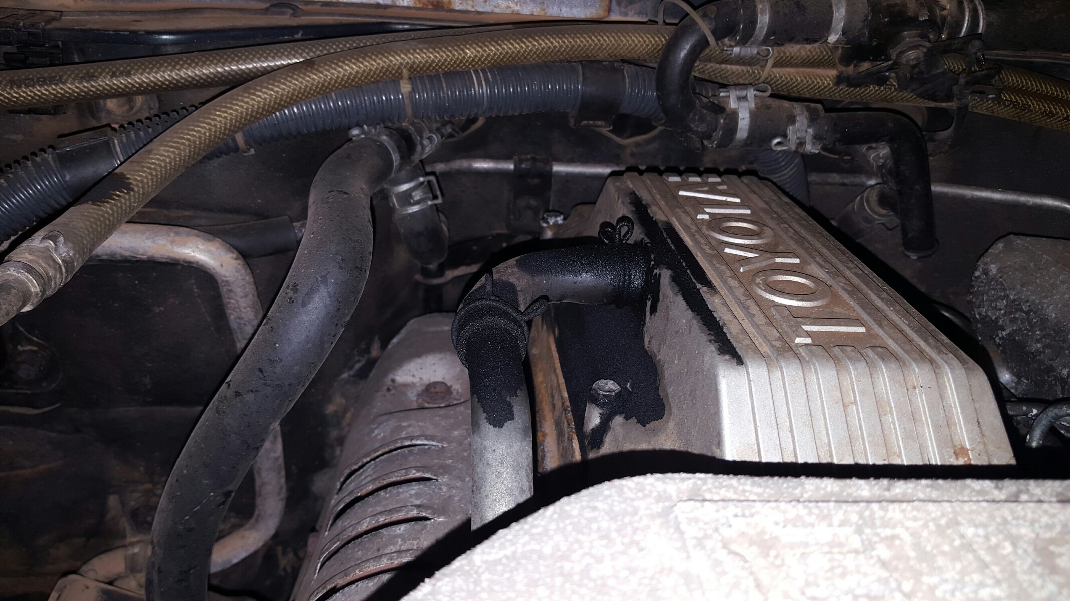

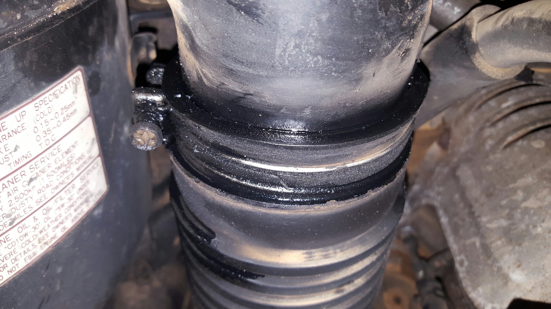

Oil coming into air filter
At the time to return home we changed the air filter which you can imagine was quite dirty after following other cars in the desert. We also noticed that oil around the joins. How bad is this? What could it be?
