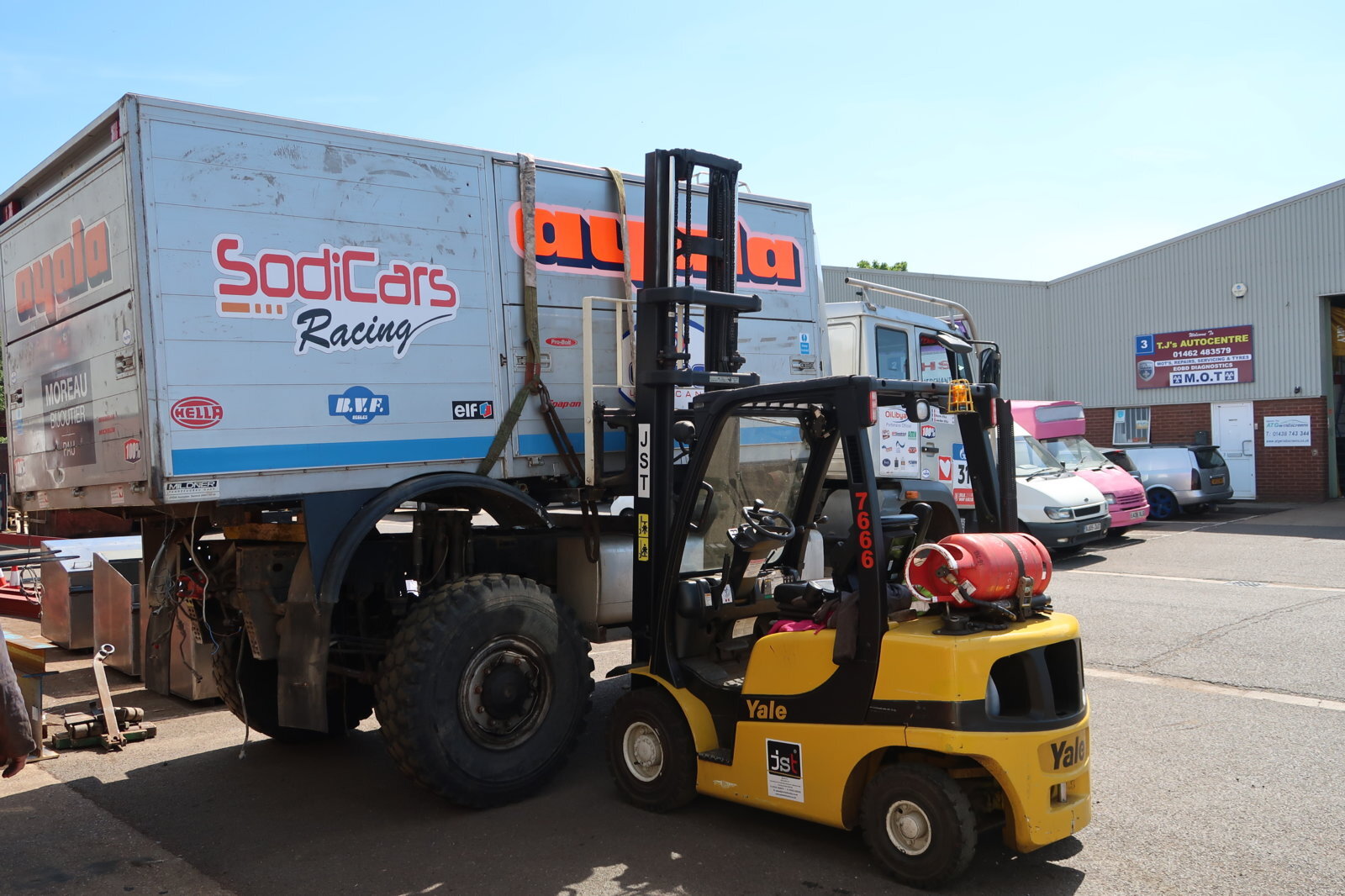

I have access to a welding and steel fabricating company, so was able to use their facilities and manpower to start the removal of the rear box. Over the last few months, I removed and disconnected all the ancillaries that were associated with the box, so expected this would be a pretty quick and painless job.
Well it turned out to be much more work than loosening a few bolts and lifting the box off.
Having several pairs of eyes looking at the problem, it was obvious that much of the truck was built with the box as a supporting structure, from the side pods, to the additional air tanks, with brackets and bolts in inaccessible places.
The huge fuel tanks were obviously added after the box was mated to the chassis, so the bolts that held the frame to the chassis were virtually impossible to get to. The entire rear bumper and Rockinger hitch were also welded to the body, as were the rear mudguards, the air tanks, brake air dryers, the engine expansion tank etc etc.
So what I'd hoped was going to be a mornings work, took 5 guys 10 hours to complete.

After several attempts at using the hoist, we realised it just wasn't going to work.
Plan B.. Chock the daylight with beams and drive truck out of the lifting bay. Use two, 2-ton fork lifts to raise the body off the chassis high enough so I can drive away.
The end result !!

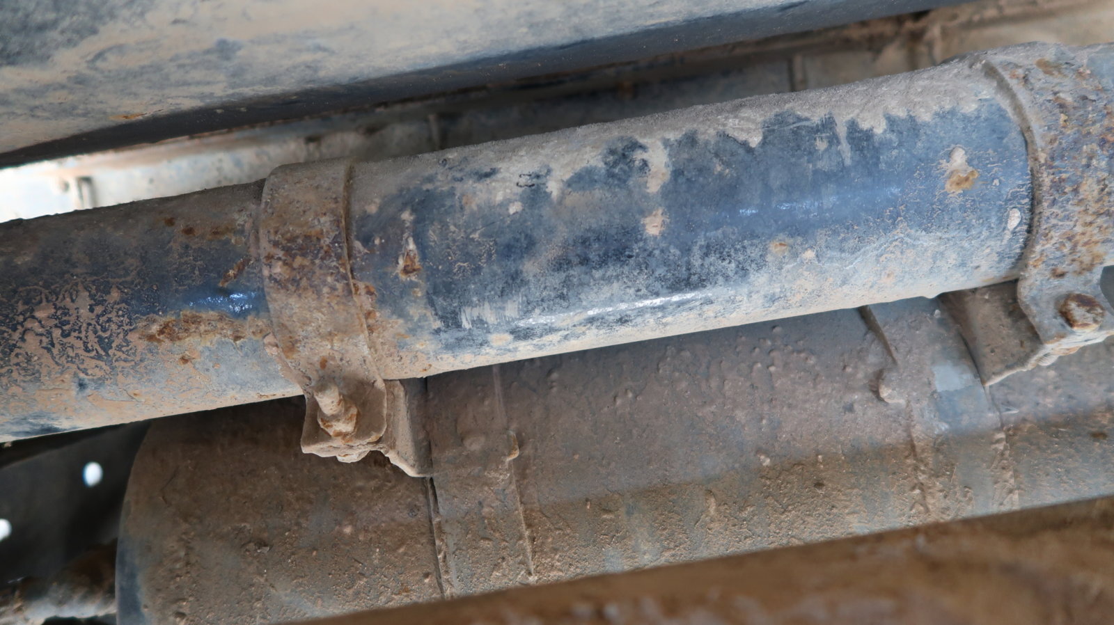

The amount of desert sand and filth that was trapped under the box was amazing. you can see the state of the chassis from the pics below. You will also note the air tanks have been moved from their traditional position under the chassis to much higher up between the chassis rails.
The next phase is a wash and clean, before the truck goes off to have the chassis and body prepped and painted.

First proper wash complete. 99% of the Sahara and Gobi deserts have been washed away.
I don't think I need worry about running out of fuel !!
I jury rigged the air filter and intake that was housed in the rear box, whilst I have a new improved version made.
