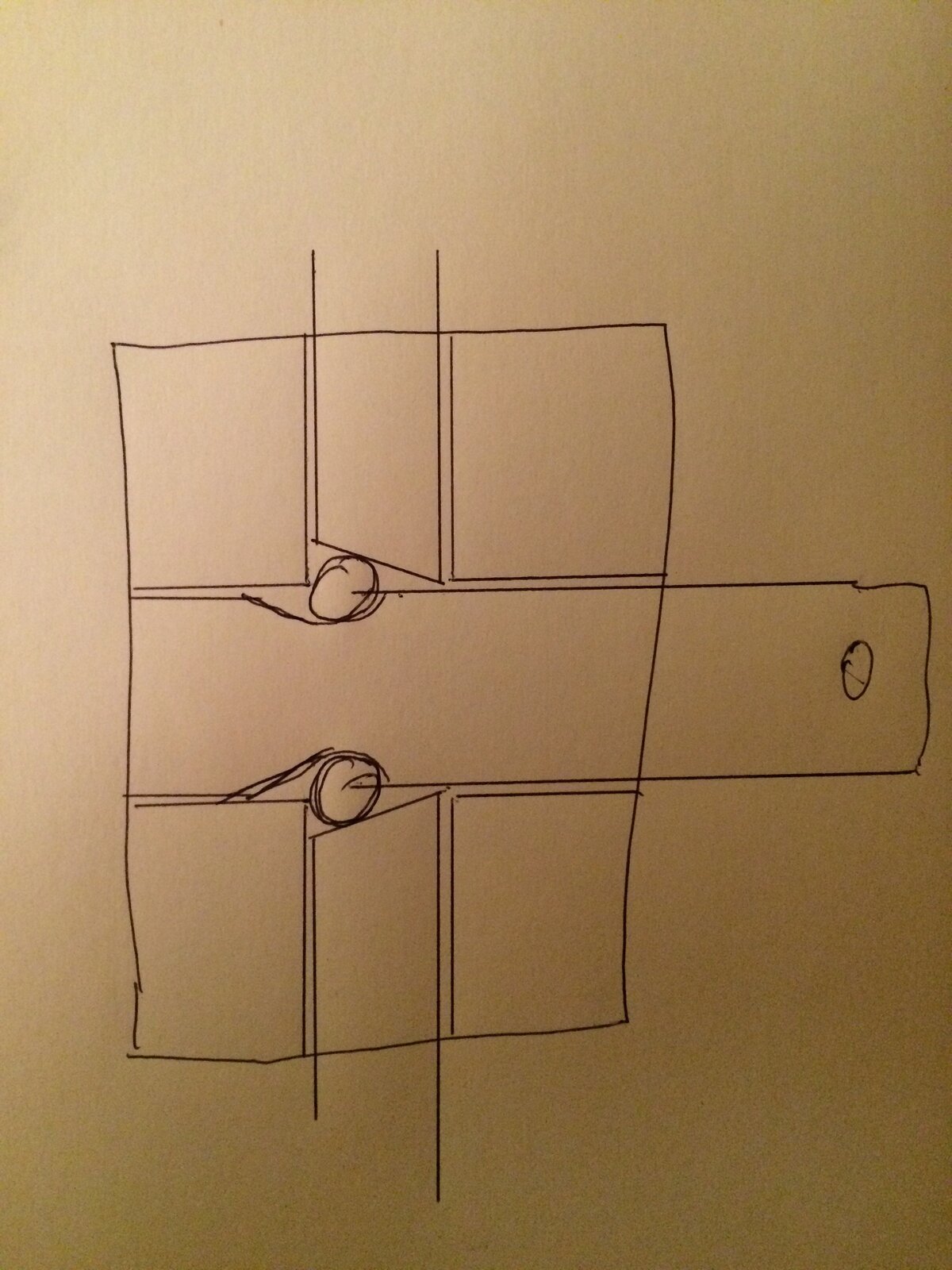

Rapier Trailer sticky brakes and cylinder hard to remove is caused by the handbrake mechanism . A very simple device that does not need greasing because its stainless steel and grease will only catch brake dust jamming the slider which is likely why so many of these trailers have a broken handbrake lever .
In the pic below remove both rollers and sliders , fit the shoes and replace roller/sliders if they wont fit the slider is too long so just trim it with a grinder .
Just for info the two sliders are in the wrong way round!
With the plunger pushed in the rollers should be over the other side and the sliders need flipping over.
Like this, so when the brake is pulled the rollers ride up the ramps. Lol
:lol: possibly the pic was an after thought as it explains better than words so i just chucked them back in to get it . I haven't fixed the lever as i'm probably going to change it for the ratchet kind so it locks on if you yank on a breakaway cable . Wheel spins freely now though and pulling on the cable spreads the shoes to lock on the drum so i must have put it all back together the right way :thumbup:
