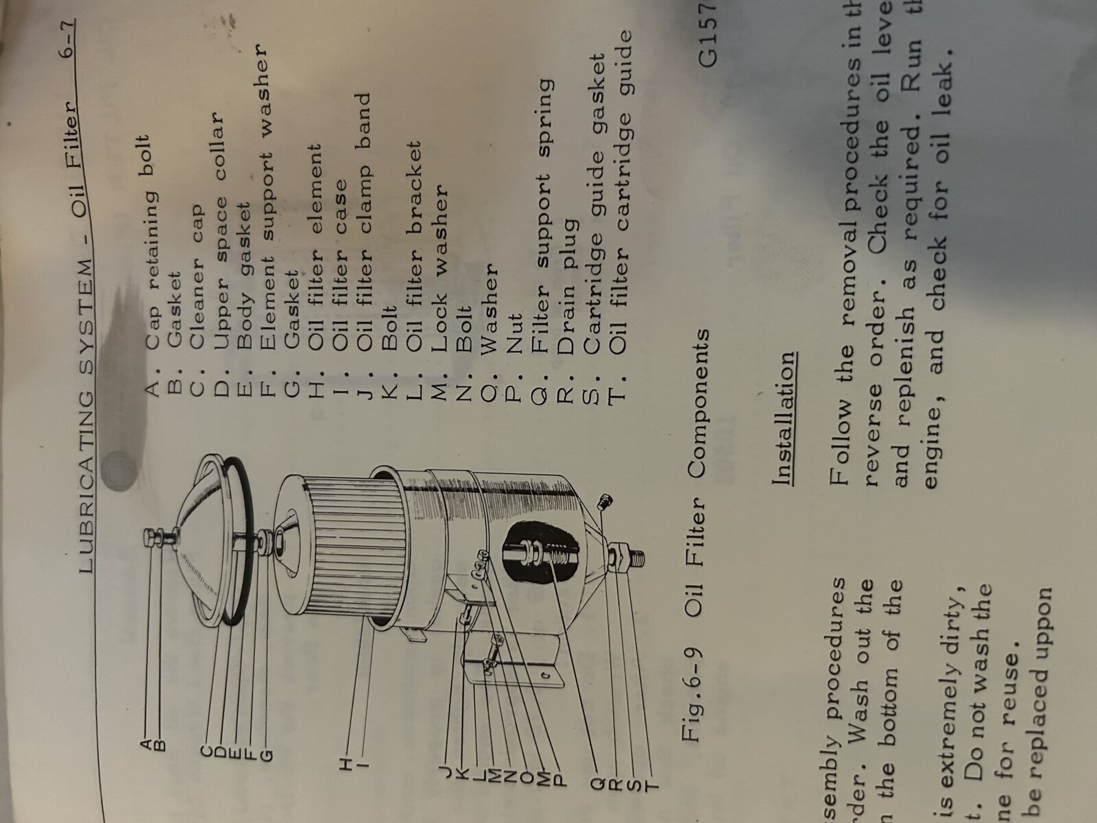

I have a 1966 FJ45 with the f135 engine. The oil filter is missing the "upper space collar" . Does anyone know where I could find one...or if anyone could get me the physical dimensions ( ID,OD and length) I'm pretty sure I could make one. That would be great.

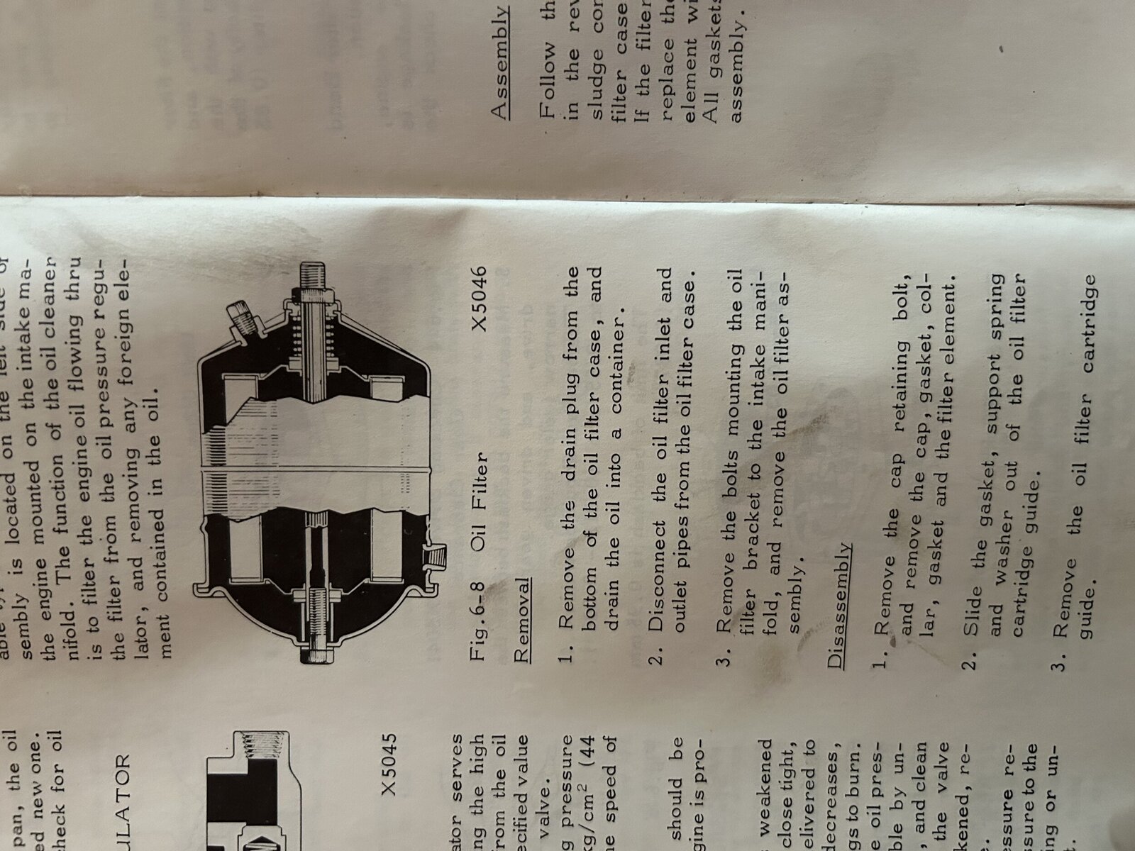

I have a feeling that I will have to make one. If anyone has the dimensions (ID, OD and length) That would be great. The part is inside oil filter case. Part "D" on image 5435. Thanks for any help I can get.
