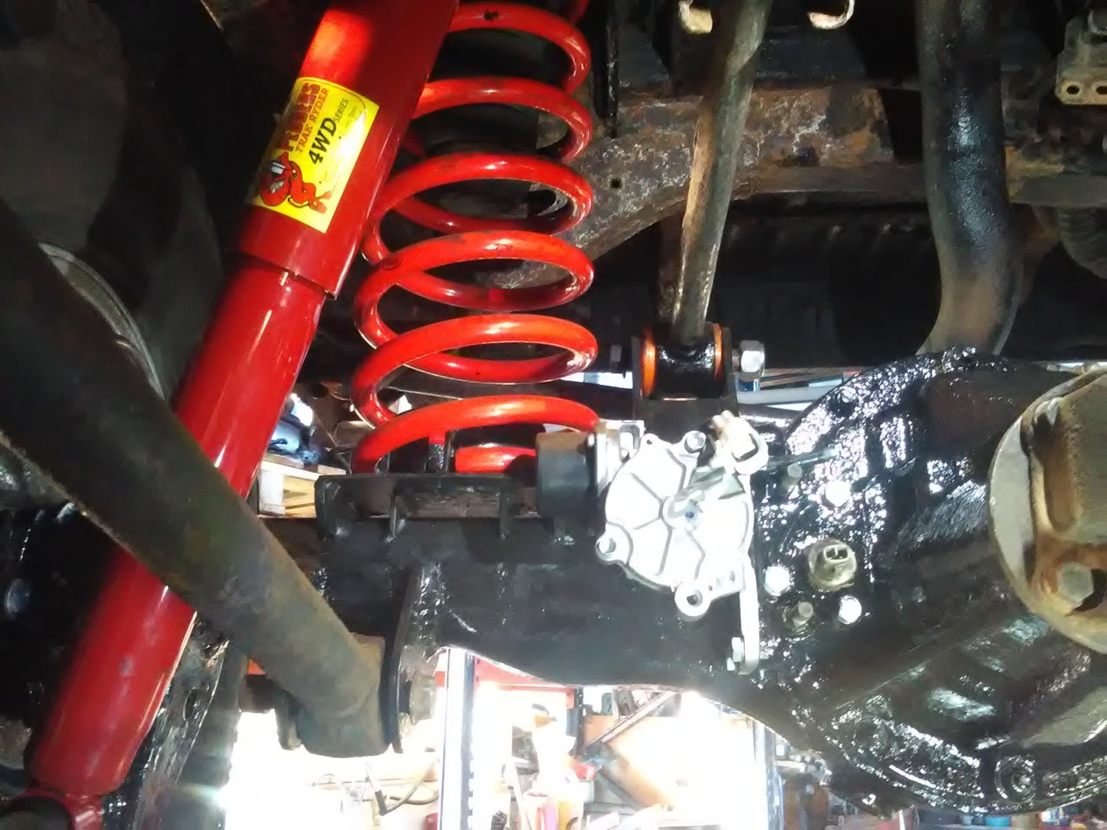

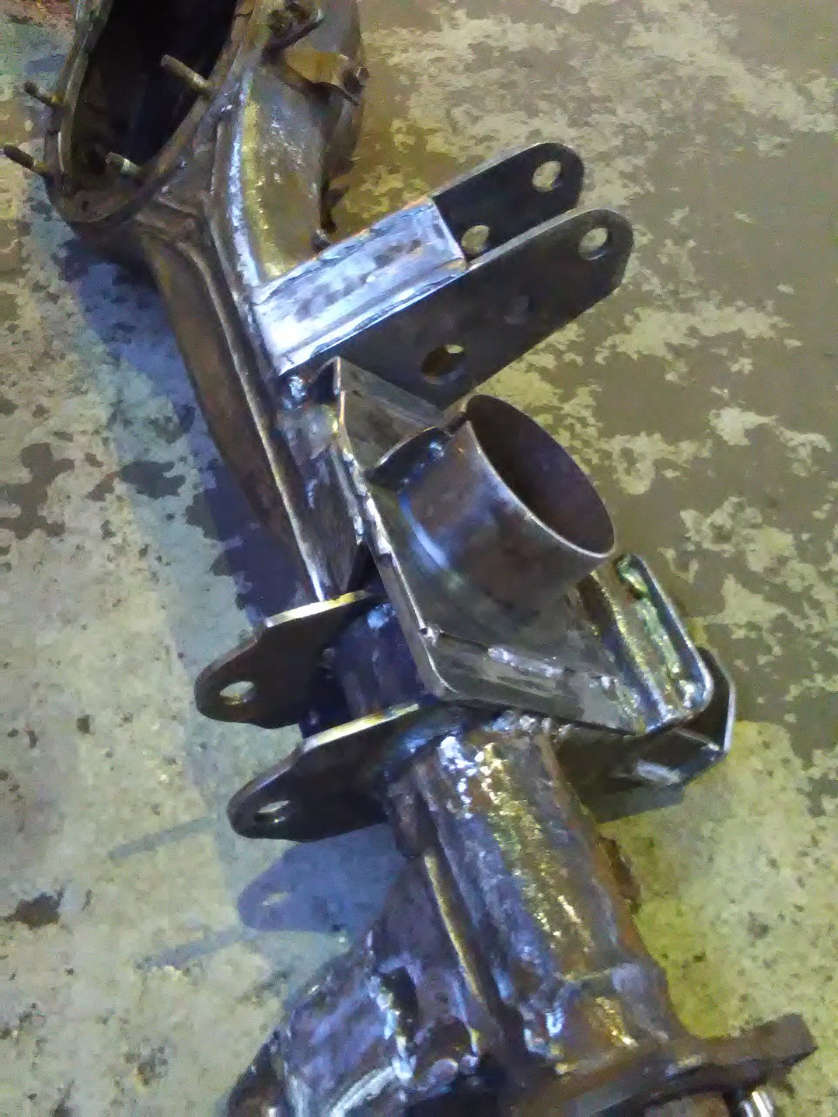

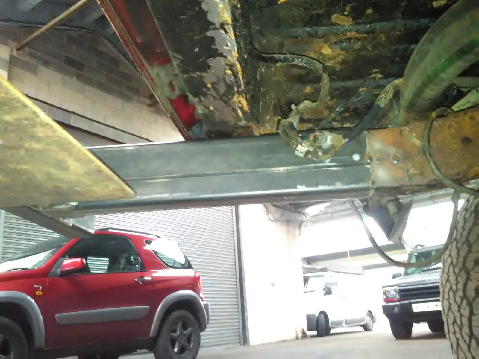

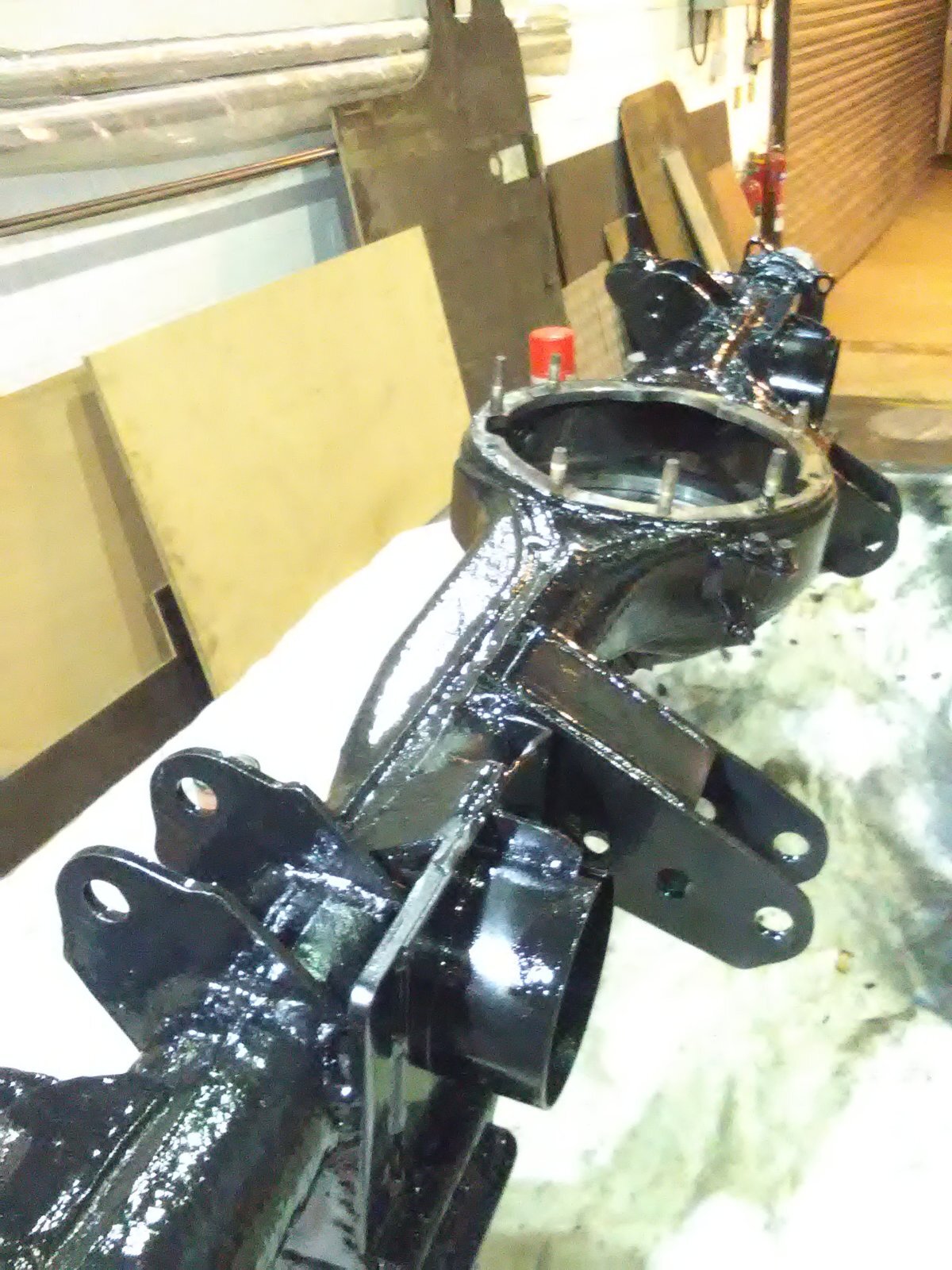

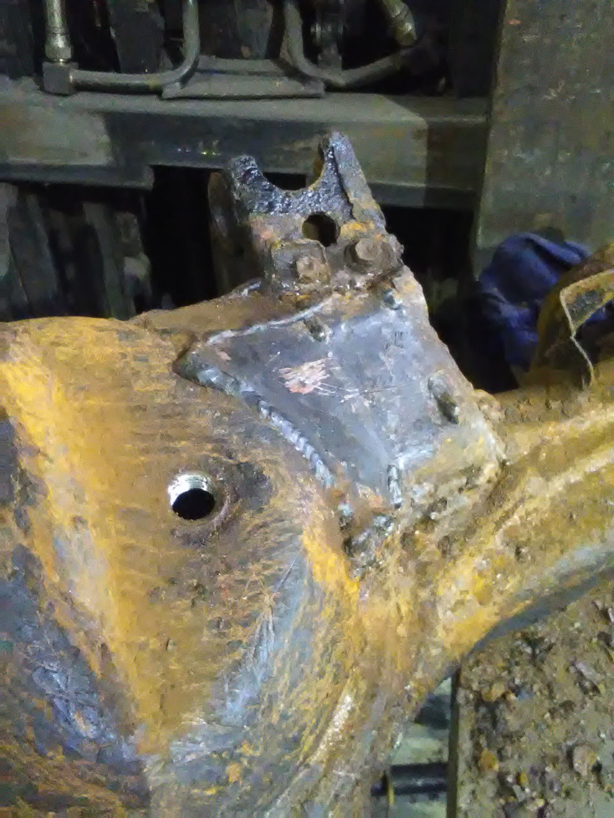

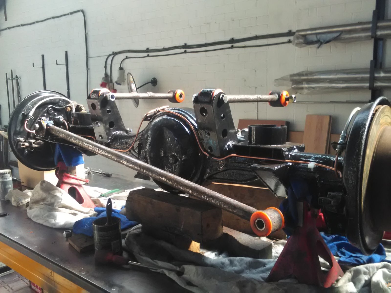

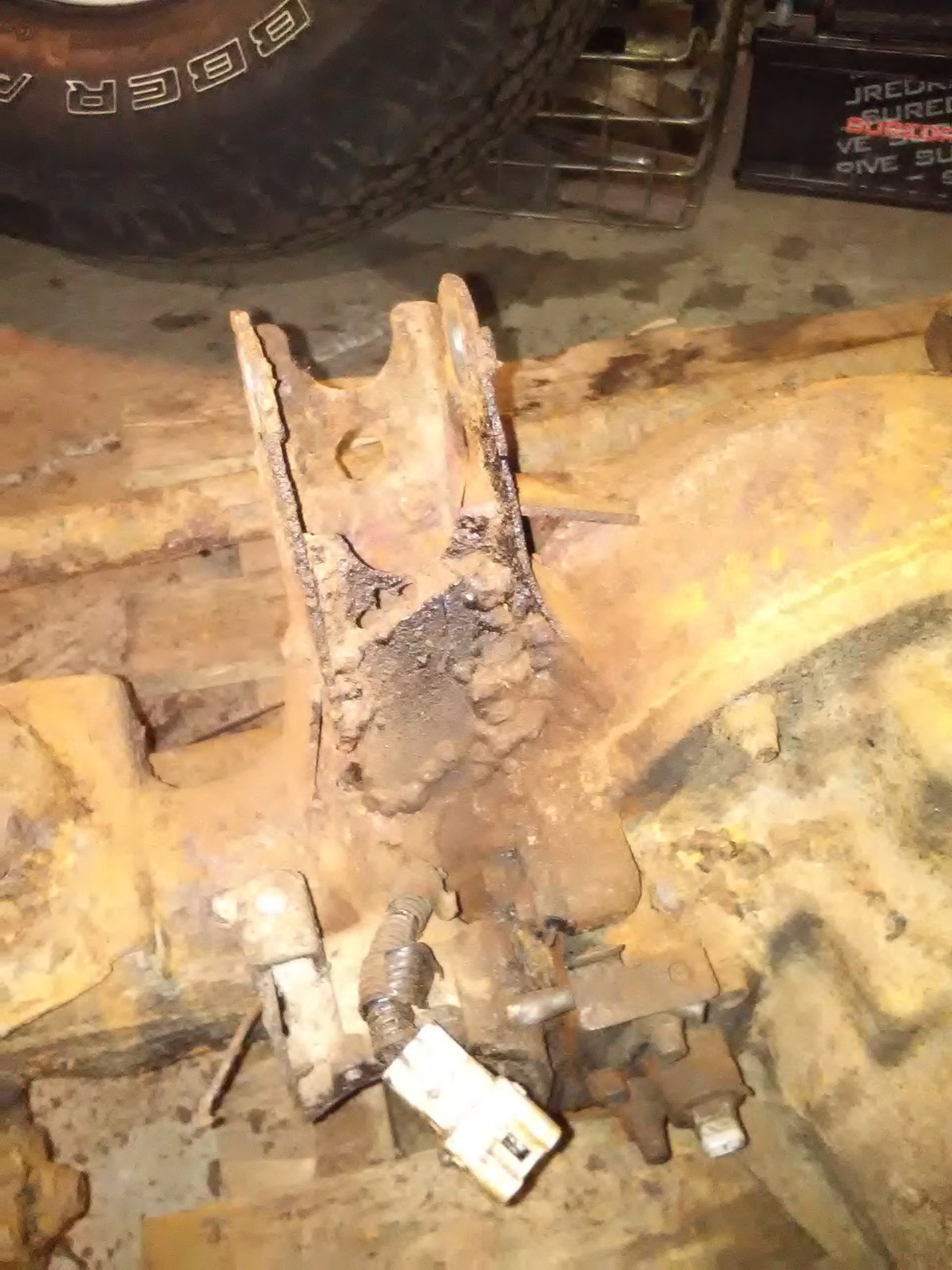

Hi all. I bought an 80 series about 6 months ago to build in to a bit of an off roader and over lander,stumbled upon exactly what I was after - a manual with cloth seats and triple diff locks and in the same city as me! I've now learnt to never buy the first thing you look at. The body work and interior isn't bad really. The only fault in the advert was "abs light on". No mention a good foot of the chassis at the back had to be cut off and re made, I've replaced the clutch as some moron had put the plate in the wrong way round causing the springs to hit the flywheel!. Stripped the rear axle,fabricated every single mount on it as none were structural. Had to bite the bullet and buy a diff lock (had the rewire the abs to get this to work and clear abs fault). Replaced the rear springs shockers with pedders items, 2 inch lift and the 60mm bore foam fill shockers. Next task is the front axle, radius arm mounts have been bodged and there's masses of play in the cvs. Will be fitting all suspension to the front too. The list goes on but I'm hoping she'll be ready for a trip to Spain in August I've got planned with my other half! I'll upload some pictures when i have a spare hour to boot the computer haha
