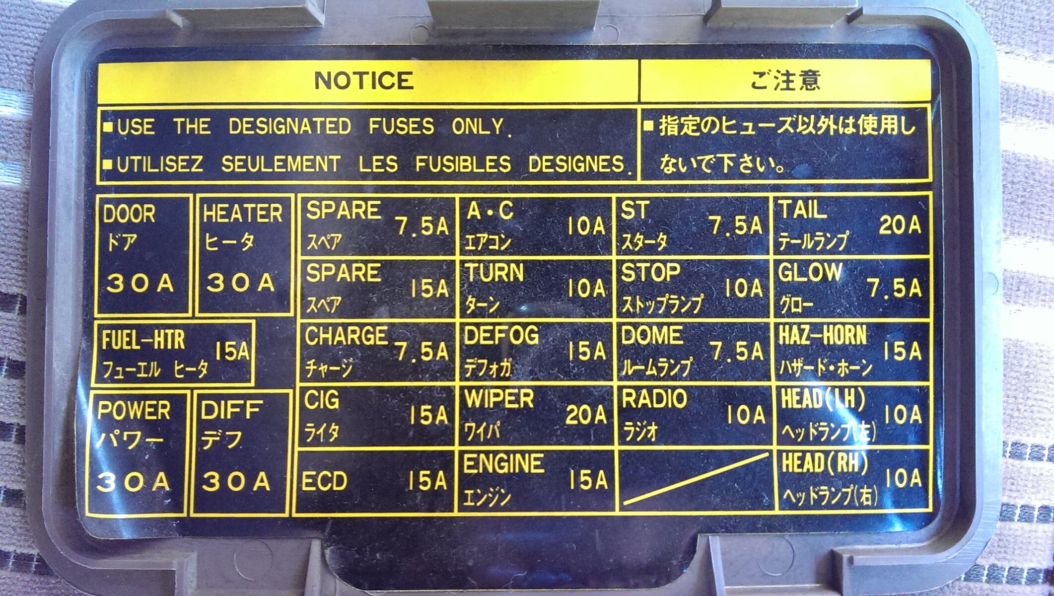

Hi
I have just acquired a 1992 Prado LJ78 2.4 diesel.
The cover has come off the fuse box and I have no idea which fuses do what.
Does anyone have a fuse layout they could send me.
I have searched all over the net and not found one yet
thanks in advance
steve
