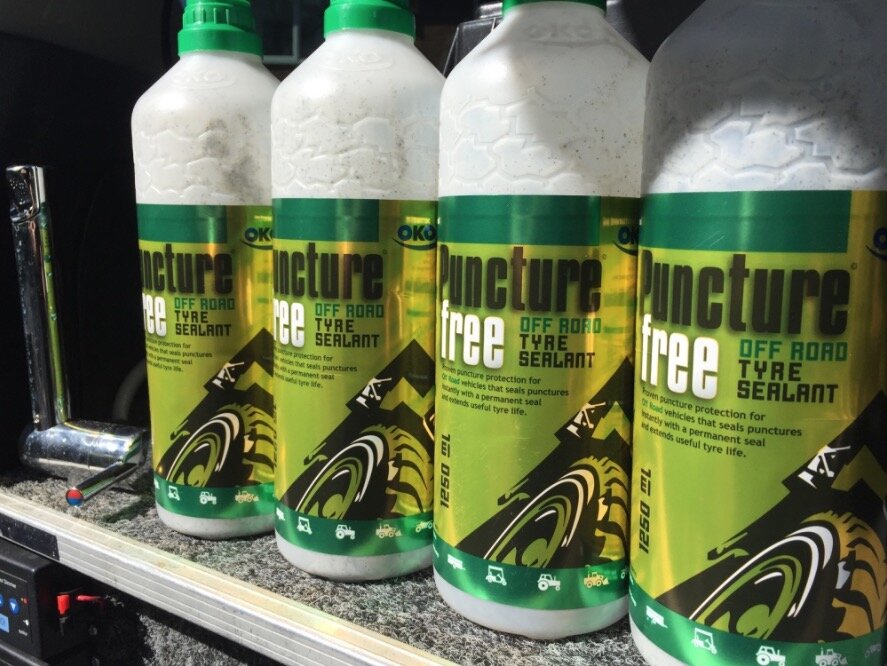

Started with 5 litres of goo in the tyres.

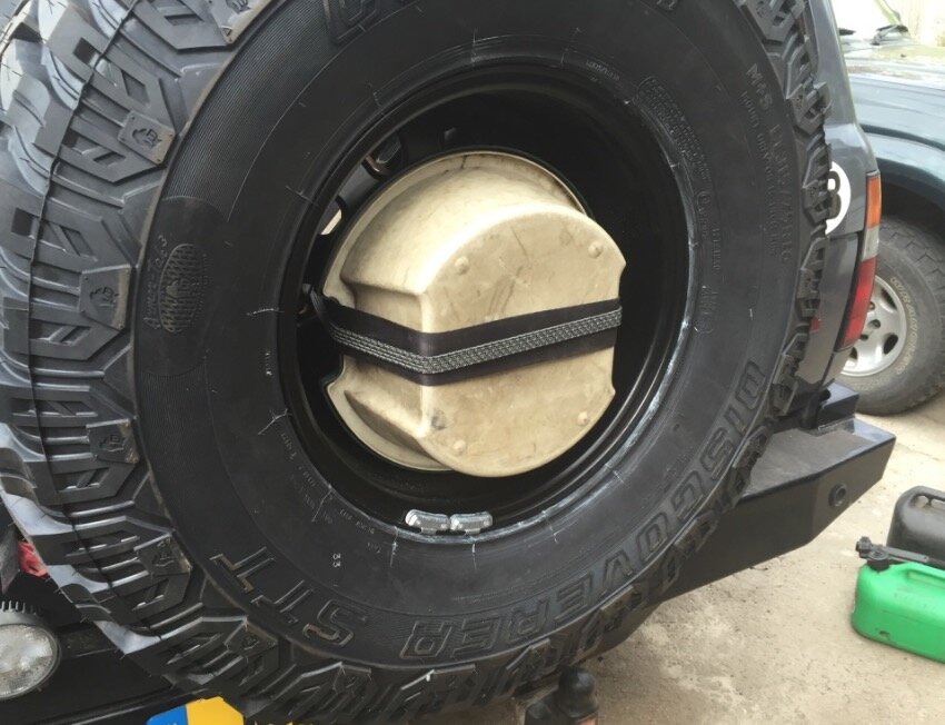

Reversed the spare and found that the washing up bowl fitted in there nicely. Great as long as some thieving scumbag doesn't nick it. It's fine here, but one we get out and about. I might need a big BBQ grille to go over it.

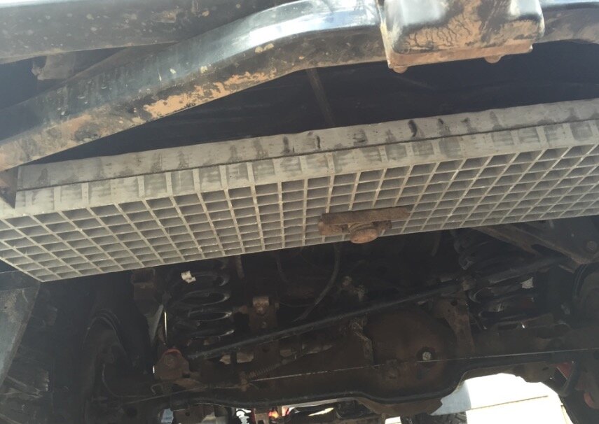

Then I did this to the wheel winder. I put it back when I installed the sub tank, just in case.
So it's now it's clip-able on and offable
So that I can put these up here. I am made up with this idea. I hate not having the waffles. They are so multi functional but do get in the way all of the time. Under here they are doing no harm.

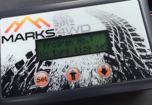

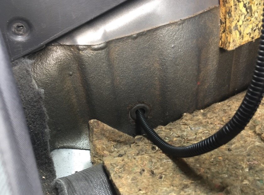

After a cuppa, I set to on the speedo adjustment gizzmo. Very easy to install. Pull back carpet, drill on hole, slice finger right through, put wires in, connect, ignition on dial in speed correction. Sorted! You can do it on the move. Set cruise and just dial in the speedo til it reads what you want against sat nav. I calibrated that against a modern car first. I wouldn't expect a GPS to be bang on, but across a range of cars it seemed very consistent.

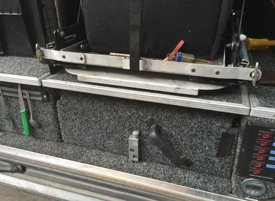

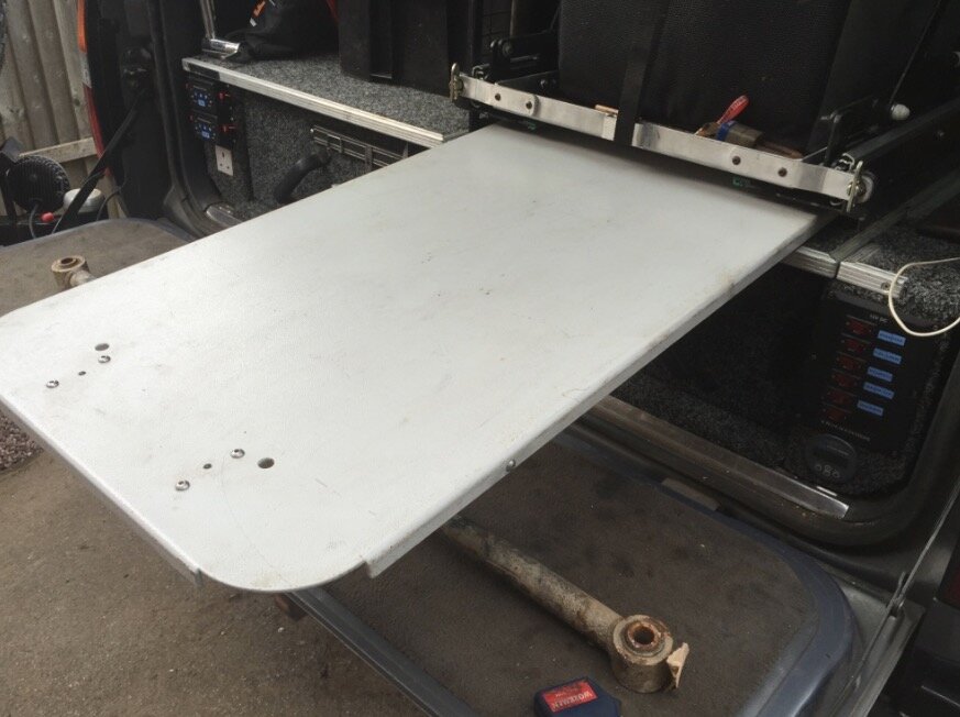

Then I decided I was missing out with all the pull out table action I was seeing in other builds. So I made some feet, raised the fridge slide and installed the table under there. It is a perfect fit. Very pleased with that and it gives me more room down the side for when we get the gull wings in.

Great idea with the waffles Chris, I think I'll have to look into putting my MaxTracs under there.
Great idea for the waffles. Knowing my luck I'd need them but be buried to the axles :lol: I keep them up top, waffles won't help me if they're buried then!!
Obviously that's just for storage, if there's any danger of being needed, off they come first. :icon-rolleyes:

Yes obviously if you look like you'll need them you get them out first. I have to say after years of off road stuff, I never drive into anything unprepared. I have the sand things on the roof, easy to get to. But the waffles have many uses.
Great to stand on when showering. Good as duck boards at the back of the tailgate when it's wet. Handy to level the vehicle. Good to put under the High Lift. Useful to make ramps from if you need to work under the truck. And all of that is before you actually get stuck and need them to get yourself out. I have some 50mm ones better suited maybe to such a heavy vehicle but these 30's are just fine I think.

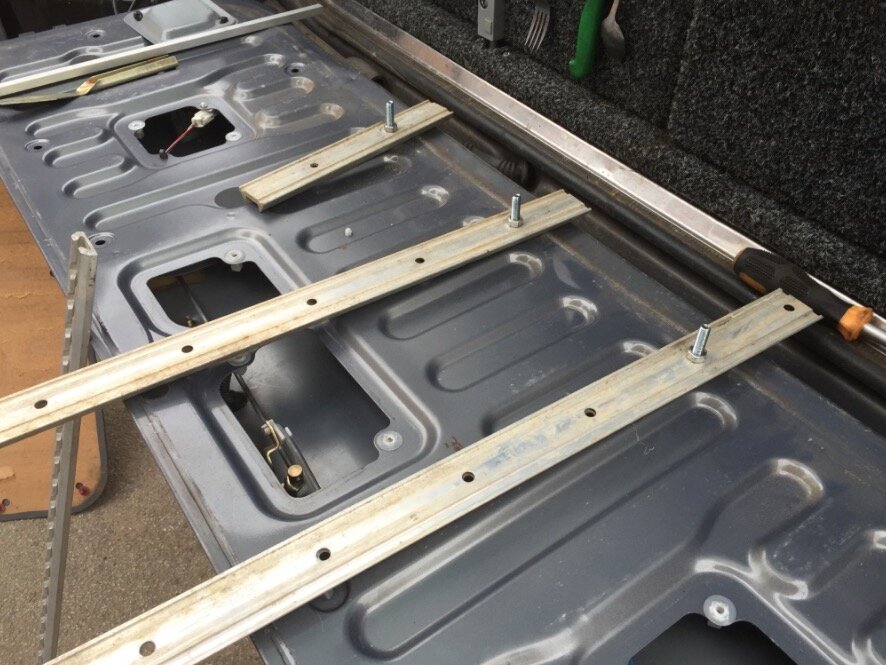

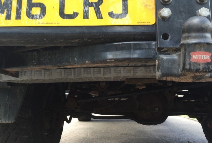

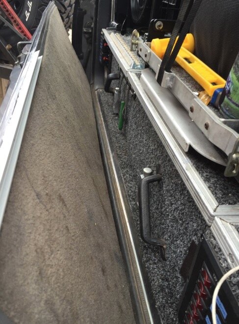

Not so much done today. Been bitting and bobbing. First job was to have a look at the tailgate. Hadn't realised just how big the gap was between the carpet and rubber seal. You could see the ground when the tailgate was shut! So, I put some 8mm bolts up through the panel, used some cargo rail and basically pulled it flush. It's weakened of course so standing on it will soon undo that effort. I could put some blocks inside, but the plan is to put a deck on there I guess.
See, it's pretty flat again.
The double bonus is that it's made a massive difference in noise levels when driving. I couldn't believe it.
